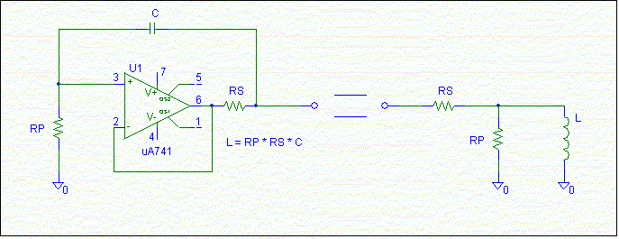

I've read a few places that there are 3 ways of making a gyrator circuit, but only very little of technical kind, like detailed circuit description and equations.
Anyone got any links or literature, where I can learn more, and satisfy my theoretical couriousity?

Da5id4Vz:
I'm shure it's being used in oscillators, since it's another way of making an inductor.
Here we are (soory for the 741 but it was the one that was handy, I would of course use another one):
