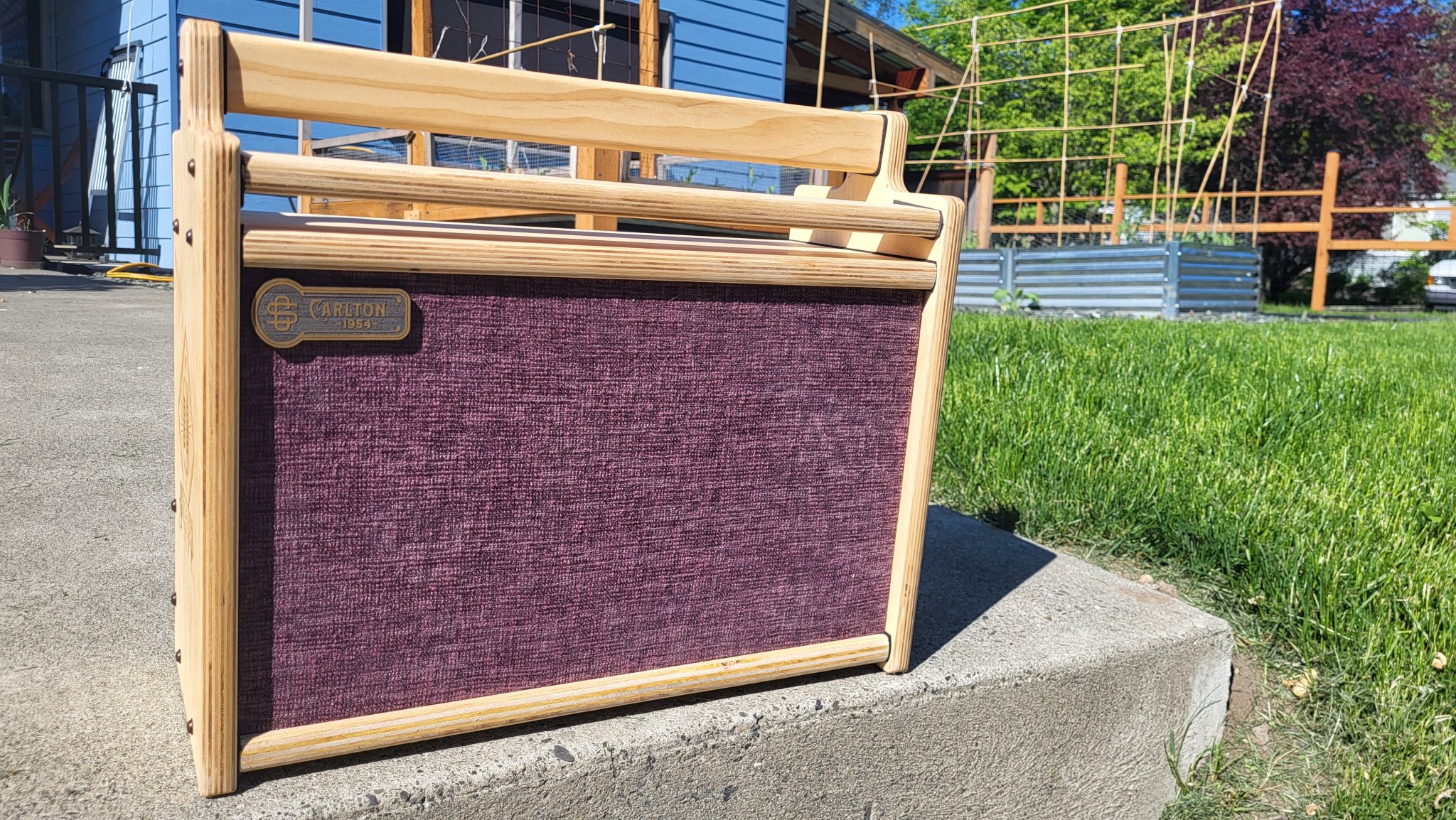

Guitar/Streaming amp using Betsy.
My latest project, a simple mono- amp and loudspeaker for a guitar or just streaming.

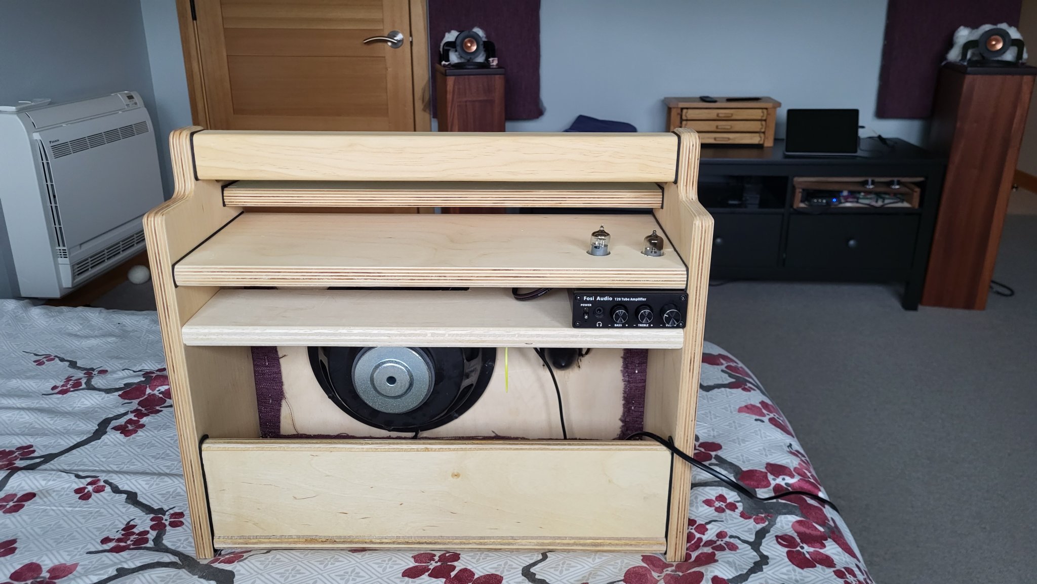

Betsy driver with a 1 inch dome tweeter.

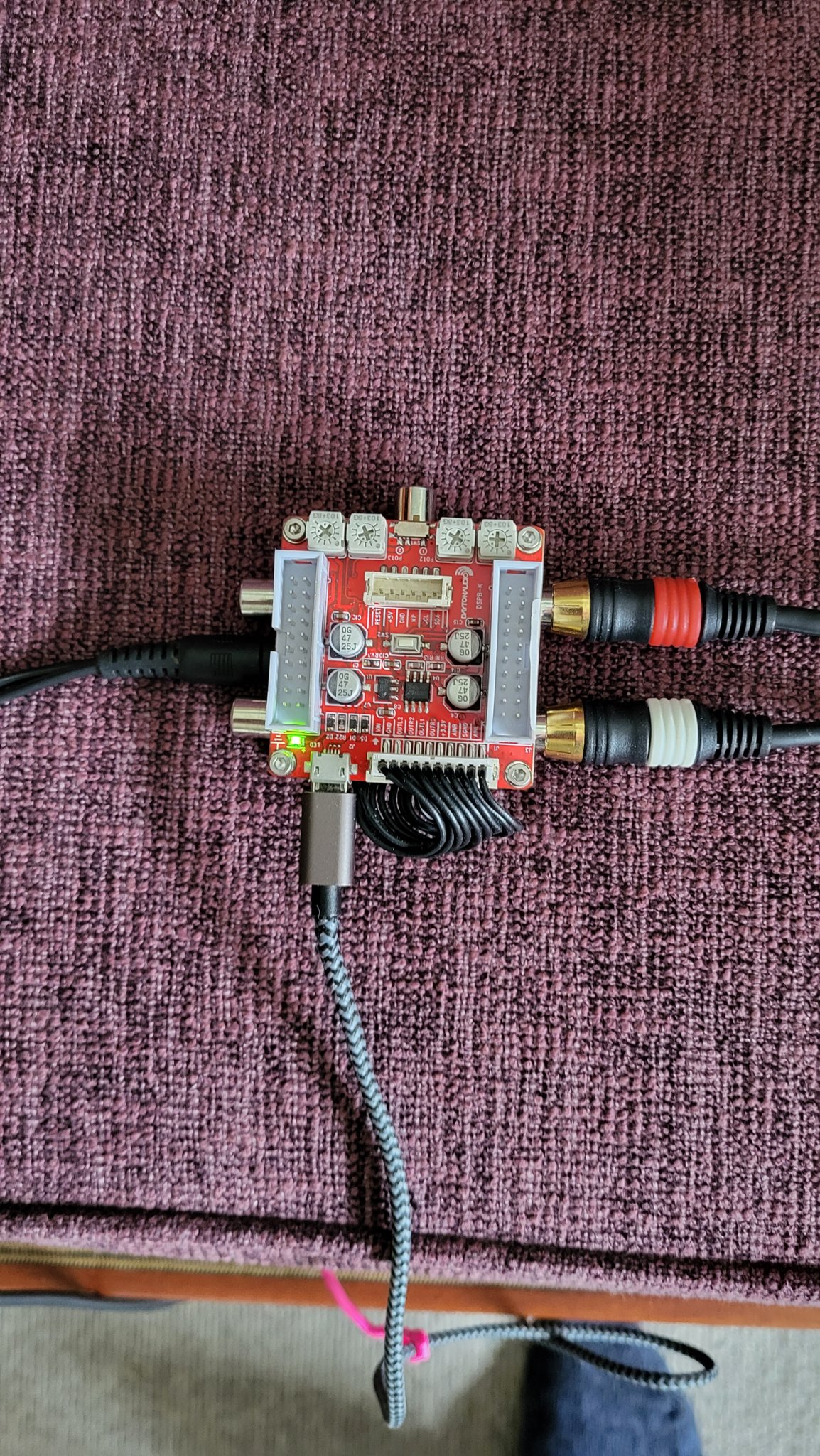

ADU1701 DSP from Parts Express
Open box/Infinite baffle design.

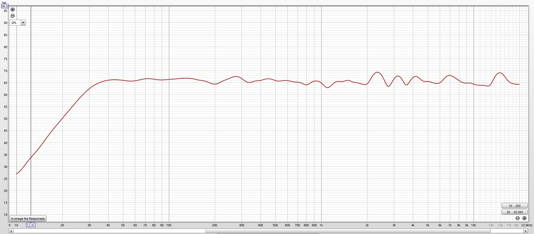

Equalized in room using Sigma studio auto equalization.
DSP crossovers at 5,000 Hz.
Fosi Vacuum Tube/Class D amp. One per driver.
Simply beautiful sound. Clean and detail with no booming despite a 30 Hz low end response.
