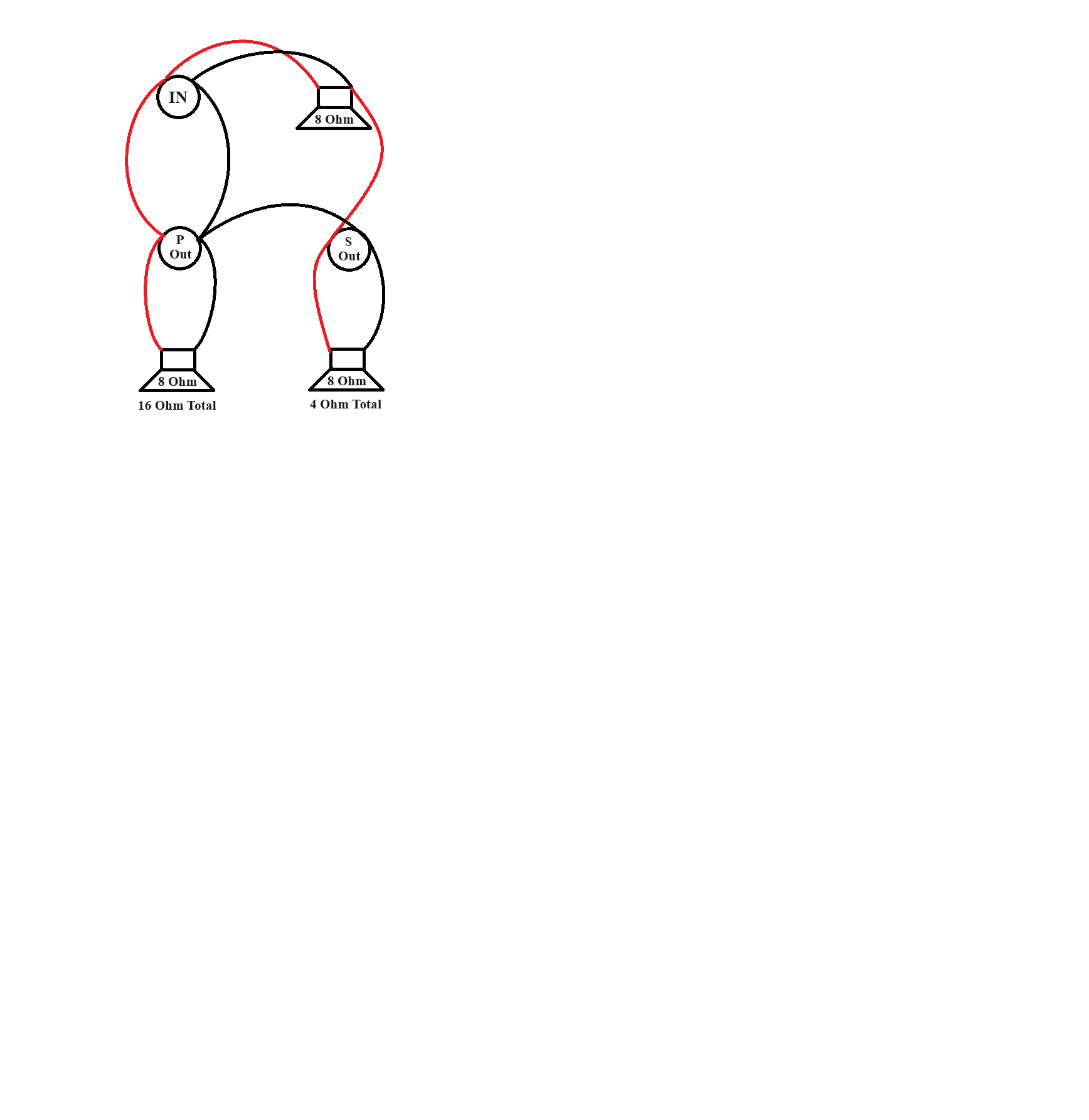

I have two single extension cabs with a 10" 8ohm speaker each. Would the following doodled diagram work if I wanted to run one into the other as either series or parallel? I have amps that are 4 or 8 ohms only as well as a few that are selectable between 4,8, and 16 ohms so it would be nice to have it as versatile as possible. So the three jacks (in, series out and parallel out) on one cab and just a single jack on the second cab.

no sorry the doodled diagram has a problem...well two....possibly three... don't quite know where to start...and as i'm uncertain just what you want to do here i hope you can elaborate on that.

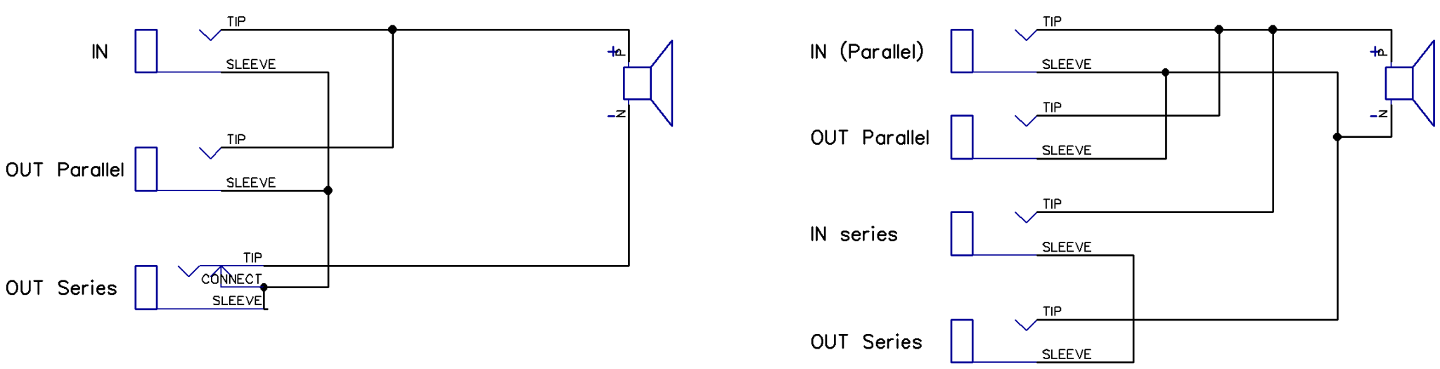

Draw a schematic rather than an incomprehensible 'wiring diagram', and anyone reading it will understand what's going on
I have guitar amp heads that have 4ohm, 8ohm, and 16 ohm output transformers only. I have two separate speaker cabs that are both loaded with a single 8 ohm speaker each. I would like to be able to use a single cab at 8 ohms. That’s no issue. I want be able to add the 2nd cab either in series or parallel to the first to get 4ohms or 16 ohms to use the other two heads, but I want the first cab to always be connected to prevent a no load situation.no sorry the doodled diagram has a problem...well two....possibly three... don't quite know where to start...and as i'm uncertain just what you want to do here i hope you can elaborate on that.
I do not want to use a toggle switch as that is just something that ends up getting broken. I do not want to use a switched jack as they have a tendency to fail.
Yeah, when I have access to a computer and not my phone I’ll do that.Draw a schematic rather than an incomprehensible 'wiring diagram', and anyone reading it will understand what's going on
I think this is correct. Although now that I look at my original mess I'm not sure you can do it with 3 jacks without one of them being a switching one. I put another with 4 separate jacks.

Why don’t you use 1/4” plugs on both positive and negative and just do the connections with your cables? Just put four 1/4” jacks on each speaker. Make a bunch of 4 and 8 foot cables and you are all done. Just make sure your impedance matches before you turn your amp on.
