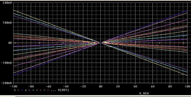

Simulation says ....
That circuit has pretty good CMRR. Unmatched 1% resistors, shown below, give about 36dB CMRR. Matching to 0.1% gives 56dB CMRR.
I don't know too much about guitar amps, most of the circuits I saw so far had 100k or so ZIN.
Resistors R1 and R2 can be virtually any value, as they do not affect the gain. You could increase them to 100k and beyond. This might make the system noisier, though due to the resistor noise. Give it a try.

I've successfully tried to omit R1 completely and this appears to work for some reason. The advantage with this is that the source doesn't see and load. This should have a bad impact on the CMRR figure shouldn't it at least theoretically? I've found out that I could choose R2 pretty big to diminish the sacrifice of symmetry. Is this a good idea?

Just use a JFET input opamp and forget about that TL072. You'll get the nice high input impedance you want.
Actually I'm not too concerned about the op amps internal input impedance but rather the circuit I'm using. I guess they all need some amount of bias current into the input either through a resistor or through source.
