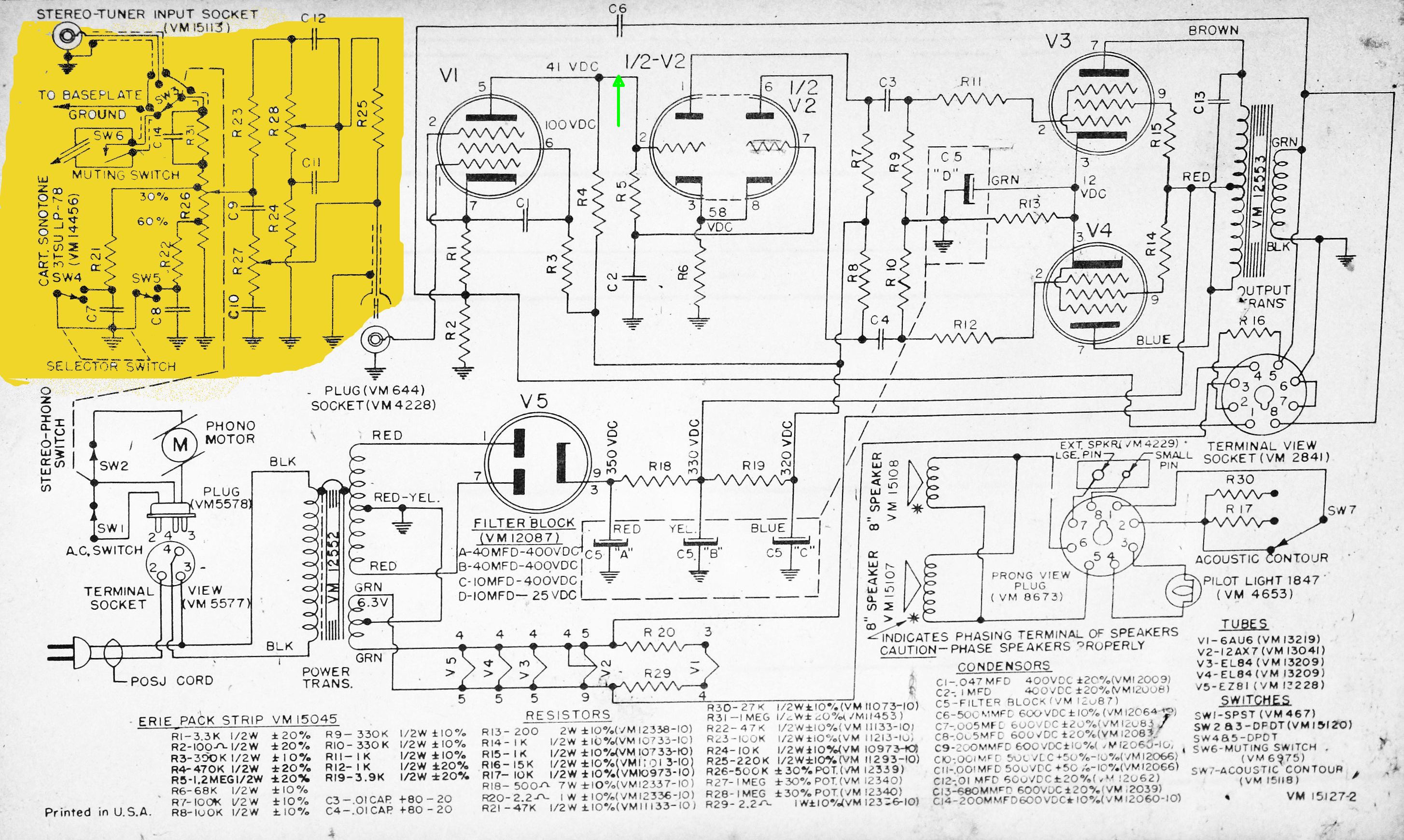

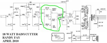

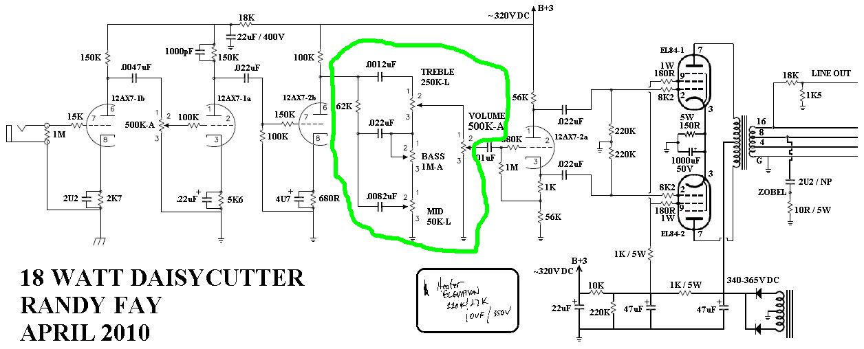

I have this great tube amp from a Voice of Music 562 turntable. I would like to convert it to a guitar amp. It has a complex volume/tone control that I don't think would work for the guitar amp (yellow area).I will plug the guitar straight to pin 1 of V1 (with the usual 1M/33k guitar input wiring). Still, I would like to have some tone controls, like in the second attached schematics. I thought I could put such a tone/volume control block between V1 and V2 in the VM-562 schematics. Is that correct? Put it at the green arrow? Thank you for your help again!

No, because the point you marked is live not also for audio, also for DC, and putting tone control there, you are changing the DC bias of the phase splitter causing severe distortion of audio signal.
The tone stack ''works'' as they are arranged to de-couple the dc component from the plate. All the capacitors running in the filter network are doing that. Problem being is you are going to attenuate the signal with a tone stack, and you only have a single preamp stage before hitting the phase splitter. OK for line level , maybe not enough level to boost guitar signal to get decent overall gain. If you had a dual triode , or another maybe FET boosted stage to kick the signal up you probably would be able to play with a tone stack.
As shanx said this tone stack has a lot of loss, it also likes to see a reasonably low output impedance from the stage that drives it and the output of the pentode is high impedance. One option is to use a low loss tone control commonly called a Tweed tone control, you would also have your volume control at this point. Another option is to use a MOSFET as a cathode follower (source follower) on the pentode. This gives a low impedance for the tone stack and helps the pentode in the gain department.
It looks like you may have to modify the phase inverter as it is direct coupled to the first stage and throwing in the tone stack will change it's operation as Osval do de Banfield said. There are a number of ways to go here but I do not have time to go through them now. Hopefully someone here has a good suggestion.
You also have negative feedback around the whole amp on R2 which is not desired on a guitar amp, you can get rid of C6.
