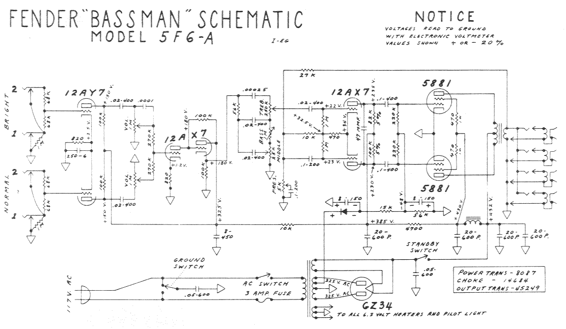

Not having a schematic to look at but seeing that the amp has a passive TMB tone control I would say you have a open connection at the base of the tone stack. That is how we effectively take the tone stack out of the signal chain, by lifting the ground on the mid pot.

Presence controls are usually the result of reducing the feedback of the power amp by rolling off the treble in the feedback signal. Because there is less voltage to reduce the treble signal coming into the power section there is more treble at the output. Has more effect when running the power amp clean than when in clipping.

No, in a guitar amp 'presence' is a treble control. Printer2 has seen Fender and Marshall schematics. They pretty well define "most" guitar amps.

Peavey does it also and also has a resonance control in the feedback loop. If you look at schematics with this control you will see a capacitor shorting out the feedback loop to ground. There is no possible way it can effect the 'lower treble' and not effect the 'upper treble'.

Then you obviously already know that those articles state it's an upper-mid control - with the original Fender ones doing so in the negative feedback.
See any there mention of mids being controlled? I don't.Wikipedia said:The original Fender presence control acted upon the amplifier's negative-feedback loop. As the level of "presence" was increased, so more and more of the higher frequencies in the negative-feedback loop were dumped to ground, leaving the low and mid-range frequencies. Increasing the presence resulted in there being less and less negative feedback on high frequencies.
They do, although some later Marshalls have something similar in their tube preamps.Perhaps tube amps have different Presence circuitry?
However, the point should not be "let's find some exceptions to the rule" but rather, "let's understand where this term came from and what it's generally accepted meaning is".
Traditionally, a "presence" control on a guitar amp affected the highs, mostly above the range of the treble control. This is different from the way the term is used in hifi and recording, but it's fairly common for musicians to have their own meaning for terms. Consider "gain", for instance. 😉

Fender 1958 Bassman, 1959 Marshall has the same circuit with a few value changes.
Peavey
Here are the schematics of the output sections of both the Valveking 112 and 212 amps. VR13 is the resonance control and VR12 is the presence control on the 212.
Other tube amps with a presence control basically do it the same way.
