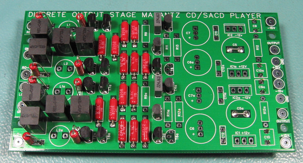

. I thought about removing IC734 and IC735 all together, and feed the clock directly to the DAC. There's just the problem of frequency selection, so it won't be able to play RBCD's after that. So I just left it as it is. But it must be adding jitter to the incoming clock-signal 🙁.
There's just one ferrite bead separating the IC's from the rest indeed, not very impressive. I have to open my player anyway, to fit a new analog output stage, and I have a spare Tentlabs shunt here. I'll have a look at it, thanks for the tip! 🙂
