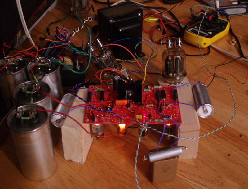

I recently finished a PPP gu-29 amp. I built 'maida' style regulators for the bias and screen supplies.
It sounds very good!
200v on the screens,
610v B+
about -28v on the bias supply.
610v B+
610v B+
awesome, can you post pics please....
"Finished" was perhaps too strong a word. It's electronically done, but I am currently drilling holes in the panel. I used Pete Millettt's mono PP driver boards, so he takes the credit for most of the design.
The last pic I took of it is posted in his pcb thread. Maybe I can link to that pic...
Well, I can link to either the thumbnail or the large image.. If you want to see the larger version, it's here:
http://www.diyaudio.com/forums/tubes-valves/203110-mono-push-pull-driver-pcb-20.html#post3324923
