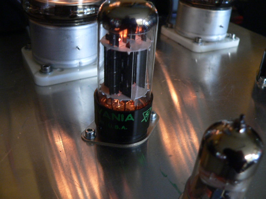

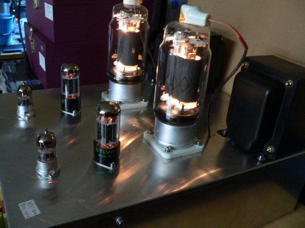

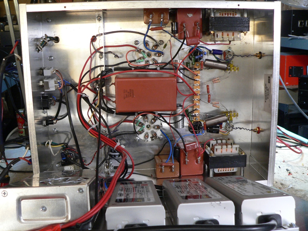

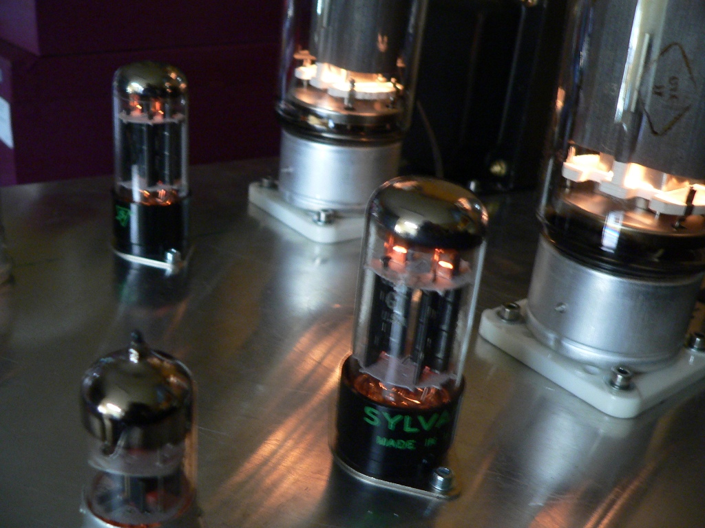

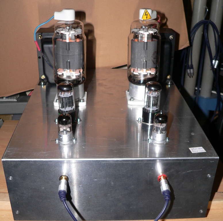

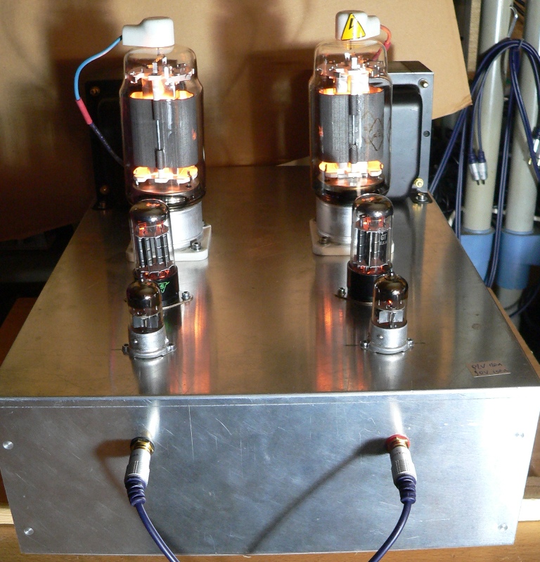

last quick dirty cheap monster amp by wonderfull NOS NIB GU13
UL 900V opt 3K5 output 20W linear +-1db from 20/20Khz very nice sound
max power 1Khz=40W/8ohm
driver 6BX7 100H 40mA plate load input 6C45P-E
power supply NES350/12 modified and 3X300V/500mA industrial smps

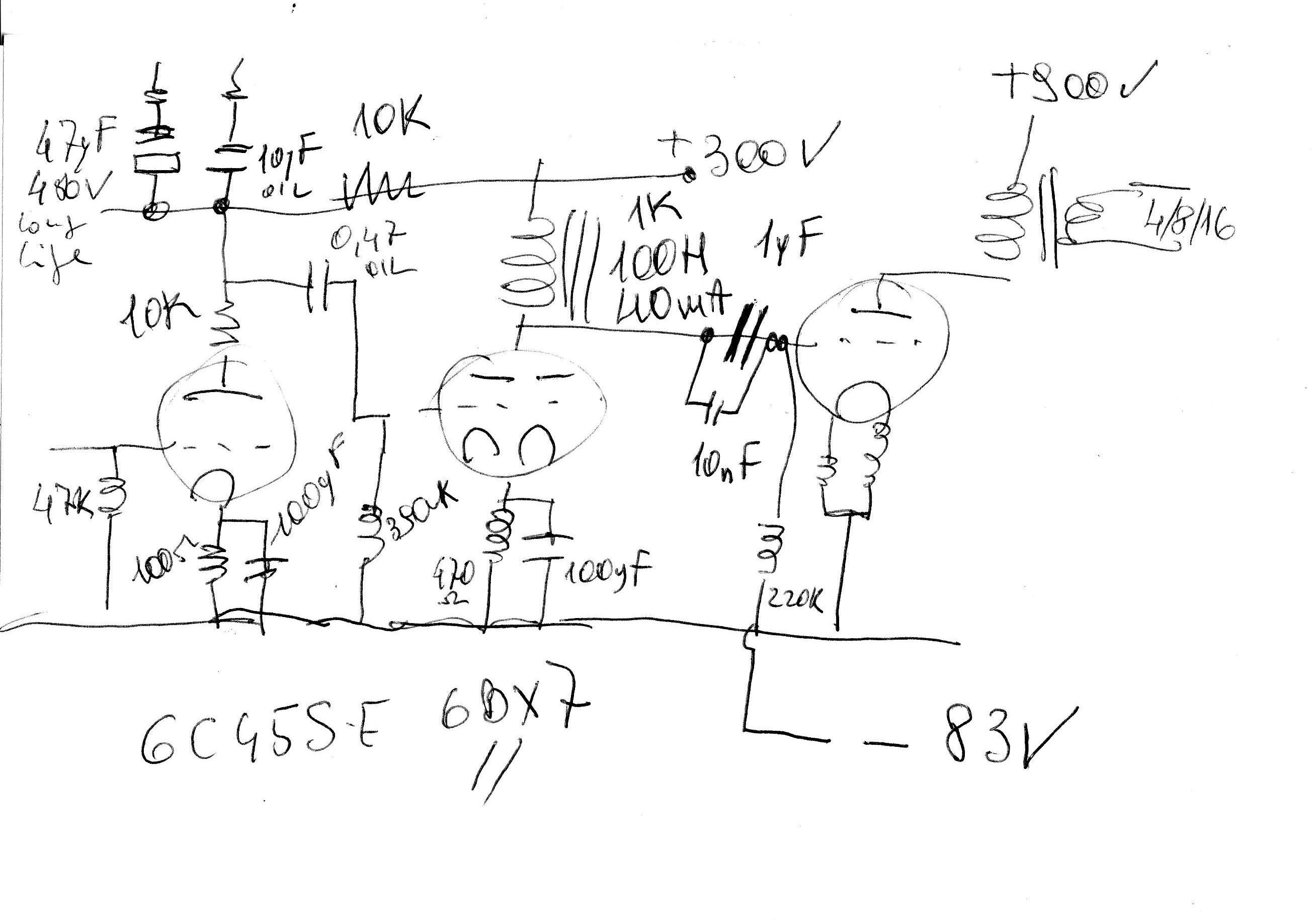

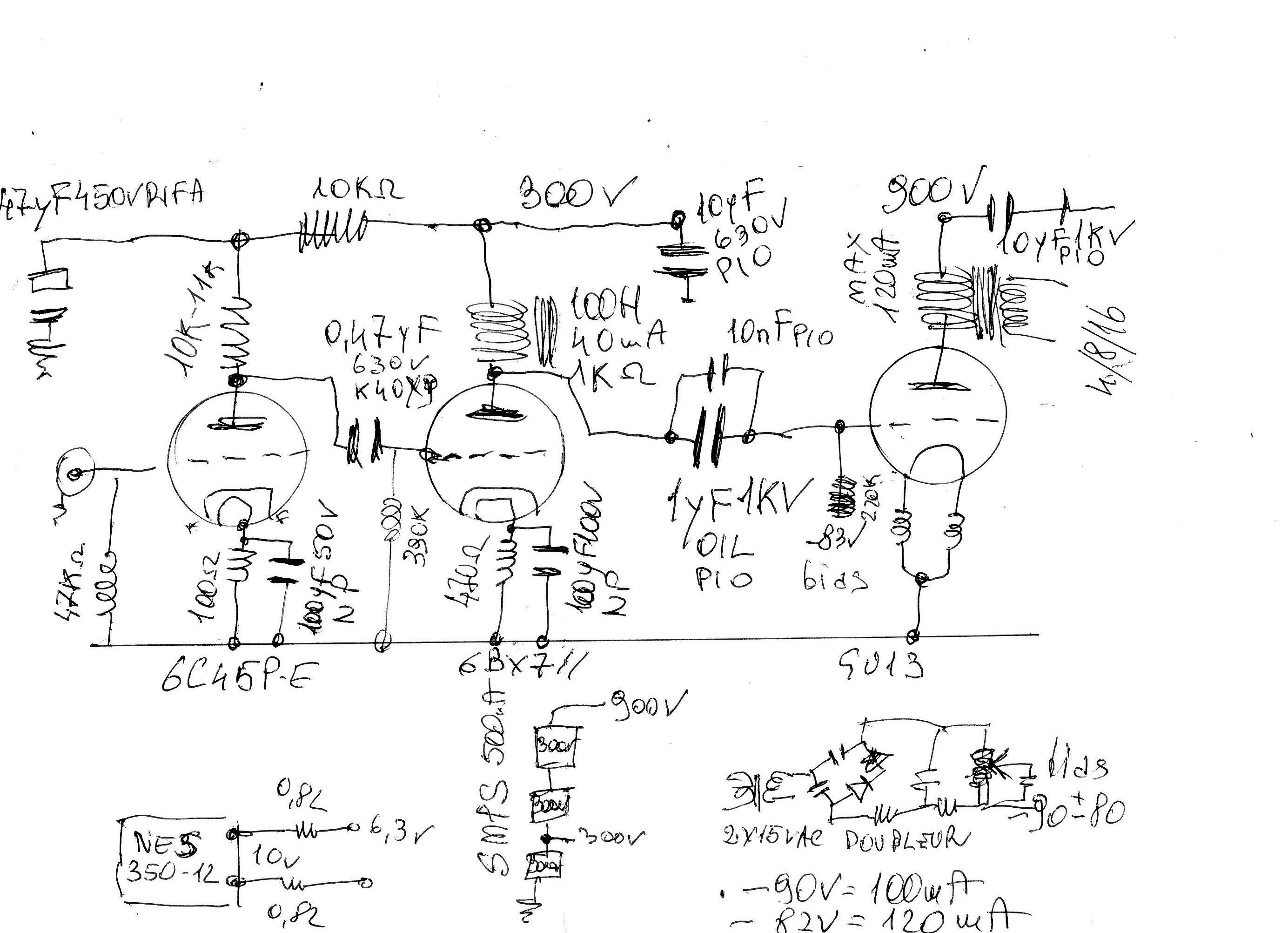

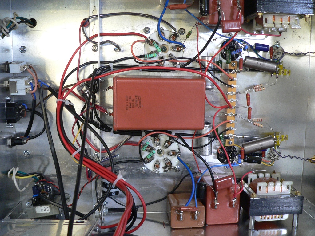

ha ha ha, look the photos, 1uF oil +10nF oil // between tubes
and also some grid bias, he he

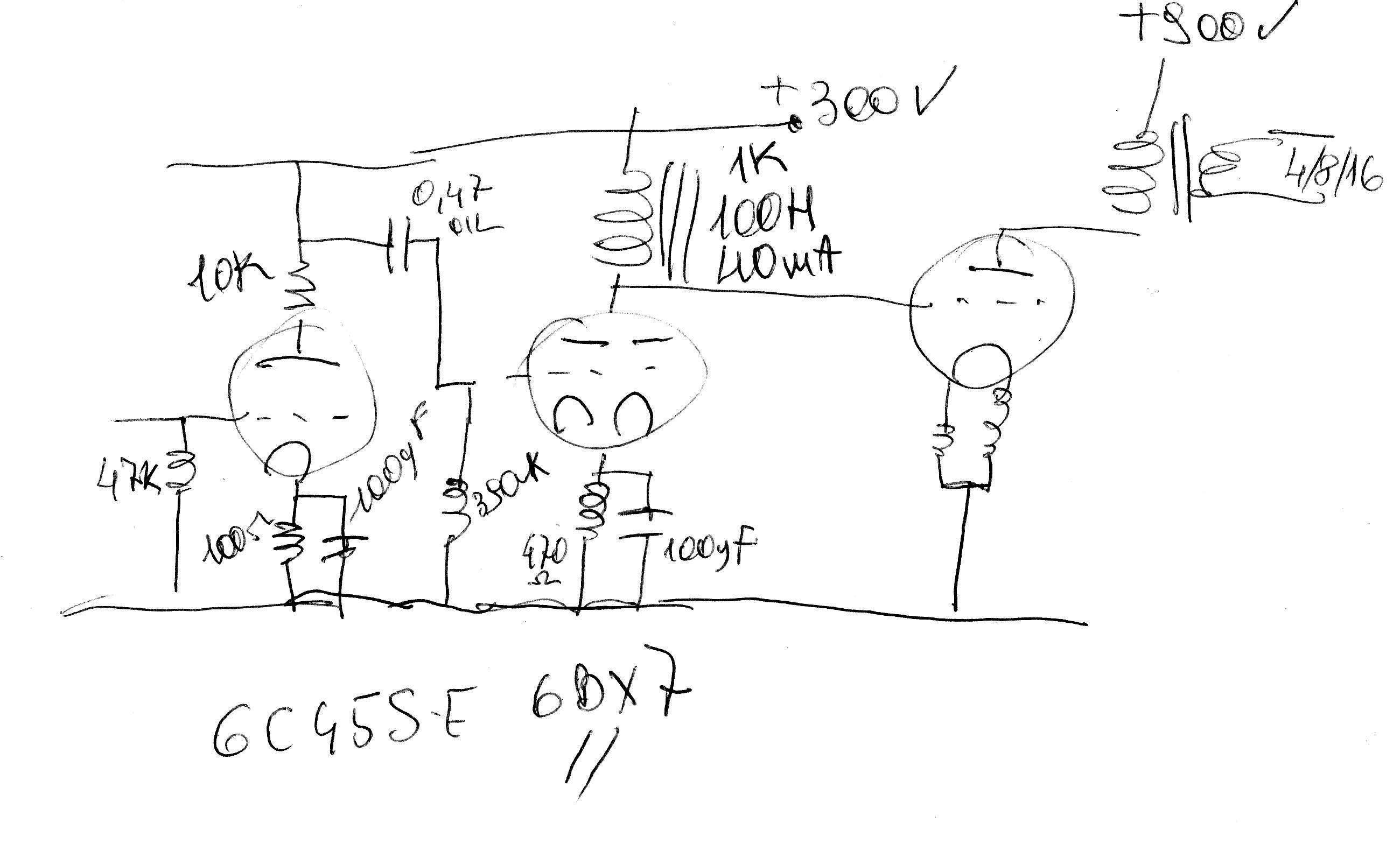

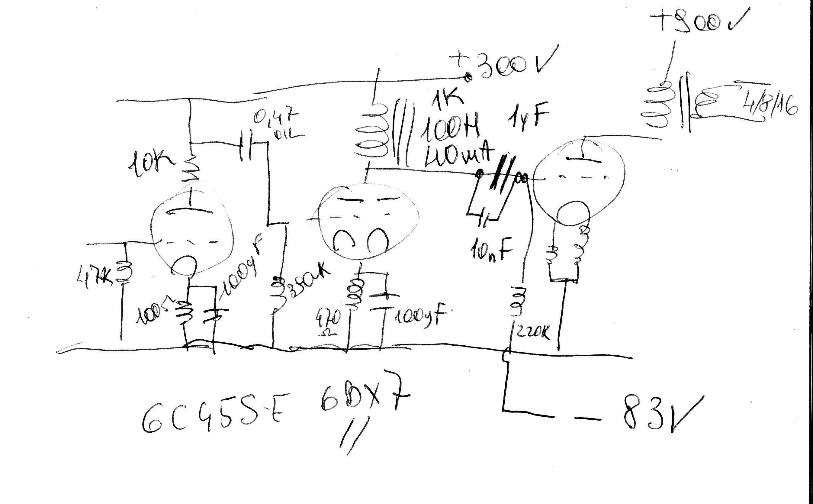

i write schematics very fast wen i make amplifier its in my head....

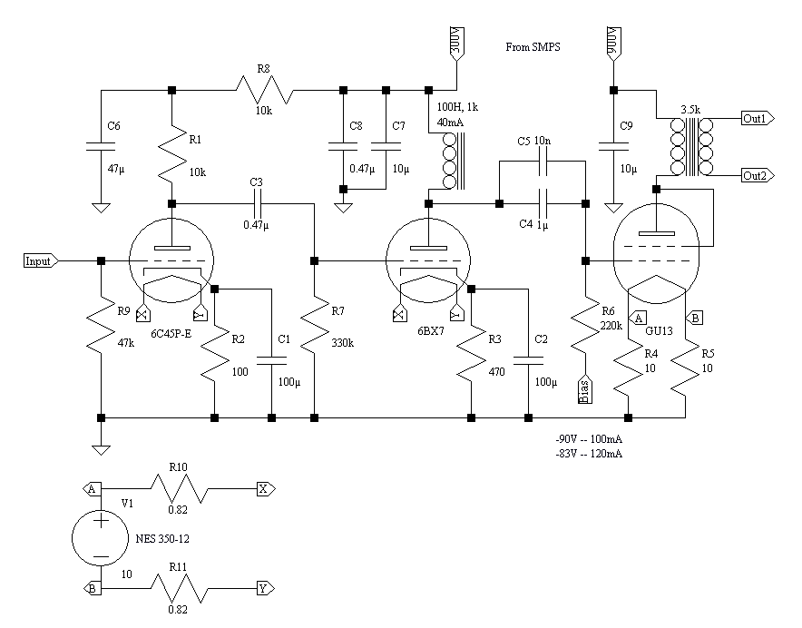

Your input stage output cap needs to move down one node. 😉
way? scool books??? guru bible ???? your taste??? bla bla bla from pseudogurus?
i do not tink there its any need for nothing
i just built my amplifier and i like it so i show you
i made it in four days and its sounding now, whay you wont my open the box again to replace this cap??? K40Y9 0,47uF 630V very eavy paper in oil
next step its two 816 MOV and two small chokes and bleeder resistors , one for each channel for more open sound but first at all the look of mercury vapor!!!
He only meant that the cap should be connected to the plate not the B+.way? scool books??? guru bible ???? your taste??? bla bla bla from pseudogurus?
hai hai hai i'm little codenfus no confused sorry apologise so of course yes
its the most elementary schematics and i done the amp directly without writing it
should say GU13 its wonderful tube and sound great
thankyou

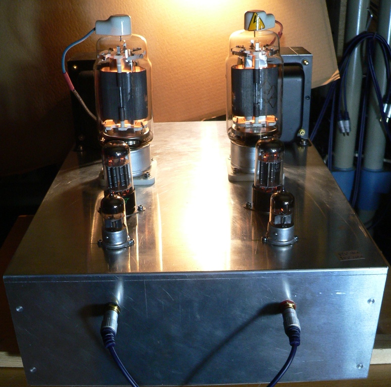

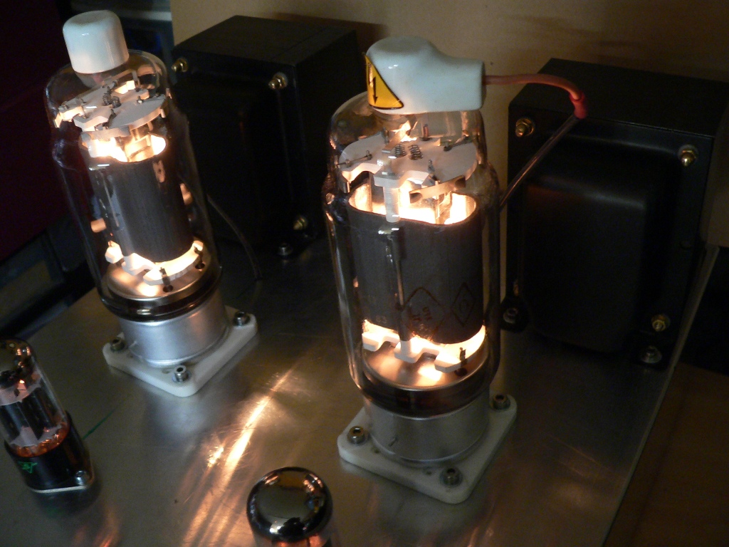

well this time should be fine, somebody can redone by some design program?

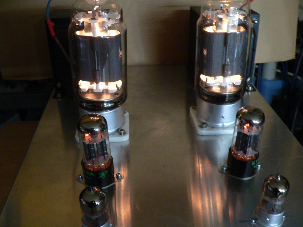

the tini aluminium box reach 45/50° so need holes for air flow next to come
i try to put 816 valves but need heather transformer, little chokes and caps
no much room left, i will check lather.
for the moment sound very nice, no heather supplementary caps, only 10uF1Kv
for HT900V no feedback ,no noises so let make music

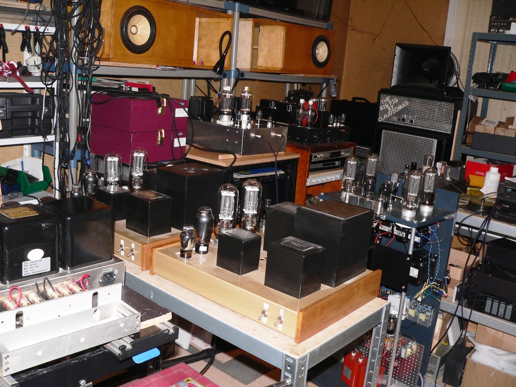

my workshop repair buiding and more
still forget decoupling caps 0.47uF // 10uF300V
and resistor values from cathode of GU13 to grd its 10 ohm
hello HI thanks a lot very kind Jazbo8
schematic make sense this time
really very nice thanks
claudio
claudio
