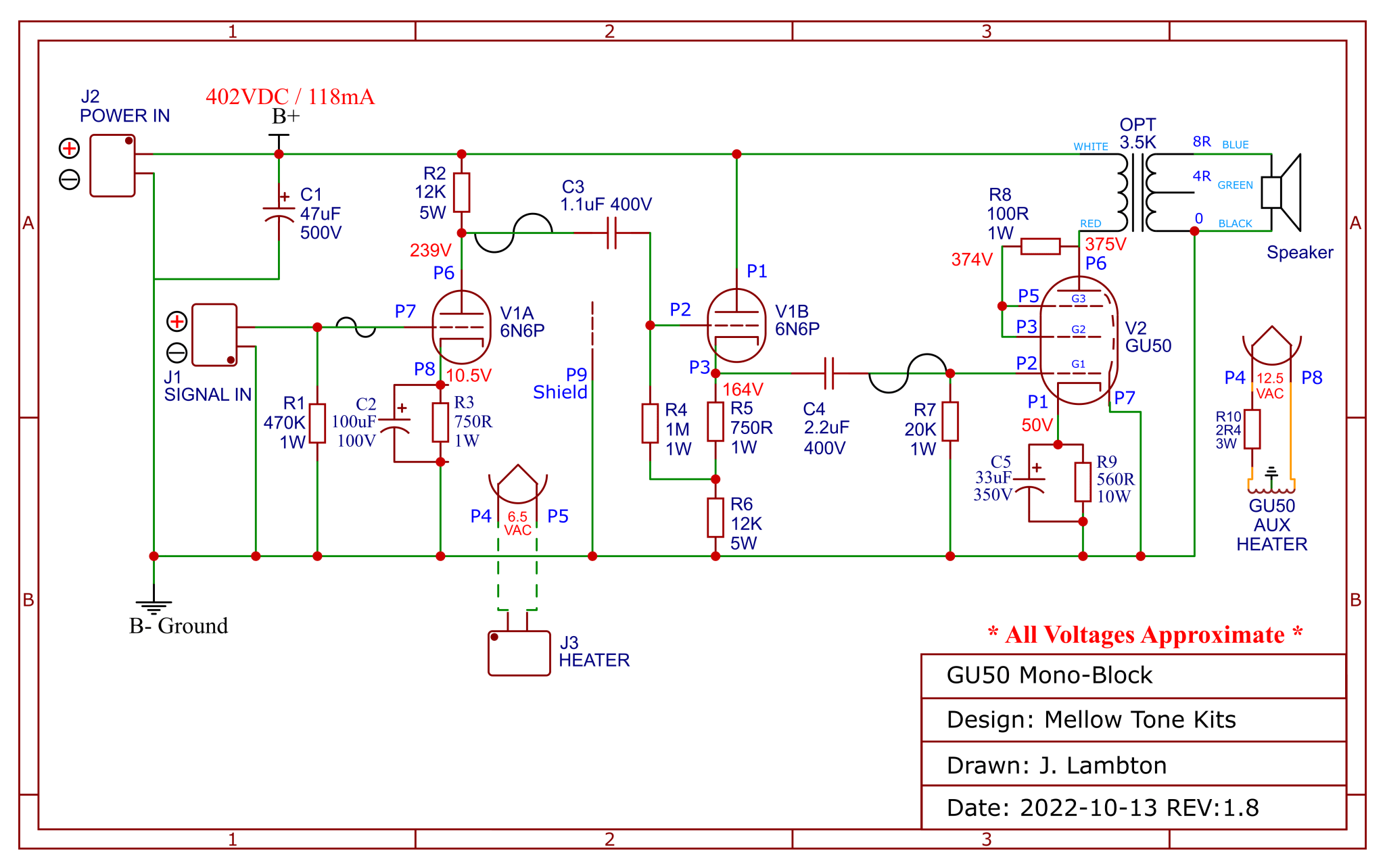

Greetings, Friends. I've been ruminating on a new power amp. I'd like to use a pair of 18w 5k SE OPTs on hand, and I'd like to use some of these Soviet tubes I've collected, namely Gu-50 power tubes and 6N6P drivers. Stereo amp, tube rectified PS, cathode biased, not too much silicone.
I like this design I found over on ValvesNMore.com
It has the 6N6P as voltage amplifier and cathode follower-driver and the Gu-50 in triode mode with g2 and g3 wired to the plate. But it calls for a 3.5k OPT. How would this circuit behave with a 5k OPT?

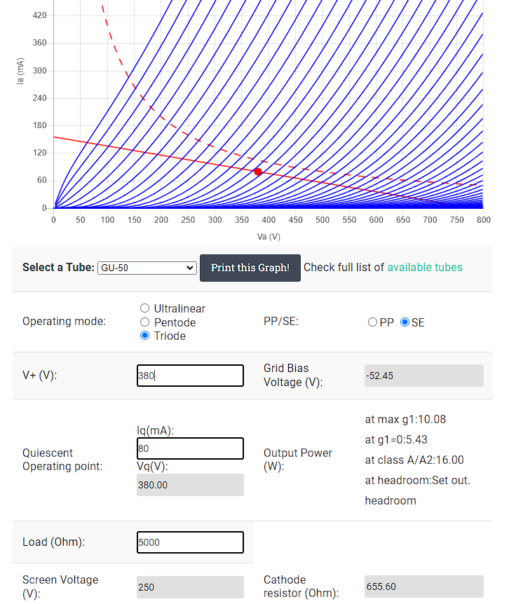

This chart from Vtaidy seems to look promising, with 380v on the plate, 80 mA, 52v on the cathode and a 650 ohm 20W cathode resistor
So if I can get a b+ of 420v I should be in good shape. Thoughts?

You can use the "headroom" field at the bottom of the parameters to see a prediction of 2nd, 3rd and 4th harmonic distortion numbers and THD. Sure, it is only a prediction like any sim but by trying different op points you can see relative trends.
5K vs 3.5K transformer will result in slightly less power out and lower distortion. Some people have been satisfied with GU50 SE output.

Medium mu VAS stage + CF (overall gain about 10) capacitor coupled to the power tube.
The GU50 bias is 50V, so input must be at least 5V peek up to A1 .... at about 5W output.
The amplifier's data on ValvesNMore.com shows 5.45V RMS input - 7.83V peek for maximum power: more over A1 limit.
IMO it's not optimal construction.

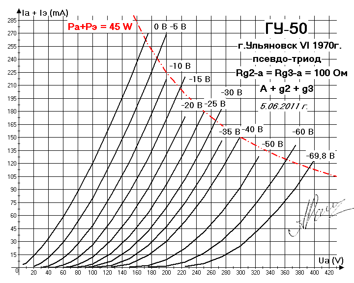

Does anyone know Mu for triode strapped GU-50? I have not found it while searching the internet, including Wiki.
I got 3.6 from analyzing a graph. Does that seem reasonable?
It's got to be something low like that Gimp.

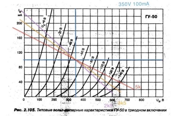

Here, let's do a little calculation. AT 100mA, grid volts change from around -18v to -60v between 200v and 400v anode tension.
So (400v-200v)/(60v-18v) = 4.76 - BUT: I am not sure how g2 and g3 are connected in the above chart.
If I look at some other Tridode curves (from Wavebourn) where both g2 and g3 are connected to the anode, I calculate different values:
If we look at 75ma, going from 120v to around 245v on the anode, the grid voltage goes from around -10v to -40v.
This means mu is around (245v-120v)/(40v-10v) = 4.17
I would tend to trust Wavebourne's chart...
