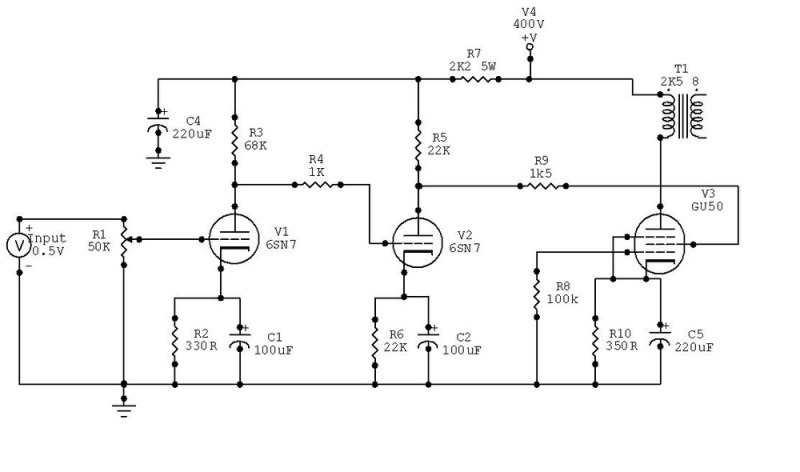

Hello, just wanted to ask a quick question. I am building the below gu-50 SE but what amount of max current should the b+ transformer be rated for? And I was looking at some Edcor transformers that had to 6.3 volt filament windings, can these be wired in series so the the center tap becomes 6.3 volts and the screen cond 12.6 volts.

The max current rating for B+ is around 200mA for this schematic (100mA/channel).

Some words about the schematic: Good design with direct coupled (no capacitors in signal path). Signal feed directly to G2 of power tube is worth for trying. However the dynamic and detail of sound is need more discussion 🙂. But it is realy worth for trying.

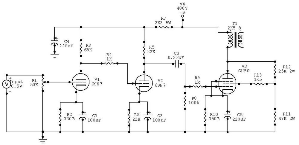

Hi Fox,
the difference between the schematics is not slight but dramatic.
the first one is screendrivin the GU50 and in the second one its in the normal pentode mode. Both have their pros and cons. think it will be interesting to build both and see how it performs.

You should try both schemas to taste the differences. Pls note that C3 and C4 must have voltage rating 450V or higher.

I don't think the first schematic will amplify enough to drive the screens. The GU-50 isn't a very good tube to screen drive, because of the 250 - 300 volt screen voltage. It needs to be more like under 200 volts to do well with screen drive.
You can run the GU-50 ultra linear, if the B+ is 300 or under. Or in triode if the B+ is 350 or under. Screen voltage for pentode would be better if it's regulated.
