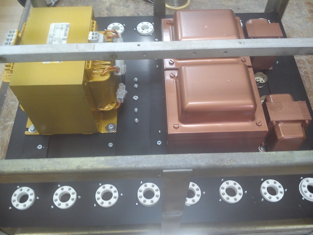

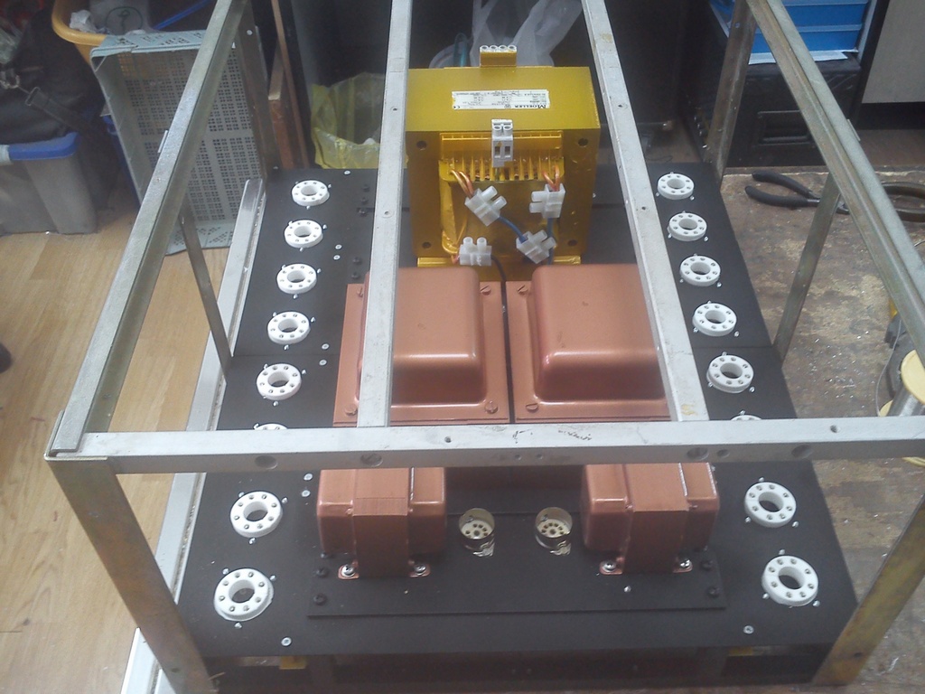

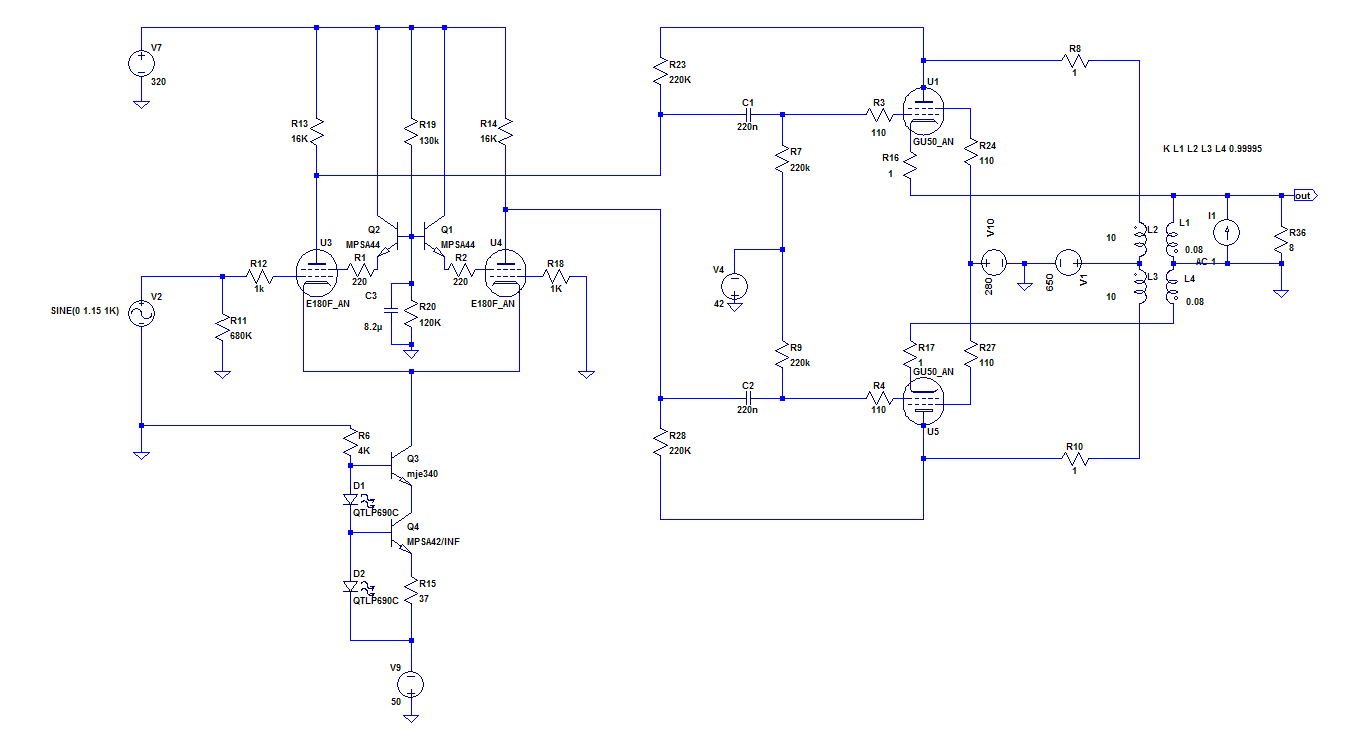

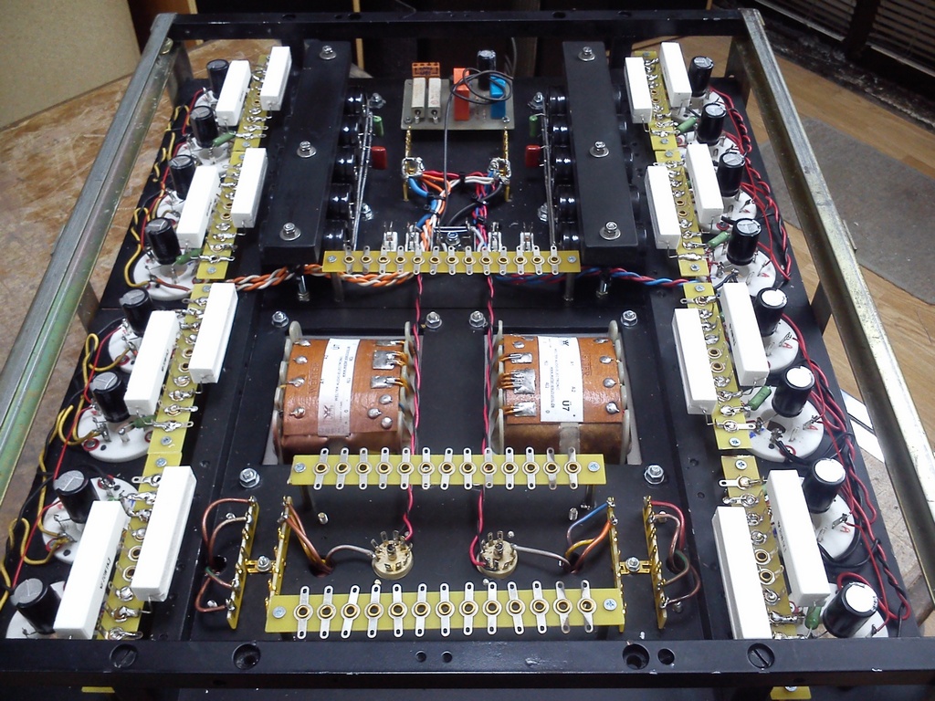

GU-50 sound like a charm in my amps. I don't have a complete schematic drawn, they have almost directly coupled drivers with servo, parallel feedback by voltage across output tubes, and regulated voltages for screen grids and drivers.
www.wavebourn.com • View topic - Pyramid-VII: home stereo vacuum tube amp

I can draw full schematic of my Pyramid-VII, but I'm short of time currently. I even wanted to write an article for Elektor magazine about it, probably I will do that later.

Tubes for input and drive are 2 dissimilar duo-triode13DR7 with inter-stage transformers (1+1:1+1; 10k:2,5k+2,5k; my own construction, calculated and winding in my hoby room).
I still have not the whole scheme drawn, but I will show you very soon.
Currently I'm looking for a suitable analogue VU-meter (large, but not too expensive!), and the entire project was temporarily stopped.
I still have the whole scheme drawn, but I will show you very soon.

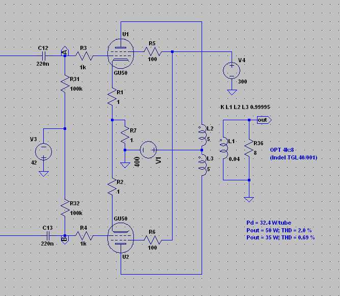

Simple and relatively low voltage (+Ub = 400V) version of GU-50 PP.
This uses budget OPT Indel TGL40/001.
