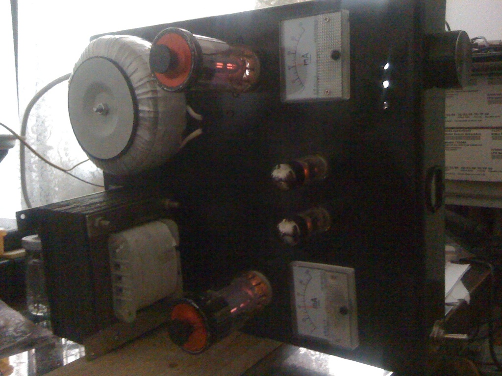

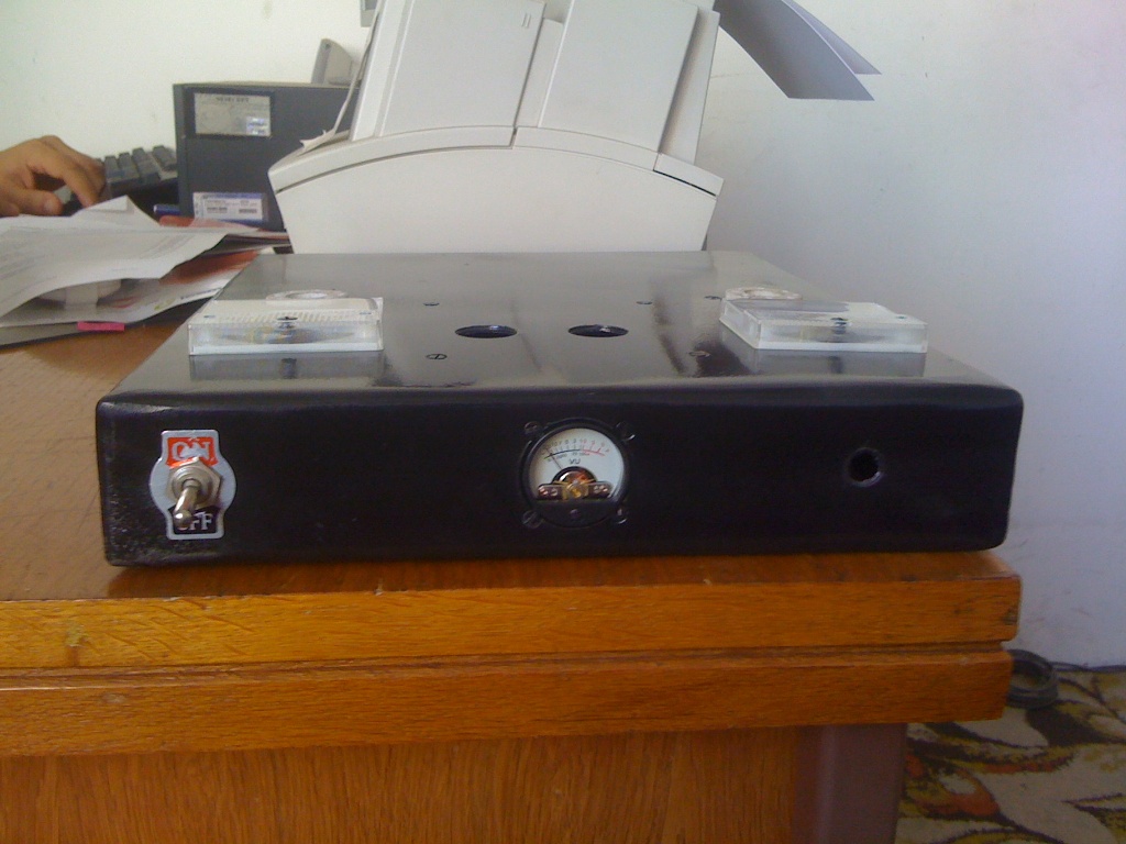

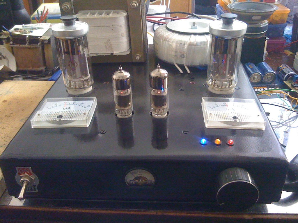

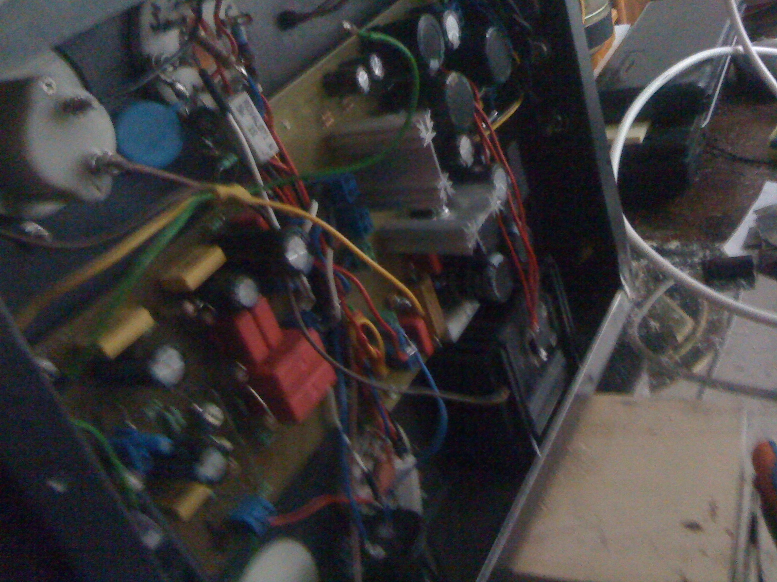

hello dear "audio"friends...I managed to do this...since this is my first post on this forum....I can hardly wait your opinions...remarks etc

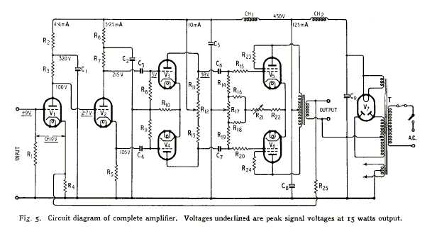

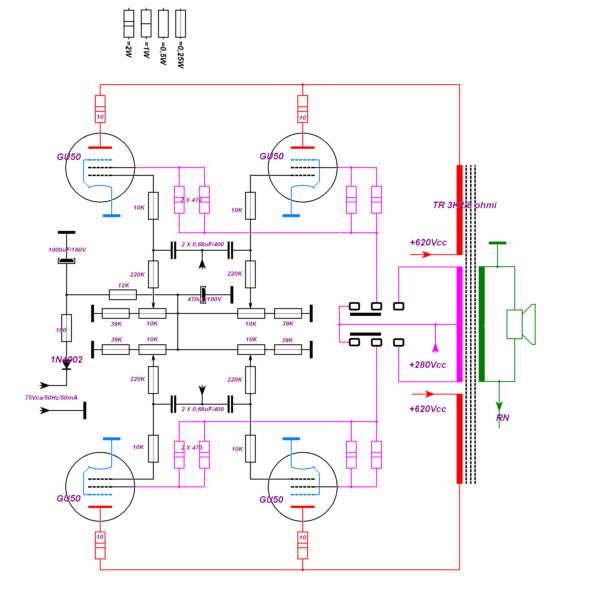

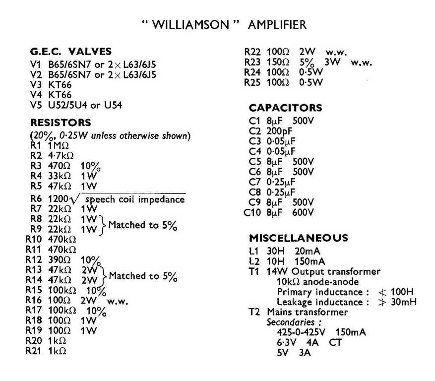

me again...schematics of the williamson "amplifier"
I put here the original schematic that I used...with the following modifications: V1,2 V3,4=6N6P(russian) Ua=400V R2=18k/1w,R6=12k/1w,I also added a trim pot(20K) on the anode of V3,4 for simetry of the signal...now the most important part..I used one pair of GU50/channel,so the OT(output trafo) becames Raa=6k4 5000 windings of CuEm=0,25 and secondary 189 windings of 0,6CuEm you can see in the attachment...I used 28Cm2 instead of 24Cm2

warm...POWERFULL..clear....
Nise, and good documentation.
How does it sound?

All well and good, but you didnt show the real schematic yet, just a generic one...

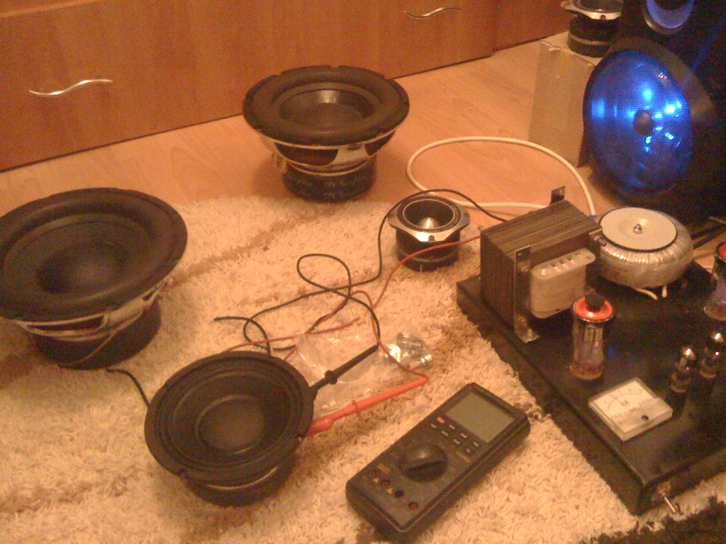

Also, I am sure it will not play very well on top of your loudspeaker.

everything is there not generic....download all attachments and you will see
