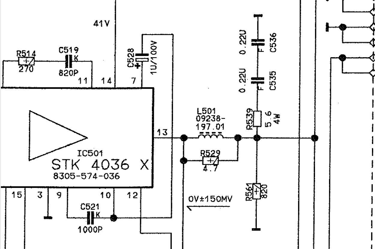

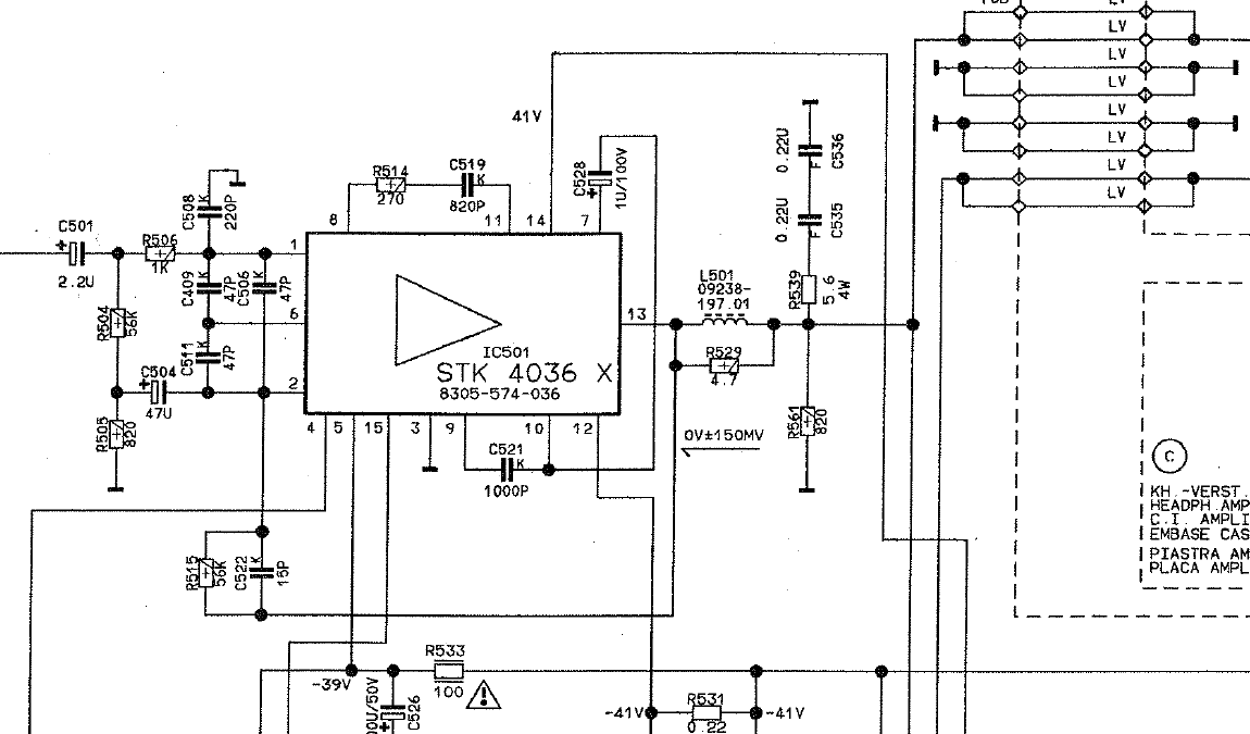

I have another question:
I want to get rid of STKs and put L12-2s instead. The signal out from L12-2 I want to connect to leg13 of former STK where it's signal was also going out.
The signal goes through coil L501, then between resistors R561 and R539 and then to speakers (up) and speaker protection (down).
That resistor R539 is big 5.6R and 4W (!) what I don't understand.
Maybe I should now connect the signal out after those resistors ?
Please help.
Its a Zobel network Peter so you need it to stop instability and back emf by the voice coil of the loudspeaker is stopped by the series coil and parallel resistor so disconnect pin 13 from the chip but connect your output from the new one to that point.

Its a big wattage yes but I have seen burnt out lower wattage resistors ,its not really doing any harm .
I have built power amps without series inductance's just a series resistor but they are modifications of JLH designs who just used a resistance and are discrete not a big chip.

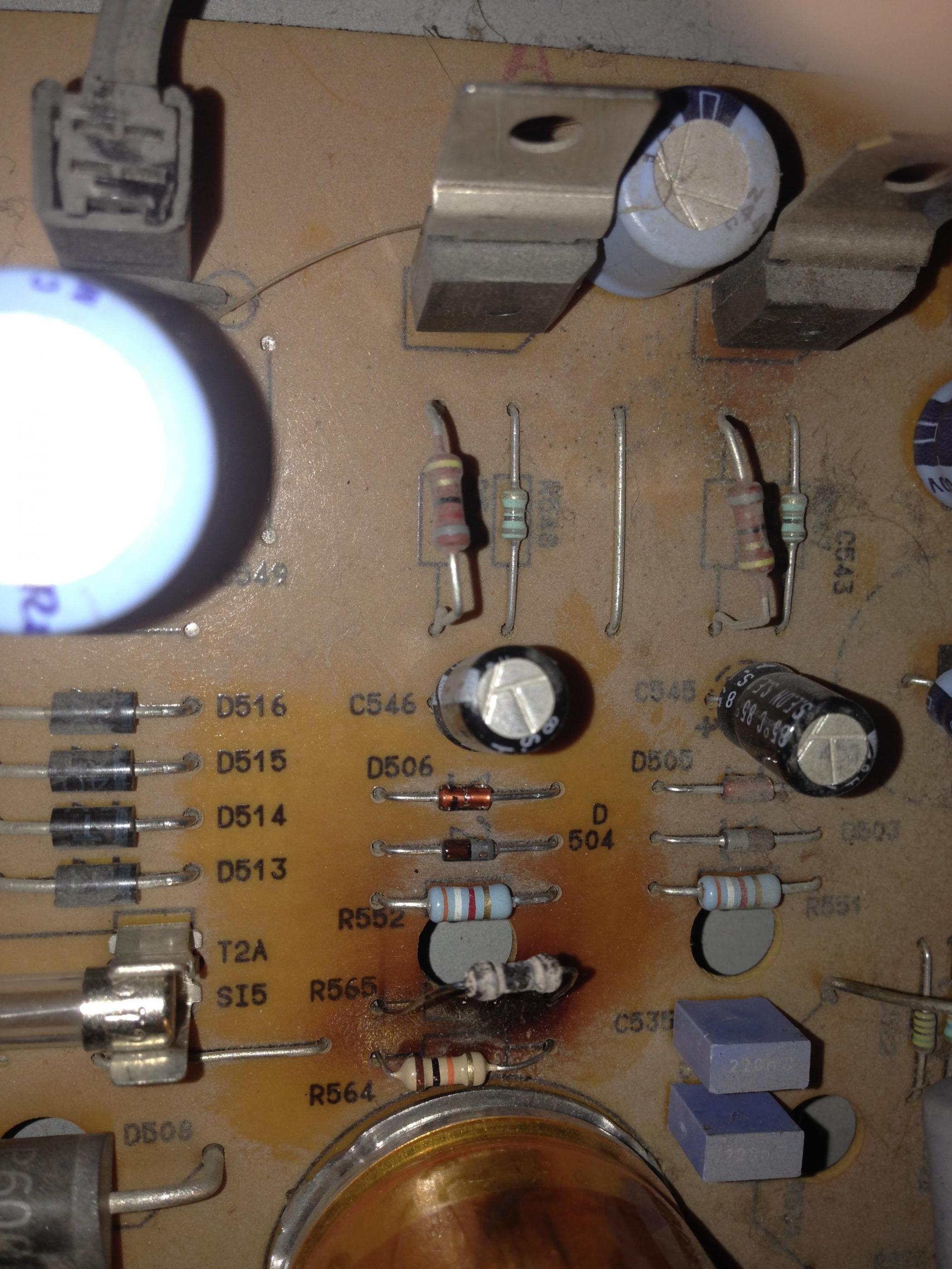

Coincidentaly, on a Polish forum I've found information about a burnt resistor. It was that R565 which I have mentoned in my first post, the smaller one 3.3 K.
So if that value is really important I will replace it with 2W one.

On a website L12-2 - modifcations - calvins-audio-pages I have found some modifications proposals whih are presented on schematic attached. I would like you to look on a right side with a Zobel network proposed consisting of coil L1 of 2,2 uH and resistor R35 of 2,2R. It is described as LR-network R35/L1 with values of 8-10Ohms for R35 and 1µH-2µH for L1.
In Grundig schematic (attached) there is also a LR network with a coil of unknown inductance and resistor 4,7 R which may also work I think.
But please have a look what is down from LR network on L12-2 schematic - there is resistor R21 10R/1W and capacitor C9 100n - they are both already on L12-2 plate (not modifications). In Grundig schematic there are (mentioned in previous post) resistors R539,R561 and capacitors C535 C536.
So I probably should desolder all of them ( leaving only L501/R529) as such branch (R21/C9) is already existing in L12-2

If you are not replacing the integrated audio chip with another audio chip but a discrete amplifier circuit then yes you can do that.
Although the resistor at the output is parallel an inductance of 2.2uH I would check the inductance value of the wire-wound resistor as it could actually be enough to dispense with the inductance ,many of JLH,s amplifiers only had a wire-wound resistor at the output and I build amplifiers using the same method (after measuring the inductance value ) .
Do you mean Grundig resistor R529 4.7R if it is wire-wounded ? I have no instrument to measure it's inductance.
Generally speaking I am going to desolder the STKs and desolder all resistors and capacitors "servicing" those ICs except that RL path (L1/R529) but I may do a bypass of that to check if there is any difference.

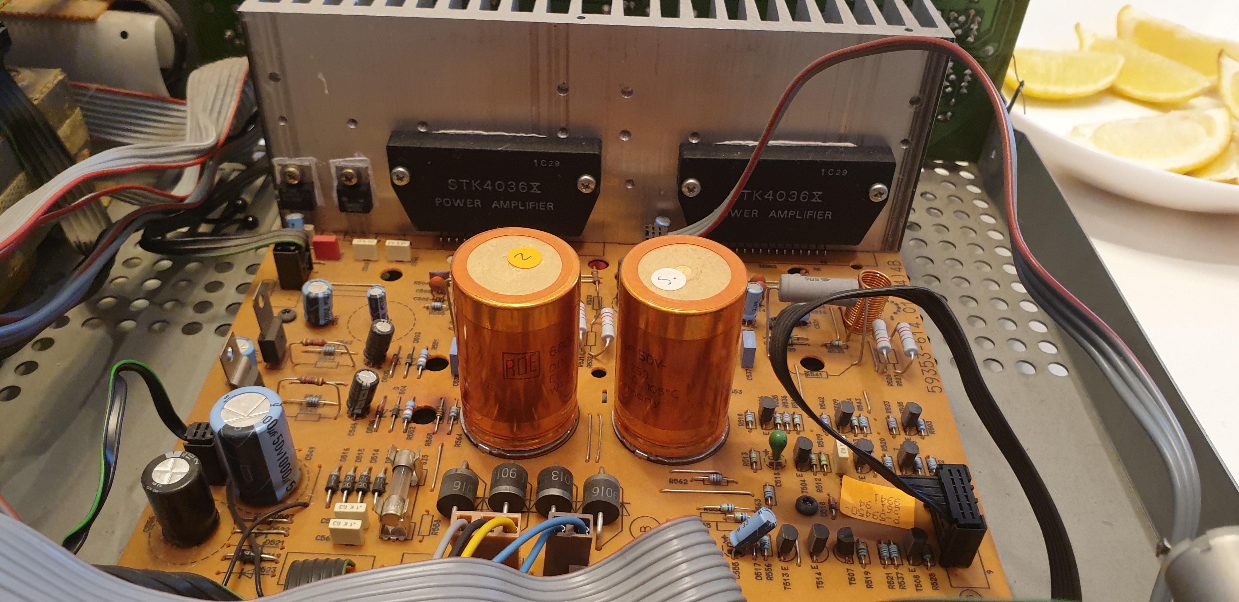

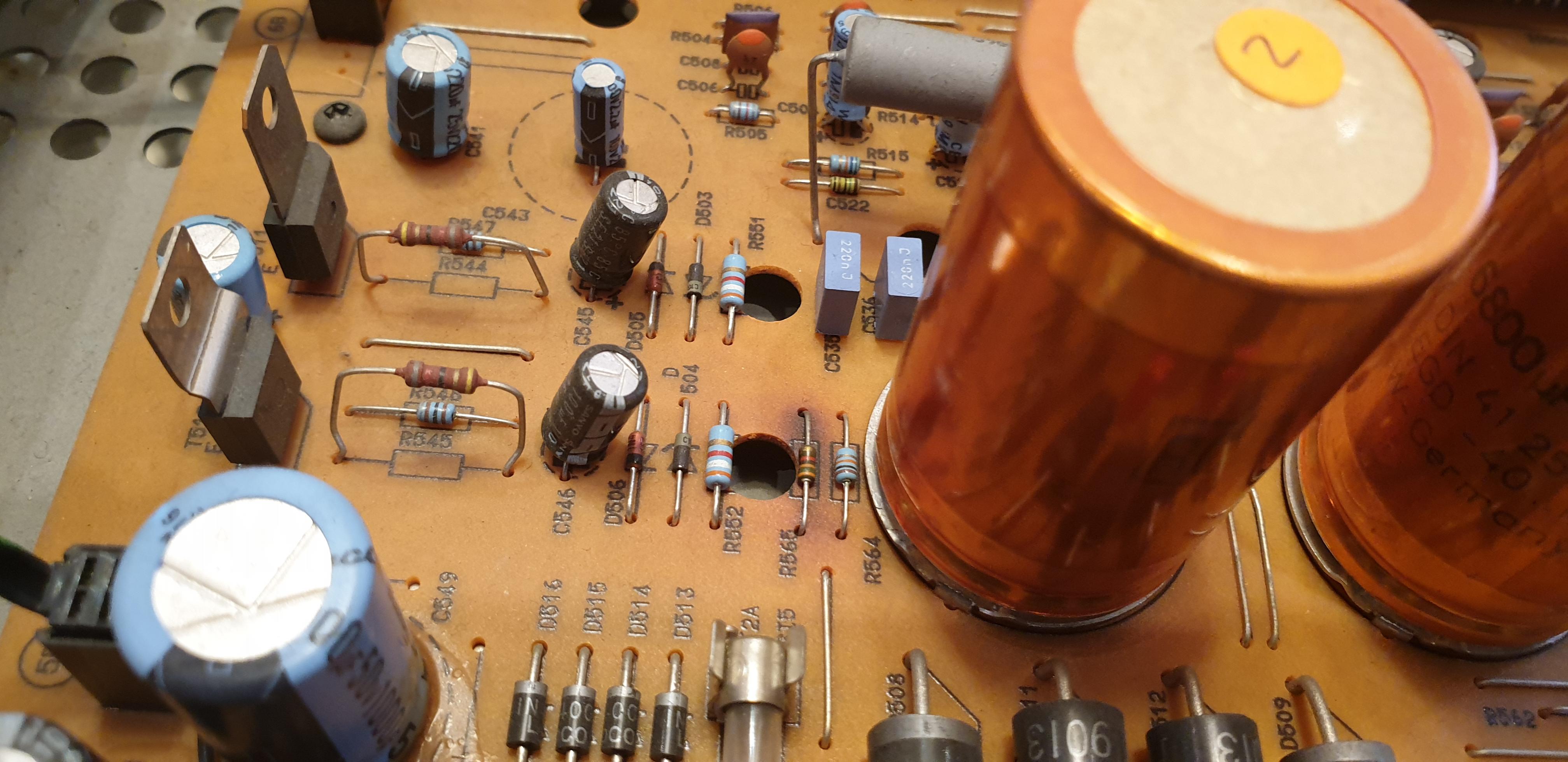

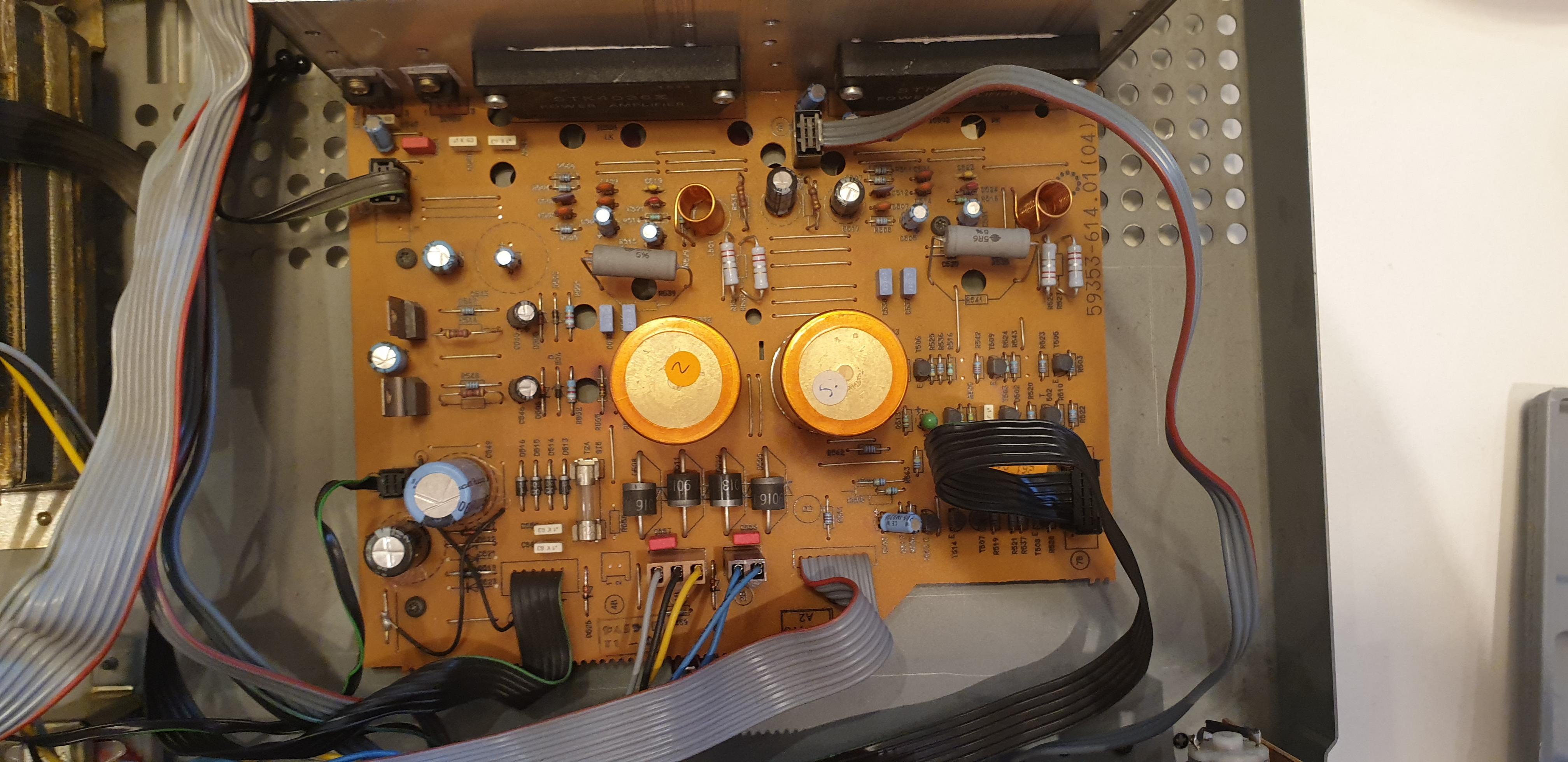

Project completed!
Now some pictures before and what was done to Grundig V8100/V303:
- rear connectors for remote control were changed to equalizer out and in sockets
- both STK 4036X were removed and so all semiconductors which were "supporting" them
- thanks to above semiconductors removal there was a place for adding additional 6800 uF capacitors
- I have left coils L501/502 and resistors R529/535 4R7 but changed them to 2W
- resistors discharging main capacitors R564/565 were changed to 2W and that R565 which causes problems in each amplifier was changed from 3,3K to 6,6 K
