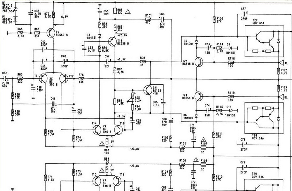

I was given an old Grundig V35. I was thinking in using it as a source of parts for a project like Destroyer´s "Blame Es" or similar.
When connected to a decent pair of speakers , it sounds VERY well except for a small amount of hum in the left channel. The intensity of the hum is constant regardless of the volume.I think it´s worth trying to fix it prior to start dismantling...
I have ruled out the PS as source of the hum.
Sound quality seems the same in both channels in spite of the hum. Can be ruled out a failure in drivers?
I was thinking to start checking coupling caps in the signal path as a next stage.
Any other clue?

At first glance, it is not worth dismantling this amp to build the Blame ES. I can't see you reusing many parts, especially for those outputs being Darlingtons.
By the other side, I've had some headache with grounding techniques. It was all right before I decided to connect my Blame ST to real ground. Noise appears when the laptop PSU is connected to the same ground point; when the electronic shower is powered on; and some other situations.
So, if not a failing electrolytic, look for grounding problems (a bad solder, lose contacts, etc.).
