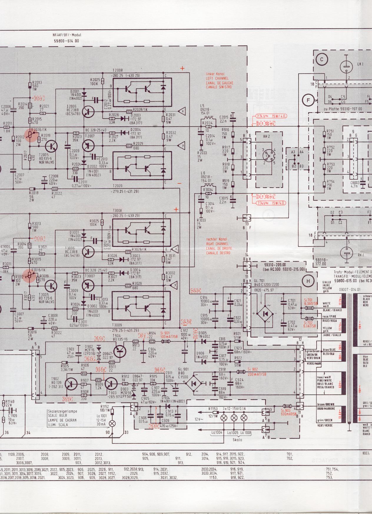

I recovered the amplifier module from an old Grundig studio RPC 350. This amplifier is a classical concept of the time (around 70”) – differential input with CCS, driver, darlington complementary finals (BDW 94 / 95)… It has DC transistor protection for the output and as well a kind of thermic protection switch on the heater sink (this protection cut entirely the main if heater sink get too hot).
I changed all electrolytic C’s and checked the rest of the parts. The rectifier bridge was replaced with fast recovery rectifiers and both 10.000µ/30V capacitors where replaced with 18.000µF/40V. Measured values as shown by Grundig are ok and the offset can be done within Grundig specifications (the old 1Kohm trimmers will be as well replaced with multi-turn one’s to get much easier control).
There is one issue I can’t get fixed. The original schematic show the T2004 as BD517. Actually in this place was used a small Motorola in TO92 package marked GPS AO5 and this transistor get hot – couldn’t find any datasheet on this one. Firstly I thought Grundig used cheaper parts and therefore I replaced these transistors with BD517 as original schematic show – but even these bigger T’s get too hot. Any idea’s where I should look for mistakes?
Second question – the offset recommended by Grundig is about 30mV (-10mV up to +20mV), measured on R2031 and 2032 (0,47 Ohm/9W). I made the setup on 50mV without any issues – that mean ~ 106 mA for each final without any thermal issues. Would be recommended to get higher considering the heat sink is relatively small?

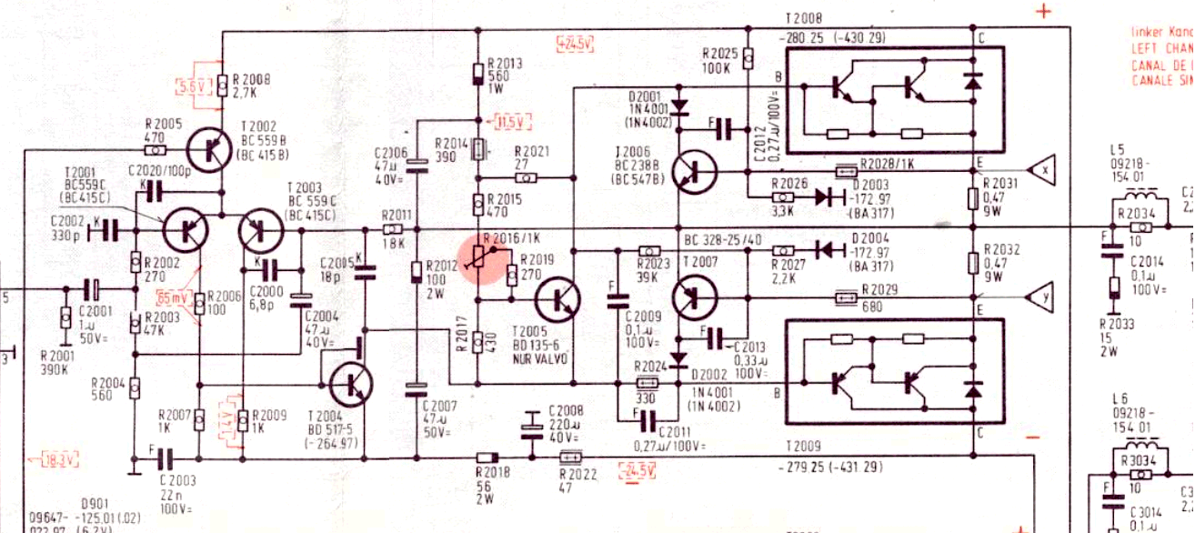

> T2004 ...this transistor get hot
T2004 dissipates essentially the same heat as R2013+R2014.
R2013 is noted as "1W", which is a clue there is a lot of heat here.
I've patched and cleaned the key part of the circuit for easier thinking.
R2013 + R2014 run at:
23.3V
950r
24.5mA
0.57 Watts
T2004 should be similar. Or: same current and same voltage.
> Actually in this place ... TO92
570mW is a lot for a small plastic package. Some of the newer forms do have 600mW ratings but it sure will be HOT, and I think 600mW is very brave.
That's a little Power-Tab part which can safely dissipate a Watt without a heatsink. But it still will run hot.
http://www.radiomuseum.org/images/tubephoto_klein/bd517.png
Silicon "can" run as hot as boiling water and live a long time. Wet your finger and touch the tab. Does it sizzle?
T2004 was failing because the load was shorted. While T2006 T2007 protect the output devices from large V or I, T2007 clamps the load to T2004, which tries to drive the load all by itself. Yes R2024 limits the maximum current into a short. It is not clear to me that T2004 "will" fail even in extended abuse. But past users faced with a dead amplifier sometimes "keep trying".
Also R2024 may have burned and been replaced with a smaller value.
A small heatsink on T2004 may be wise.
