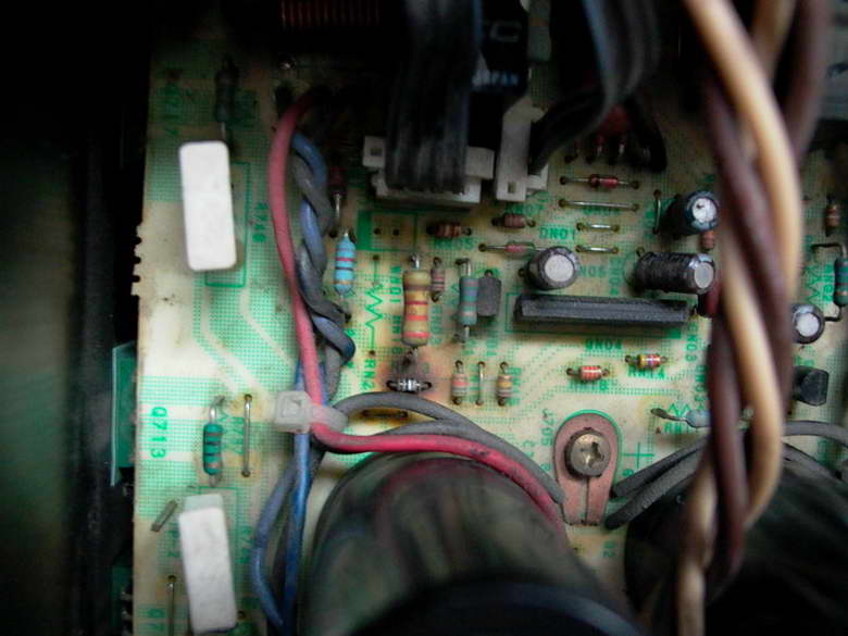

there is no voltage. actually i`m pretty sure, the reason is STK. in free time `ll replace STK and i hope it `ll helps.
measure DC on outputs before relay ;
if it's present , there is just slight chance that STK isn't shot
Measure input pins' voltages
If both measure nearly same, then the STK is good.
If u find this voltage is not close to zero, then check the resistor powering the input circuitry of the chip (will be around 100 ohms). This may be open.

I guess that if the relay doesn't click (turn on) the STK is dead so the protection curcuit doesn't turn on the relay to protect the speakers. Or maybe the resistor that's burned was powering the protection curcuit and now it dowesn't power the relay... Anyway send me the manual to check it out
Very thanks for all tips guys.
Actually i have no time to check all these options, but maybe firstly i should check the TP (Test Points to current idle) if there is any voltage. That ll be fast one. If there is voltage the reason should be STK.
Resistor on pic is burned, so i have to replace it. when solder it out, will check if it has connection between two ends. then one option ll be checked.
The scheme is available here: http://m2.xt.pl/grundigfineartsa9000.zip
