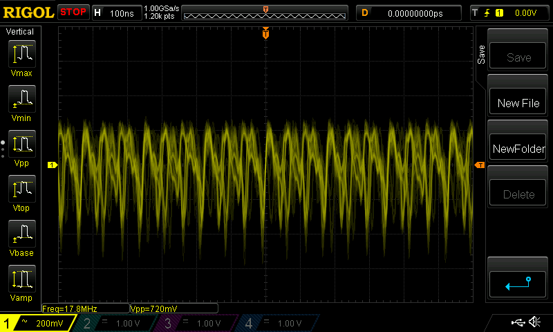

- The player works and sounds fine but skips pretty fast and the BIAS voltage is very unstable and it’s pretty much impossible to adjust it correctly. At the start of a CD I’m able to turn it up to around 350mV, skipping to the end of the CD the voltage is very unstable and differs between 300mV and 1600mV!

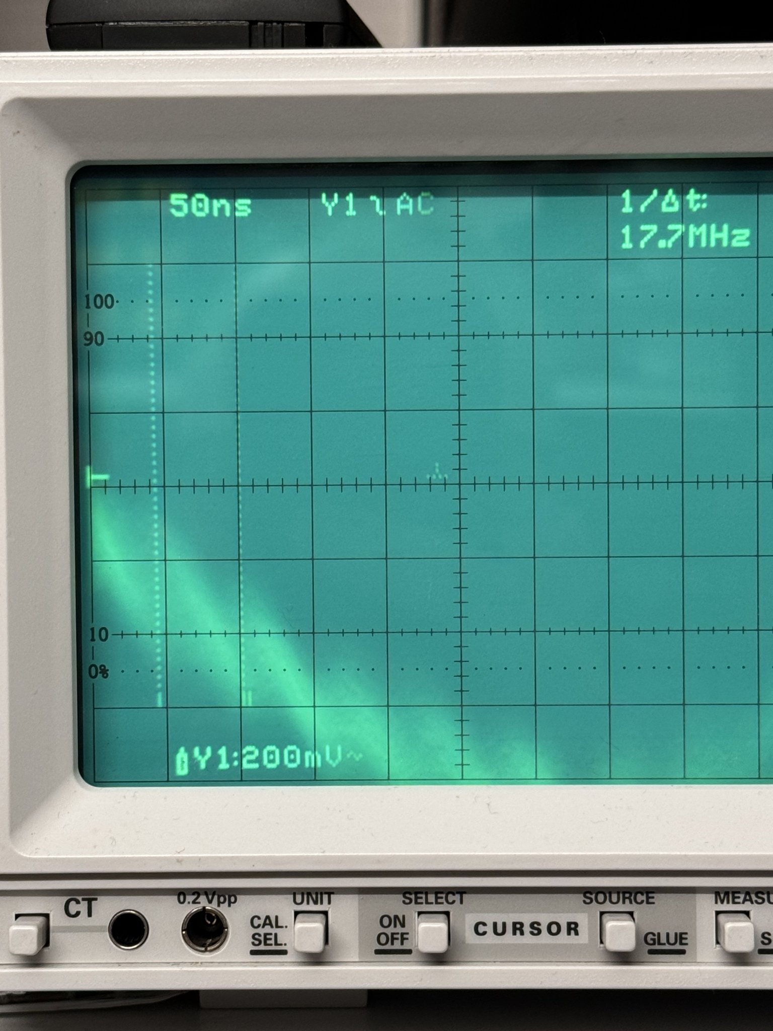

- The eye-pattern has a lot of noise on it. This disappears when I turn up the laser voltage to around 70mV, which is of course no solution. I tried measuring the frequency of the noise and it is somewhere between 15.5 – 17.7 MHz

The included pictures show the noise and my attempt to measure the frequency of the noise.

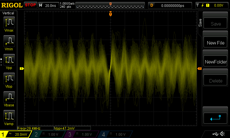

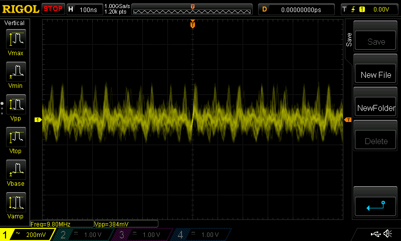

It took me a bit more time to do some proper measurements. In my original measurements i primary checked for a 100Hz ripple on the powerlines and if the LM7xxx regulators are stable. After some extra measurements I noticed that with my digital scope I could see the high frequency noise appearing on all power lines. Even +3 & -3, the +15 and -15 volt lines.

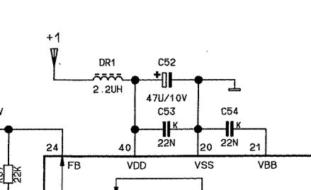

I did some thinking how I could come closer to the source and started measuring the HF noise on all power lines on the different IC’S. Once I measured on pin 40 from the SAA7210 I found out the HF noise measures up to ~850mV peak-peak on that pin. The frequency varies from a few kilohertz up to 45+ MHz. If I measure on the other side of inductor DR1 the noise lowers to ~380mV peak-peak. Pin 40 gets its supply from a 7805, IC 12. If I measure the noise directly on the output of IC12 it’s around 50mV. As this is much lower I’m pretty sure the cause of the noise is somewhere around the SAA7210 or maybe the SAA7210 itself is failing. I can’t find the noise on any of the IC’s other inputs so I’m tempted to replace it unless someone else might have a suggestion.
Noise on pin 40 SAA7210.
Noise on the other side of DR1.
Noise on the output of IC12, LM7805.
Schematic showing the parts around pin 40 of the SAA7210

You have to place the GND of the probe on the right place. It is either pin 20 or the minus leg of C52.
