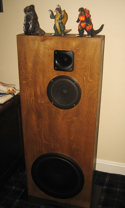

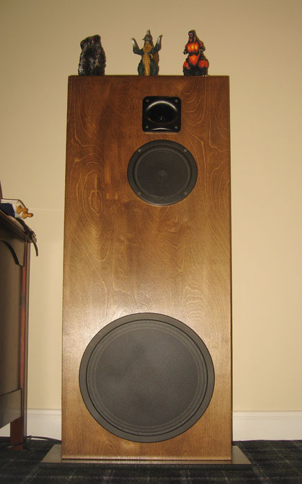

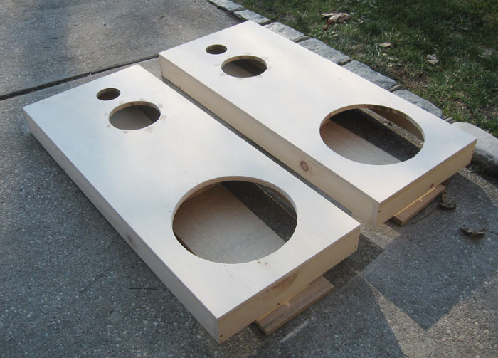

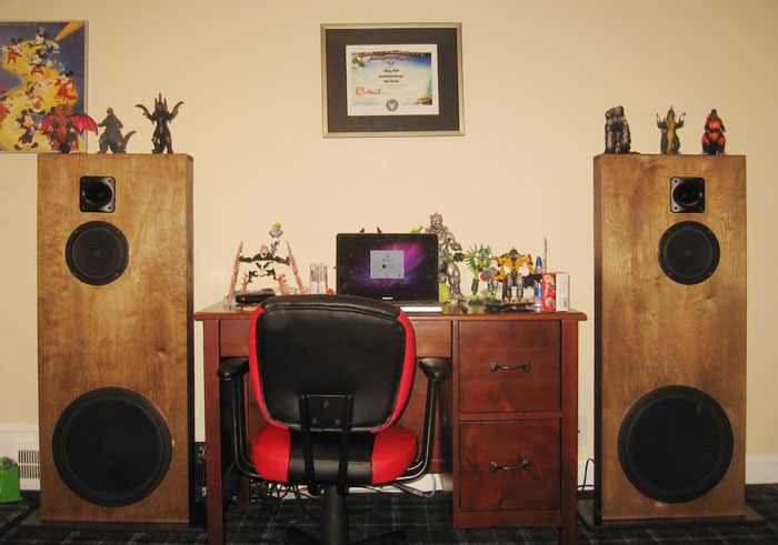

Here's my son's project using the PE buyout 15" woofers on OB along with the Pioneer B20 (also no longer available) and the inexpensive piezo + little Dayton waveguide. The B20 and piezo are powered by a T-amp tucked away in his desk drawer. A cable pops out to connect to his laptop (he usually streams from Grooveshark). The woofers are powered by a Dayton sub amp rated at 100 watts (i think). After wiring it all up we spent about an hour fine tuning the woofers along with the placement of the speakers for best sound. He LOVES the setup! I still get hugs on occasion after his friends leave (he's 13). He tells me the sound is "so good dad."
The sound is pretty darn good. The best part is the bass. It's HUGE. The combination of 15" woofers with a high qts plus a sub amp really allows for tailoring the type of bass you like. The B20 pumps out sound and the tweeter, while not the best... it's spitty for sure and sibilant too... somehow manages to work really well playing classic rock like Queen, Boston and the Cars as well as the new stuff by Lady Gaga and whatever else plays on Z100 FM here in New York.
Just wanted to share. For cheap it reaped many fatherly rewards.

Thanks all! Yup, i have two boys and over the last holiday they asked me to build a pair of speakers for their rooms. I will post the other speaker after taking a few pics. They are much smaller but it was a fun project too. What me and Thorn have done is take inexpensive, but large woofers and simply use them on open baffle speakers. Thanks to MJKs work an entire selection of cheaper woofers can be explored and these really great sounding OB projects can be built. They image really well, the room fills with sound effortlessly. It's not the most impressively smooth, silky sound we love but it's rich and full and makes no excuses for what it is... or how inexpensive and easy it was to build a pair.
Right now i am listening to sealed Beta 12lta's on top of H-frames and love the sound but can't help but feel like i am just listening to not much more than a pro sound speaker... it sounds fantastic but to make it more 'home friendly' i have been playing with Xbaffle to find out how small a baffle i can mount the Beta 12lta and mate it with the H-frames... I want the overall look to be less bulky. So far the sims look pretty good and i should settle on dims later in the week before cutting up wood.
If all works out and i like the sound of the Beta 12lta on open baffle i may build another project similar to my son's even tho the overall bass performance is somewhat better with the H-frames.
