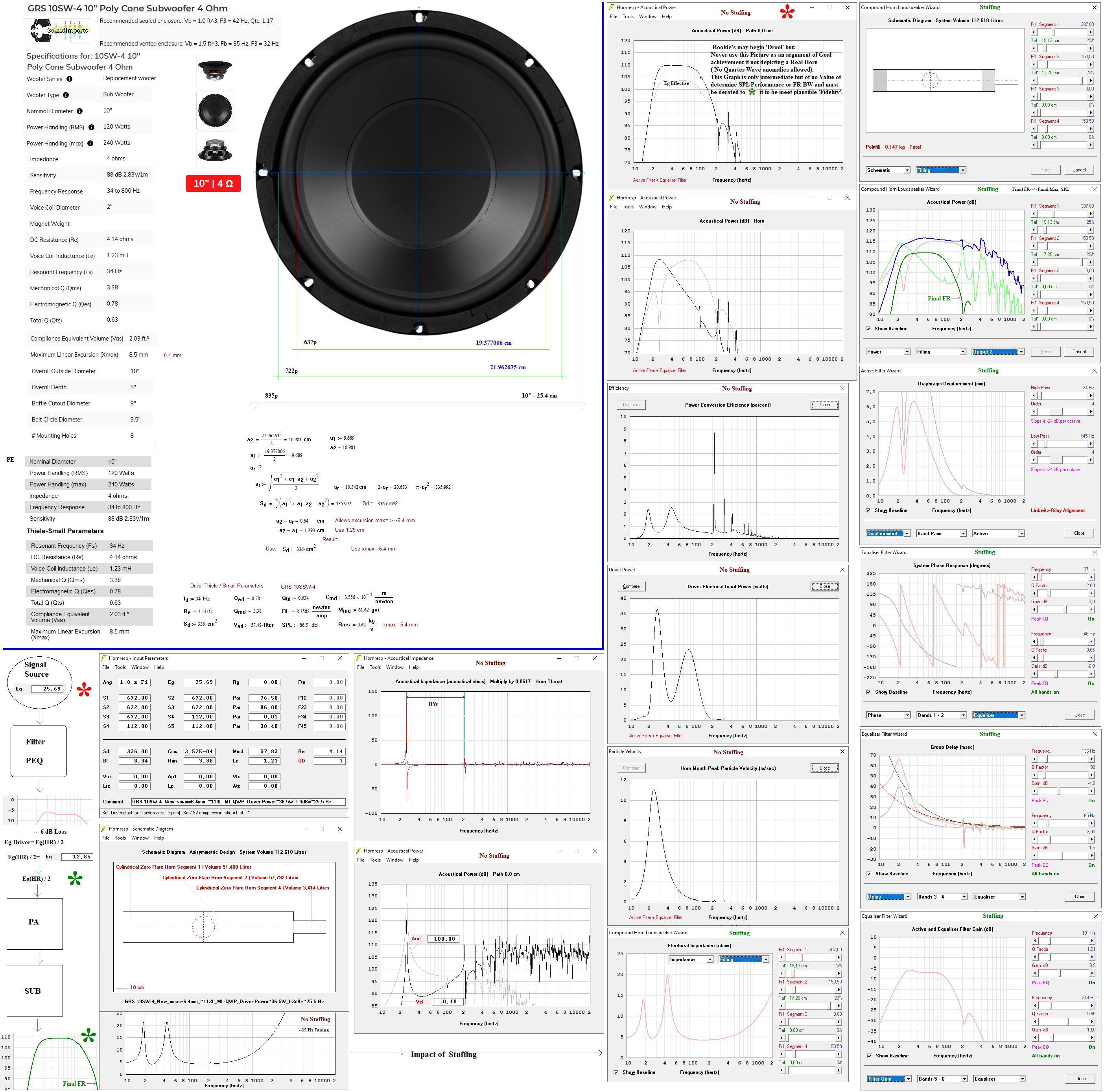

I'm thinking about GRS 8SW-4. But I have no idea if they gonna work in BR enclosure. I have about 2x140 wrms @ 4ohm. I have limited experience with Hornresp, so I can't actually do a proper enclosure build with it.

The GRS 8SW-4 does not work in a vented enclosure, because it has Qts = 0.88. Something around 0.4 is preferable. The Visaton W200S-4 is a good woofer for vented enclosures. You can design such enclosures with WinISD, which is easier to learn than Hornresp.

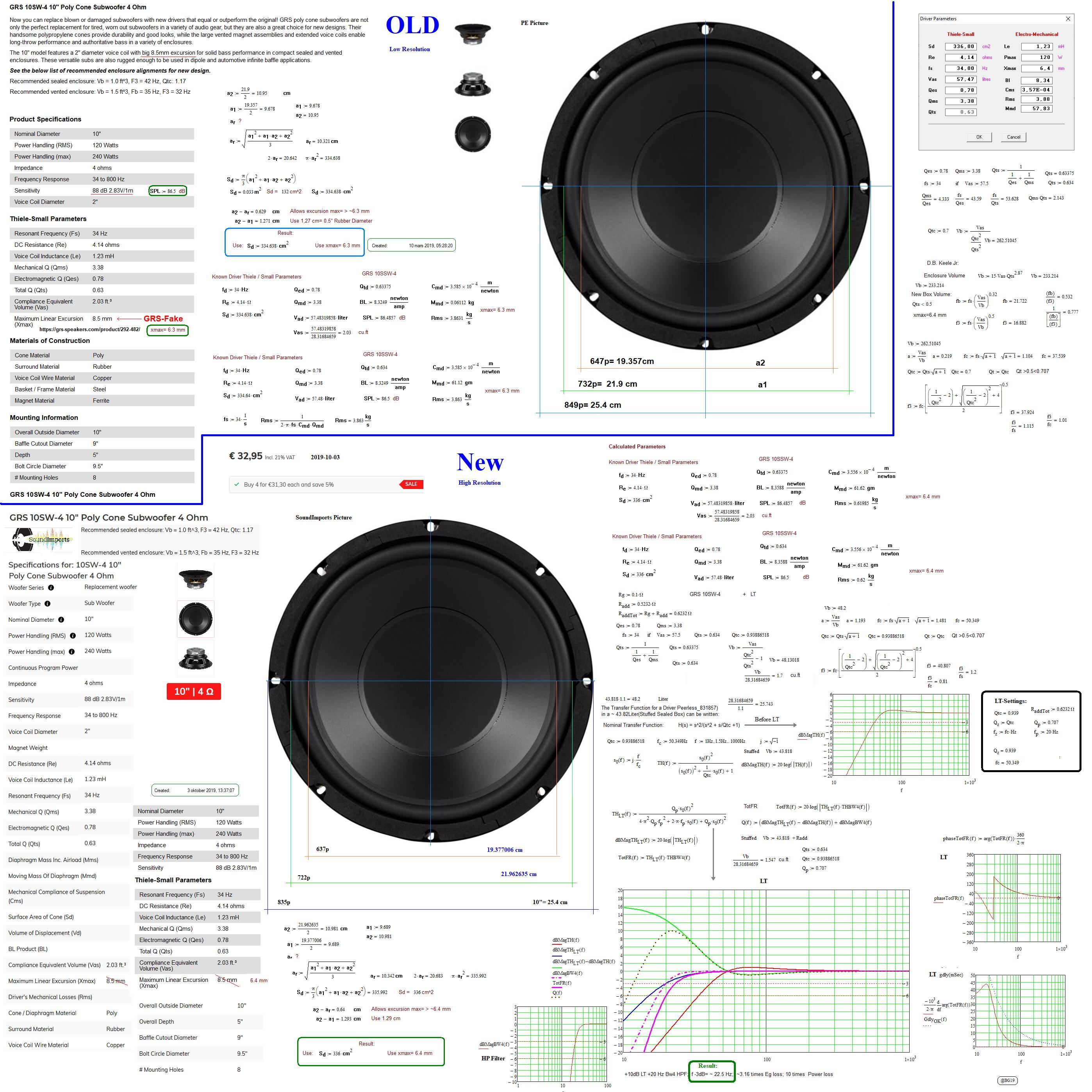

Also building a sub based on Radiotehnika SW-350 case, got few for almost free, now considering putting GRS 10SW-4 there (44L vented box tuned at 35Hz)
