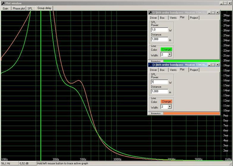

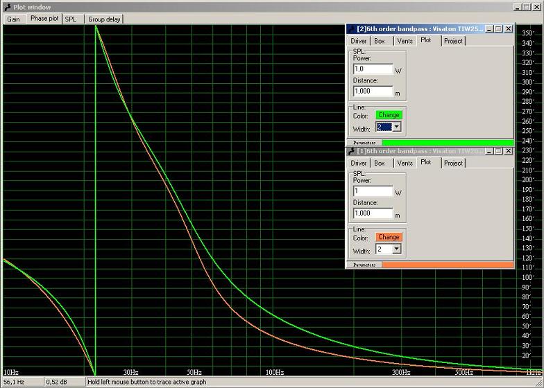

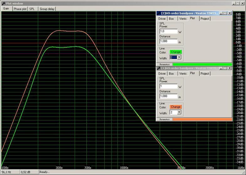

I've been working on a few ideas for a subwoofer. Initially, I wanted to go for a 8" or 10" vented design. But those didn't give me the bass extension I wanted, without becoming incredibly large. Frequency, phase and groupdelay plots were quite smooth. I've also experimented with two 6th order bandpass designs. Those give me useable bandwith (25Hz - 60Hz) at decent spl levels, especially with an 8" Visaton TIW200XS driver. However, Groupdelay and Phase plots go off the charts. I can't imagine that's good for perfomance. I'm not exactly sure what groupdelay means, so if someone could explain it in a nutshell, I'd be greatful. But I imagine a lower value means faster response and better articulation. My dynaudio's are pretty fast in the low end, so if the sub is to integrate well, it should be fast aswell. Right?
Please take a look at the pictures below. Comments are greatly appreciated. I'd like to know things like how do bandpass designs compare to vented designs. Things about performance in general, etc.

Group-delay is the delay of the specific frequency with respect to the original, so longer delay is worse. Bear in mind that the plot you are looking at appears worse than it is because it is including the low-pass element of the system, which is often not modelled when looking at more traditional box designs.
Unless you are going for most bang per buck though I would look at a better larger driver in a sealed or reflex box and a bigger amp. Also be aware that if your only connection option is the LFE signal then a bandpass design is not suitable because the LFE signal is already filtered.

With bandpass designs you remove a great deal of the flexibility
of the upper crossover point built into most plate amplifiers.
Compared to a simple sealed or vented design you need extra
volume for the bandpass cavity - its main advantage is it gives
high power handling around the upper cutoff.
However investigating the excursion limited power handling of
normal sealed or vented boxes shows that at the upper cutoff
frequency there is excursion to spare, more is not needed.
Generally excursion limits are reached at the low end of the sub.
Also note that the phase and group delay characteristics
of a sealed or vented sub + plate amplifier 2nd order roll-off
at one setting can look very much like a bandpass design.

The difference is about 4.5 dB. That means I need almost twice the watts to get the same spl from the sub? Doesn't seem like an ideal situation. Although I see a lot of subwoofer suitable drivers (long excursion) with low effeciency. Do you know of such drivers with higher efficiency? Somewhere near 90 dB/W/m? Do I need to look at high excursion drivers at all?
