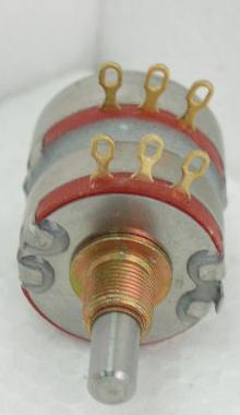

I thought I would post this here since a lot of you use pots with you chip amps. I am trying to organize a group buy for the new PEC pots that Peter Dainel so highly recommended ( found *HERE* ).
There is one place I found that sells them for $50 + $7 for shipping ( found *HERE* ).
So far I'm looking at a stereo pot, 10% precision, 10K ohms, log taper, SS shaft & case, with gold plated terminals. We need to get 30 for the price to be ~ $37. Shipping ~ $5 which = about a $15 savings. If we could get 50 or 100, the price will be even lower!
Let me know what you guys think as well as any suggestions. I may also be able to break up the order such as 15 x 10K pots, 10 x 20K pots, & 5 x 50K pots... you get the idea 🙂

I tried 25K log and it worked fine with GC amp. I have no experience with linear pots and law faking resistors. I'm also scared by high series resistance in such applications.
Why not mono pots
I switched to PEC pots a little while back. I bought 5 25K mono log pots at 9 something each. Was able to match 2 exactly, and two more at 100 hms, which is 0.4 %. The two used seem track perfectly.
I really wanted some 50K stereo log pots to parallel to make a 25K mono pot. The the mono pots seem to work fine. I think to get a good match it will require purchasing a handfull of stereo to get 1% match.
As a side, the taper on these is different than others tried. It is much more gradual on the low end. It is the exact opposite to the normal hair trigger pot. But once past about half way open the volume comes up fast.

To Peter which of is better
Hi Peter,
which one of the 25K log and 50K log is better? On Brian's GC, as a passive...
also when you try pot (both pot cases), did you remove/unremove the 20K/22K (R2) shunt resistor?
Off topic, I found that on the schematic (as on Brian's nigc_kit-users_guide.pdf) the R2 is placed (shunted to the ground) in front of R1 (grid stopper? as in tube amp design to reduce oscillation?) while on the board, I found that R2 is placed after the R1. Is there any reason for this?

I believe there is a mistake in a schematic, as the shunt resistor is preferred to be after the series resistor.
25k version is better choice for GC. I still use 22k shunt Caddock, as it sounds better to me this way.
I guess so. I'm using 22k as I have a stock of them. If you worried about low input resistance you might go higher with shunt resistor (50k or so) or not use it at all. Initially, I didn't use it, but preferred the sound when shunt was installed back in.
thanks then... Peter...
maybe I should hunt for available various cheap pots locally and try the combinations by myself before change it with a serious one... like PEC
(I say "hunt" because in Indonesia, DIY-ing is very uncommon. It is very difficult to find linear pots and pots of smaller values like 10K or 25K. Even toroids, I have to buy from Singapore...)

KT- "I'm not sure about the spec of the stock pots, but looks like Brian Cherry may have specced tighter tracking tolerance on the ones he's selling."
Where are the ones Brian Cherry has for sale? I think PEC only specs 10% & 20% ones.
Peter-"When I called PEC, they quoted me $80 for a single pot and something like $40 for 10 pcs."
That's exactly where I got the price for 30 pieces. I thought it wasn't bad compared to the $50 ones but after looking at some other sites I would think it would be better.
dw1narso-"what about other value?"
I can get others as well. Let me know what # values.
Panelhead - That point has been brought up about buying mono pots from Digi-Key since they are ~$10 & matching them but you found out 1st hand the down side to that 🙂
Peter - Do you think the 25K would be better for the GC's?
Thanks guys & I'll keep checking on them!!! 🙂

You mean 25k vs 10K? It's hard to say, some recommend 10k or even less. But I prefer a bit higher input resistance (especially if the pot is in parallel with 22k shunt resistor). Would be interesting to compare though.
Cdoggy,
Brian Cherry sells them at DIY HiFi Supply:
http://www.diyhifisupply.com/diyhs_dact_switches.htm
Here is Brian's quote about the tolerence. This is what I was referring to:
"These are specially ordered with 10% tolerance (standard tolerance is 20%)."
Does someone sell them stock with 10% tolerance? Looks like Electrosonic does from the links Peter provided.
If a group order is put together, I'd be interested in the 25k and 100k log pots. If any 1 meg linear tapers are ordered, I'd be interested in that, too.
Electrosonic seems to have the best prices. The KK pots are stereo?
