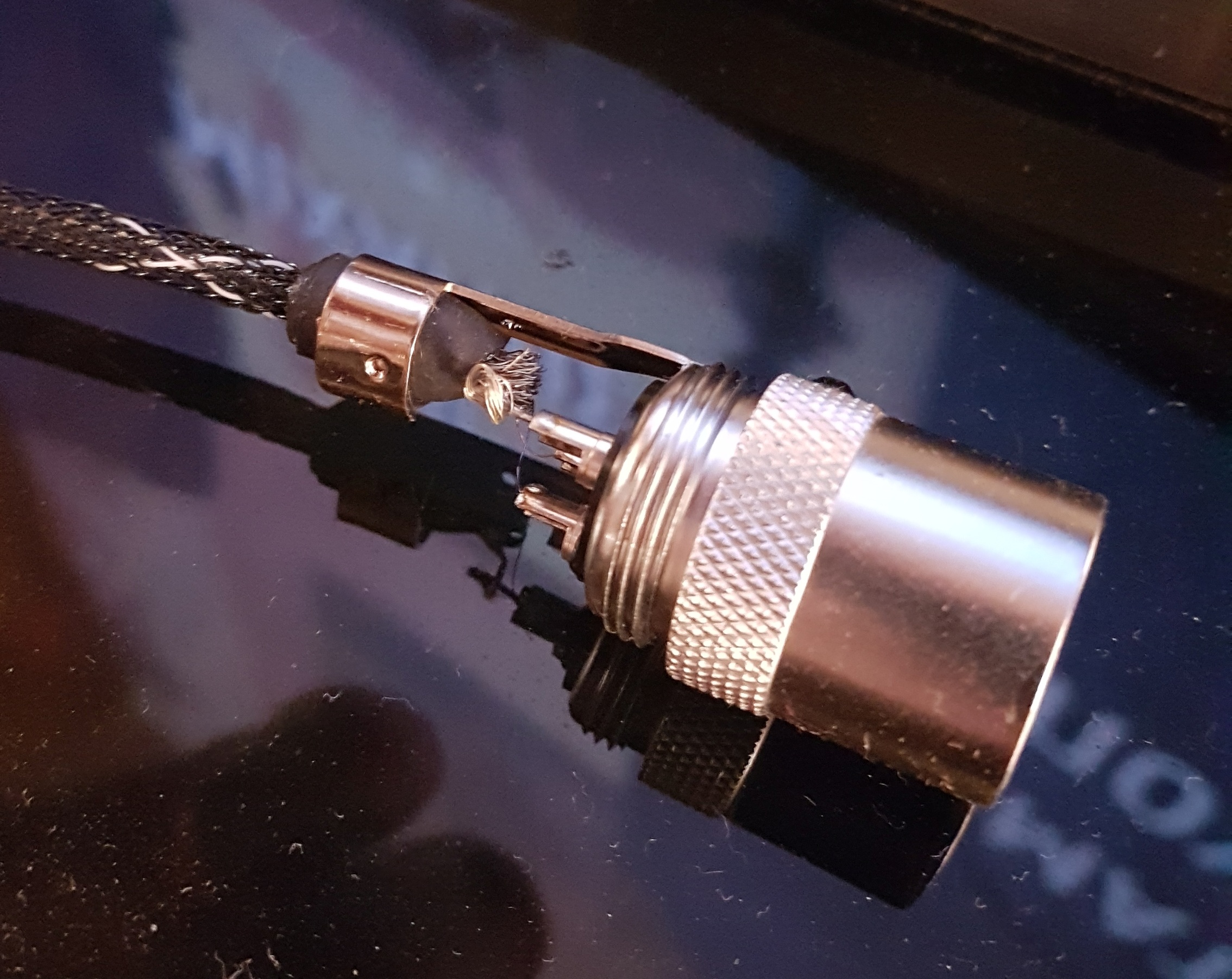

There is no grounding cable because the tonearm wiring was custom made for me by the manufacturer.
I can see in this photo that two super thin wires connect the two cartridge pins to the two XLR connector pins, and the cable shielding connects to the third XLR pin.
Is this a proper grounding cable, meaning if I extend it with a longer cable and lug it will play the part of a common GND tonearm cable?

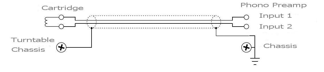

When using the connection below, the left part of your cable can stay what it is now and on the right side input 1&2 are terminated with an RCA plug, while the cable shield is separately connected to the chassis of your Phono Stage.

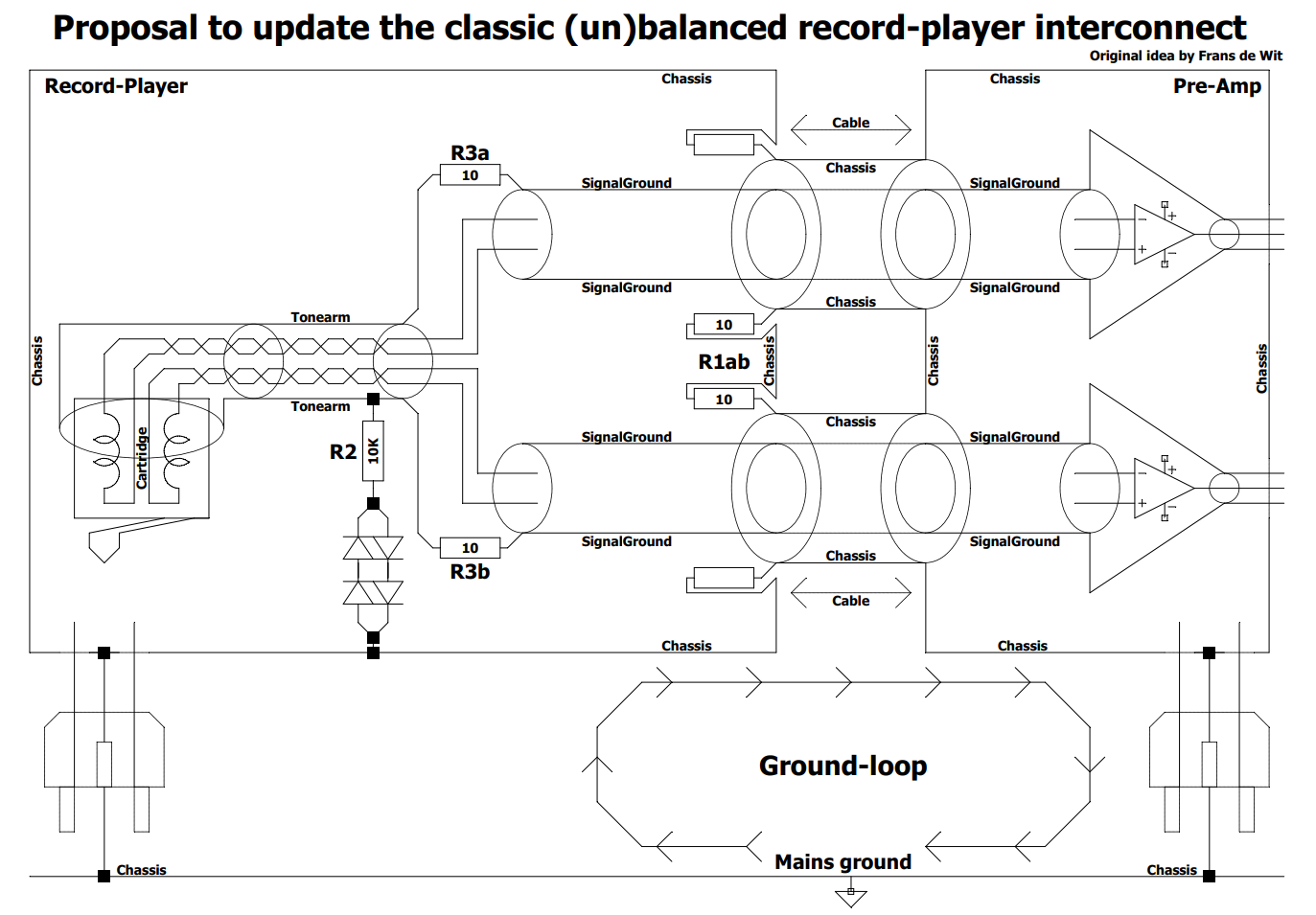

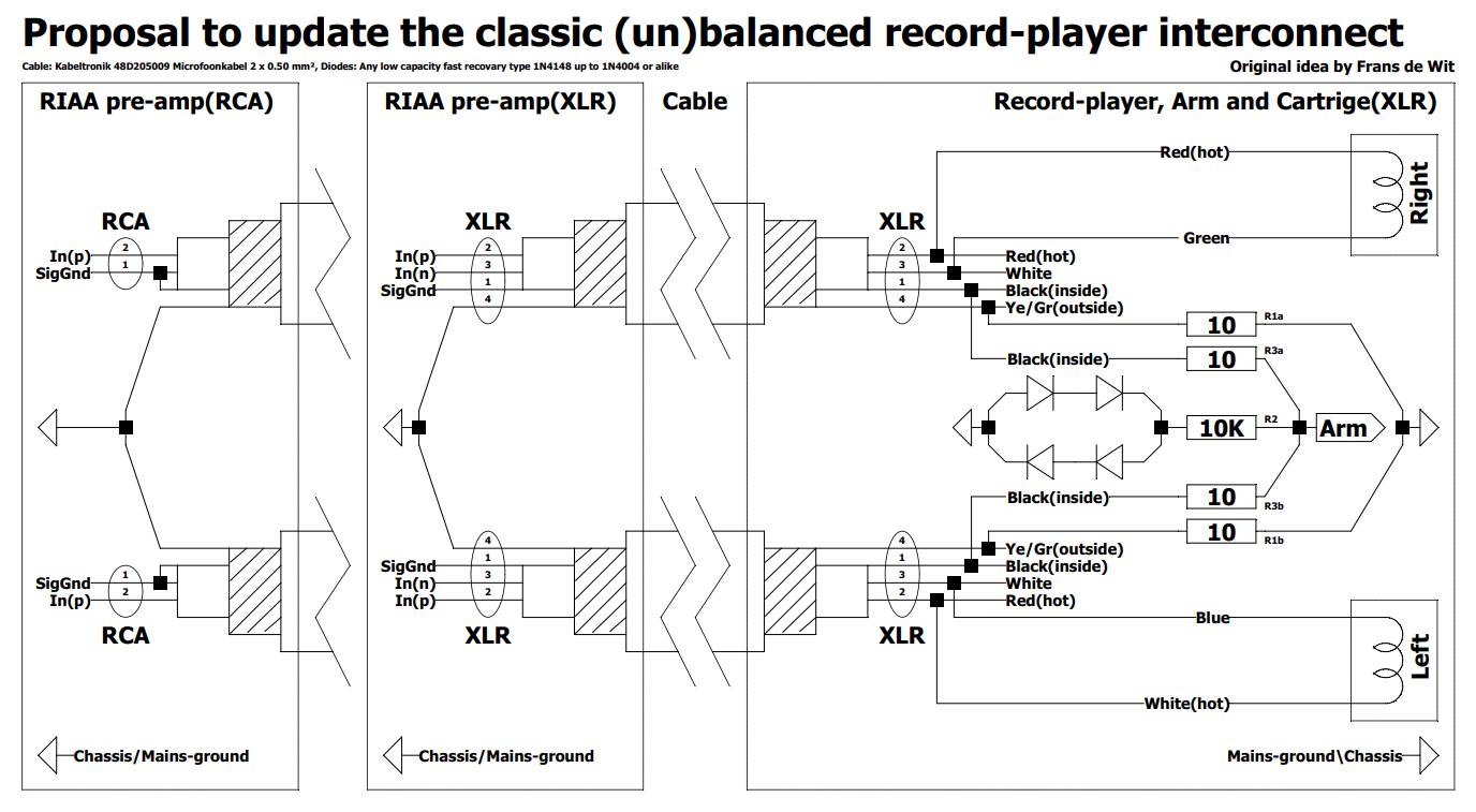

As some know (Calvin 🙂) I am always capable of changing a simple subject into a complicated (seemingly IMHO) solution. Here I donate my latest's record-tonearm-and-plyer cabling solution to the public domain, have fun with it, and lets here about it 🙂

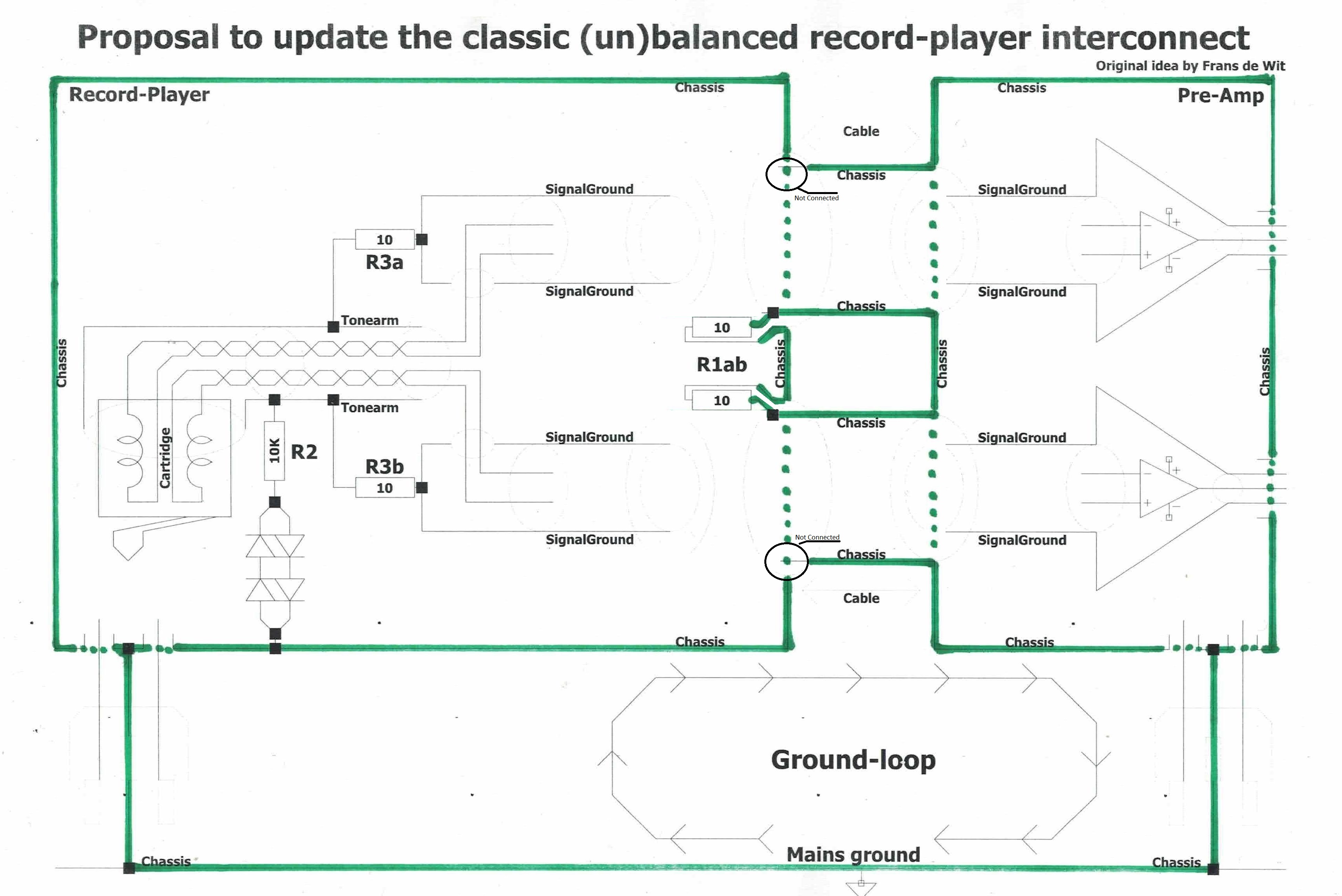

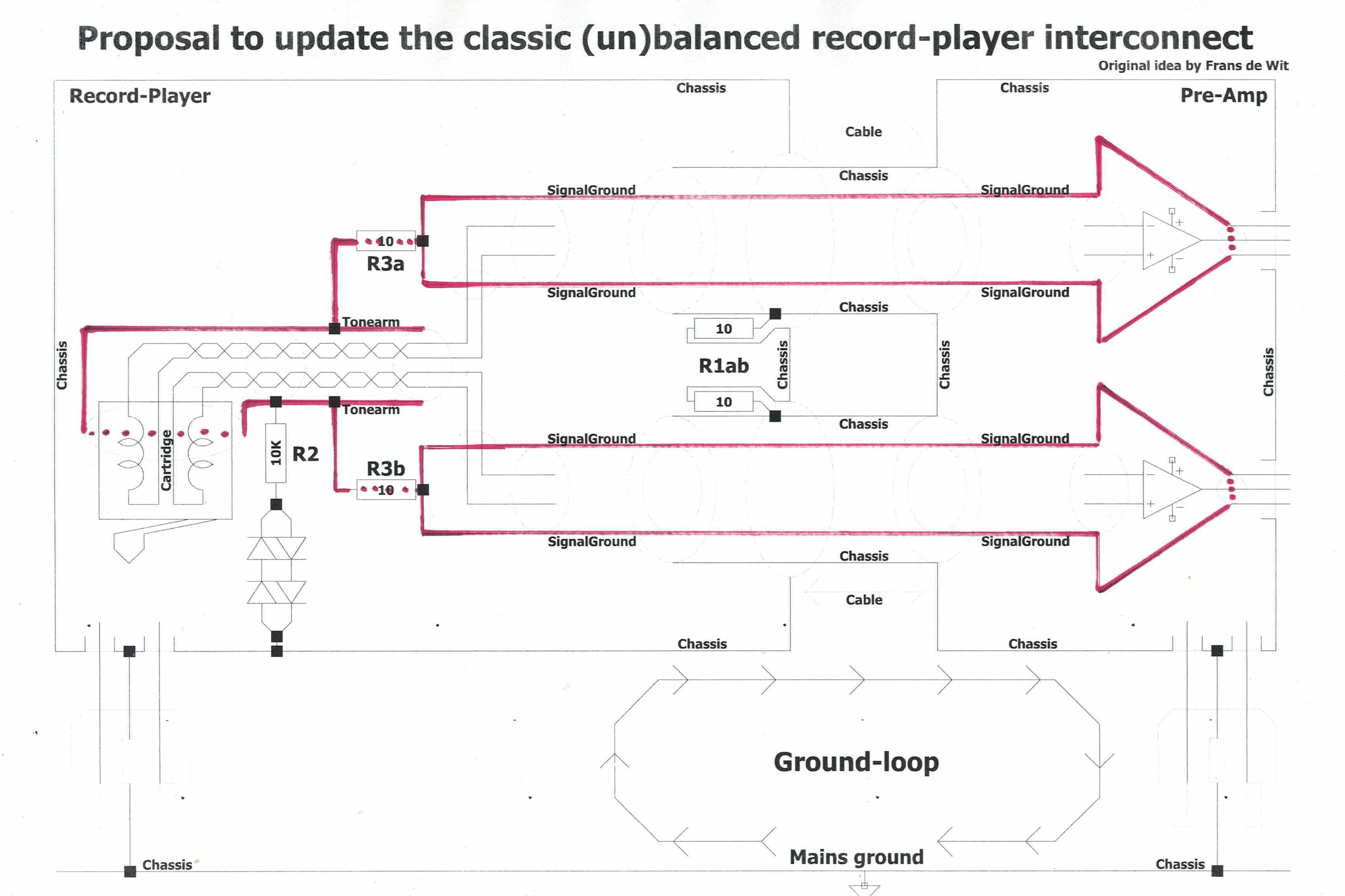

Drawings are: 1> Schema, 2> Implementation (sort of), 3> outer (chassis) ground high lighted (green) and 4> inner (audio) ground high light (red).
P.S. R2 and the diodes are 'not there', the impedance of these is so high (compared to the other ground connections) that there is no way for them to carry any (practical or un-practical) current. The purpose of R2 and the diodes is to prevent any static buildup in the tone arm (or dielectric dielectric charging of any of the materials in use) when the system is disconnected.
P.P.S. I agree with Calvin who agrees with dd on agreeing with Hans 😉
Frans.
Frans.

Draft23; Zion; Cable system; Mech view outer ground.jpg620.6 KB · Views: 955
Draft23; Zion; Cable system; Mech view inner(signal) ground.jpg379.5 KB · Views: 531

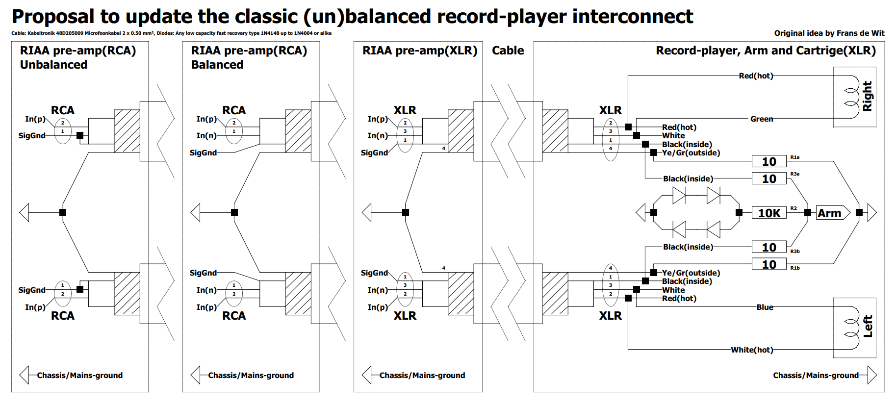

To my taste overly complicated.And (for completeness) the schema updated with balanced-RCA.
1) Better not to separately connect the TT chassis to the mains ground, since the preamp is already connected to mains ground transfering this connection to the TT Chassis.
A double connection may potentially create an unwanted ground loop and is not solving any other problem.
2) Connecting the arm to the signal gnd can be done, but only when it does not have a connection to the chassis and only when a signal gnd is available from the preamp.
But I see no advantage over having the arm connected to the TT chassis.
3) to connect the signal gnd to the mains gnd in the TT is another loop being created, because the signal gnd is already connected to the mains gnd somewhere in the Pre Amp.
4) in case of a balanced RCA Pre Amp, there is likely no signal gnd available, causing the the arm to float with this setup, just another reason to connect the arm to the TT Chassis.
So my advice would be to connect the arm to the TT chassis if not already done by the manufacturer, and let the Mains Gnd come from the Preamp chassis.
Hans
Its not that complicated, only a few resistors and diodes. What you get in return is a universal connection system that supports balanced and un-balanced while providing a good shield against HF pollutions (like phone and wifi signals). Also the schema will function with mains-grounded record-players and non mains grounded record players. It can satisfy doubly isolated and single isolated standards in one cabling system.
1) Better not to separately connect the TT chassis to the mains ground, since the preamp is already connected to mains ground transfering this connection to the TT Chassis. A double connection may potentially create an unwanted ground loop and is not solving any other problem.
Witch is not done, the ground-loop is broken by the 10 Ohm resistors. But the connection to mains ground is unbroken.
2) Connecting the arm to the signal gnd can be done, but only when it does not have a connection to the chassis and only when a signal gnd is available from the preamp. But I see no advantage over having the arm connected to the TT chassis.
The arm is not connected to ground, only if a static charge (om the arm) is larger than 2 x Vka(diode), this is (must be seen as) normally not-connected.
This is not done, the arm is not connected to ground (it es actually part of the shielding system).
4) in case of a balanced RCA Pre Amp, there is likely no signal gnd available, causing the the arm to float with this setup, just another reason to connect the arm to the TT Chassis. So my advice would be to connect the arm to the TT chassis if not already done by the manufacturer, and let the Mains Gnd come from the Preamp chassis.
No floating of the arm (except when the balanced RIAA input is a transformer with no center tap), otherwise the input network should/will provide some path to signal ground.
... and let the Mains Gnd come from the Preamp chassis.
How would you do that while guarantying (mains wiring) standards?
