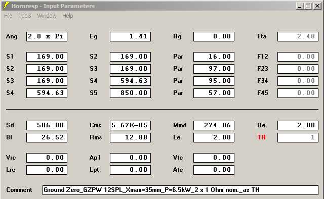

I'm rying to design a low tuned box for two of these SPL brutes, to fit in a car(!):
http://www.gz-usa.com/subwoofers/31/...1256021130.pdf
I've 4.635cf gross space to play with, but am having a devil of a time getting an enclosure
to play low and not have port noise
/have a port that fits in the box. At present the customer has one sub and a 4000wrms amp
, though he wants to add another sub and amp-so up to 8000wrms on tap.
With an 8x8" "slot port" I'm ending up with a port length of 40" and still getting port noise with 4000w, up it to 8000w and it will be whistling like Fred Astaire.
The guy wants this for street bass and I've recommended he goes for different subs, but having invested £600+ in this one he doesn't want to shift product
The "recommended" enclosure for these is 1.75cf gross volume
with two 4" ID ports 9.84" long-but that will chuff off just under 300wrms according to BBpro-which to me says the box/vents are massively too small or GZ presume you'd only use this for SPL and not care about the extra noise from the port?
Am I wasting my time with attempts at a low tune?
Does anyone have any more TS spec for these? I have WT3, but the guy is a 4hr drive away and I don't paid enough for that drive!
Any info/help much appreciated
Calculated Vs spec'd eff. implies very high inductance, hence the high tuning to get a ~flat response initially, so all things considered; building the largest sealed cab that will fit and EQing it to suit seems the only reasonable option.
GM
When you put the T/S parameters into Hornresp it sure looks like those are not the correct parameters. On the ground-zero-audio.com site the recommended box is: "80 Liter/2.82cu.ft. - Rohr/Tube 1 x Dia. 16cm/6.3" - L=25cm/10" ", and it also says: Box recommendation sealed not recommended. If the parameters were correct a tapped horn (with quite bumpy response) would work in the volume you have available, but until you get actual T/S parameters GM's recommendation in Post #2 is the best way to go.
Alas, those are the only spec's they provide🙁
I'll model the recommended enlosure on the sub page-they recommend smaller in the manual.
Oliver-big ask coming-could you do a rough outline of a tapped horn that might work? As you know I'm still trying to keep my head above water with HR!
Take those T/S parameters with a heavy dose of salt 🙂...... gotta run...
