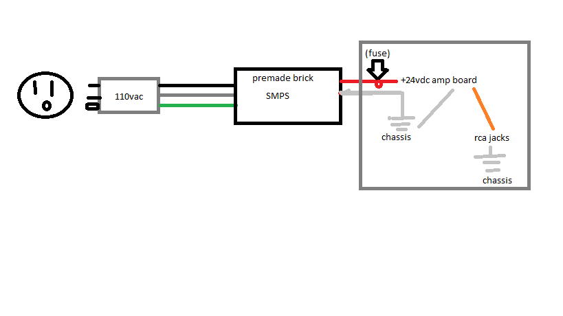

Question on this though.. This is being powered by a wall wart / brick style premanufactured 24vdc smps supply. The AC side of the brick has a earth pin for the wall, which will obviously be used, but the dc out cable to it's typical dc wall wart style barrel plug is only +DC and -(GND). How can I tie the chassis to PE when it doesn't exist?
I intend to connect the DC GND to the chassis as if it was a PE line, and star the board and all components from there. I will not isolate rca barrels from the chassis if it is unsafe. Is this not correct?
So like this? (forgive the kindergarten level drawing..)
The only thing I was going to do different was take the (-) of the rca jacks back to the board, isolated from the chassis at their mounting point, as the (-) (dc gnd) on the board will still be tied to the chassis, along with all other dc gnds.
Your bit of equipment is not mains powered. You have used a piece of manufactured equipment that gives you an isolated low voltage supply. Your piece of equipment is powered by a "deemed to be safe" LV supply.........Question on this though.. This is being powered by a wall wart / brick style premanufactured 24vdc smps supply. The AC side of the brick has a earth pin for the wall, which will obviously be used, but the dc out cable to it's typical dc wall wart style barrel plug is only +DC and -(GND). How can I tie the chassis to PE when it doesn't exist?............
Your equipment does not need a Mains PE connection, if it is not connected to the Mains Power.
Now to the exposed Metal parts on mains powered equipment.
These are usually part of another circuit or knobs & screws.
The circuit parts must remain part of the circuit. Get the audio circuit working, that means isolated from the Chassis.
Then look for a method of complying with the safety requirement.
I use the Main Audio Ground (MAG) as my sole link to the Chassis and thence to PE. That one link ties in all the other Grounds and Returns that take a reference from the MAG. But with one important proviso. All the subsidiary links must, if exposed to Fault Current, be capable of passing that Fault Current until after the Mains Fuse has ruptured and the arc extinguished.
So I am understanding correctly, the DC gnd from the SMPS is the same as the MAG, as it is shared with the same plane, so find one point to tie the audio grounds and dc ground to the chassis, and ensure all ties to this point are heavy enough to last longer than the fuse, correct?
