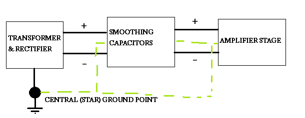

Hi
I think this is proper thread for my problem so I am posting it here.
So, I am bulding an amplifer which works, but i have a small problem with ground loops (buzz and hum). Well the problem was with no proper grounding so i decided to redesign a new grounding with central point. But there is one thing, which puts me in dilemma. I don't know exactly how to ground an amplifier to a ground point. Shoud I connect my amplifier stage directly to a cental ground or sholud I connect it through the "smoothing (capacitor)" module? I think this is not a difficult question for you guys. So what do you think?
There is a picture bellow, which illustrates what i mean.😉
Maybe I could shed some light on the subject as the sound is described as a hum/buzz. This is not necessarily a ground loop but it could very well be introduced by a offset in power supply ground.
A very common occurrence is that there is a potential difference between two or more pieces of equipment grounds. Even a very small voltage would be amplified by your amplifier in the same way that a valid signal is amplified.
This is a very common problem between PC and equipment as a PC power supply can be several volts different from the "0V" reference of you amp.
There are several ways to solve this and many uses a resistance of low value in the input ground. Another way is to decouple the transformer center tap from the rest of the system also through a small vale resistor, and of course my favorite the virtual ground.
