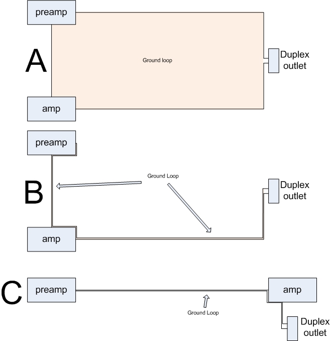

This thread is the beginning of a discussion on what ground loops are and how to avoid them. The three areas to be discussed will be the external environment, the internal, and later, how to force ground currents as well as measure them.. While centered on grounding and hum/noise, the concepts are fully applicable to the actual wiring within the components.
I hope everybody chips in, it should be a good learning experience for all.
I've posted a pic of three different system configurations. The assumption is 3 prong NEC type units. (two prong applies as well, but the freq response profile will be different, dependent on the impedance to chassis..)
A. This is the typical home setup. The user buys a source and an amp...connects em together with one or two IC,s then runs with it. Notice the ground loop. Any magnetic flux that goes through that loop will create a voltage (current) around that loop. If it's the romex in the wall, oh well.. If an appliance, motor, dimmer circuit goes near that loop, it will make current flow within the ground loop.
It is not obvious how to make either component impervious to that ground current. But nonetheless, current will flow through them. If they are not designed to pass that current without creating magnetic fields inside the chassis, then it will come out in the wash as non-music..
B. This is the same setup, but the pre cord has been moved to wrap around first the IC's, then the amp line cord. Notice that the big loop "antennae" is now missing. If the cords are twisted well, there is nothing an external device can do to generate ground currents in this setup.
C. This is a small varient of B, one I used for a 450 seat venue. I ran a 100 foot extension cord from the stage to the pre/mixer, and wrapped the single ended stereo pair around that cord. Both amp and pre were using the same outlet strip. This prevented the house lights dimmers, AC unit, everything external, from putting any noise into the system.
Note that both B and C are basically limited to 15 or 20 amps worth of equipment. If one requires more, a dedicated group of outlets with one common ground from the outlets back to the breaker panel is needed...one ground only. More than one ground will setup a huge loop to the service panel.
Option B or C will reduce significantly, most hum issues in the home. (not cable, that is a different nut...)
But neither will address well, currents formed by the guts of the equipment. This includes 60 hz, odd harmonics from the line side of the bridge rectifier, even harmonics from the load side of the bridge, nor actual musical content magfield generation on the supply rails back to the line. That's stuff to play with farther down the thread.

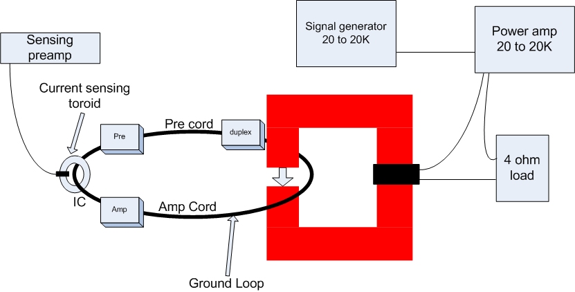

Here's the test setup.
I have the toroid for the current sense pickup, it's a secondary core from an old ATX supply, so it'll definitely have the bandwidth. Center hole is .550 inches, so I figure it'll take most rca's.
Gonna have to wind some copper through that puppy, see what I need to view 20 to 20K down to about 10 microamps. It'll probably require several different windings to do that sensitive at such a range..and I'll have to pickup some kinda preamp circuit also.
Don't know what to use for the drive core yet, I'm scrounging up. I was thinking of cutting one of my plitron 225 va toroids in half, I have eight more..
My intent is to use the drive core also as a test for ground loop susceptibility over the entire audio range....I'll have the amp on, the pre on but not playing anything, and then bring the drive toroid around the line cord slowly...gotta be careful of course, in case the amp is really susceptible..
Cheers, John

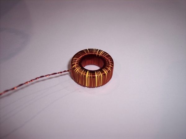

Made a first pass at the current viewing toroid. As I said, it is from an old ATX supply, I wound it fully with #26 magnet wire, it took 87 turns to fill the toroid bore.
Measured the inductance from 20 hz out to a meg, but 500 k and one meg didn't make the meter very happy, so I removed those data points.
Toroid OD is .90, ID is .55, thickness is .370, material unknown.
Has an inner clearance ID of .50 now, so rca's and wires bigger than that are out..

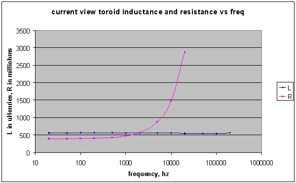

Here's the inductance and resistance plotted.. I left out the resistances above 50k to keep the scale. 50K was 8.8 ohms, 100K 27.3 ohms, 200K 110.3 ohms.
Next, I'm gonna stick a wire through it, measure the voltage produced with a scope, from 2 hz and 4 A peak, to 1Khz and whatever the supply can give...
Cheers, John
Cheers, John
Those yellow toroids are usually something similar to micrometals #26 iron powder material. They have pretty low permeability and high losses.

Ah thanks, I'll hafta do the equations to see the actual permeability.
Losses are interesting..luckily, I'm not going to push the core, as it's just low level signal application. The inductance meter was running about 10 milliamps.
I'm just happy that the thing was totally flat inductance wise across the audio band and out to 200 Khz...I'm working with some big iron laminated magnets, they drop 8.5% from 20 hz to 2 Khz. they have .5mm thick laminations.
