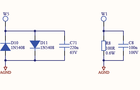

almost any MI amplifier that is available commercially uses it's chassis as signal ground. Commonly all input and output jacks are mounted directly to the chassis, without isolation. The chassis is earthed through the PE lead. If we connect an external unit that also is earthed to the FX loop (if present), we'll inavoidably have a ground loop.
To cure this issue, I'd still connect the chassis to PE, but isolate signal ground from it via a ground loop breaker (big rectifier bridge with 100 nF across). Are there any (mainly safety) caveats against this idea?

Unless very poor design all have their own ground path for the circuit itself, and it´s connected at only one point to chassis and safety ground.
No, for decades now.Commonly all input and output jacks are mounted directly to the chassis, without isolation.
Yes.The chassis is earthed through the PE lead. If we connect an external unit that also is earthed to the FX loop (if present), we'll inavoidably have a ground loop.
Just one variation on what Marshall does.To cure this issue, I'd still connect the chassis to PE, but isolate signal ground from it via a ground loop breaker (big rectifier bridge with 100 nF across). Are there any (mainly safety) caveats against this idea?
Many use something similar.
You are real close 🙂

Marshall plan looks like it's optimally optimised for mass production.
Elliot's plan with a 30A brick bridge looks better for a DIYer - and can be soldered PTP onto the bridge leads (or fastons; even better) and then screwed onto the chassis, neatly.
I’m not in favor of “GROUND LIFT” as it is a deadly disaster in the making.
Fix the problem and keep the “SHOCK HAZZARD” safety fully working.
First find the real problem and apply a safe solution.
