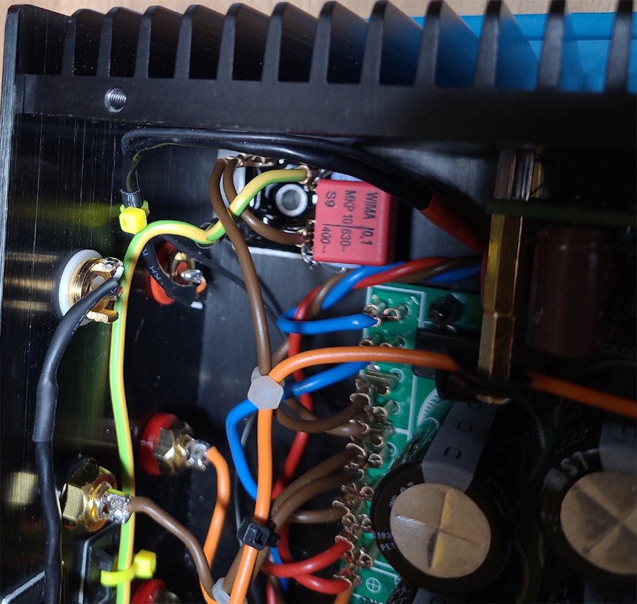

First picture of amplifier layout:
Normally I build dual transformer/dual psu units. This time I decided to reduce cost and used one 600VA toroid. I have tried some different layouts of wiring, but same result.
1. With nothing connected to inputs the amplifier is absolutely silent.
2. With inputs connected together with cable - each to other, the amplifier is absolutelly silent
3. With inputs connected to source there is noise - bzzzzz. Source is Marantz amplifier with preouts - no issues with other amps.
I tried to change grounds from connector to just one point, a screw in the picture on top of capacitors, same problem.
Tried ground lift with greatz, same problem.
The solving of problem was removing the connection from common ground (the green yellow) to the eart point on top near the big resistor, where the chasis is grounded. You can see now the wire on top of the screw of common ground. If I connect this to chasis earthing point there is noise. On other amplifiers, without this wire I had noise, with this one the oposite.
What is the cause of this and can I just leave it like this. The chasis is grounded to the mains jack, but the amplifier 0V -ground is NOT.

I know this document. And my amplifier has a hum breaking resistor of 10 ohm
That should solve the ground loop issues. I have an AV receiver that breaks out multi channels into multiple amps. No hum at the listening position at least. This is the only solution that solves the ground loop for me.

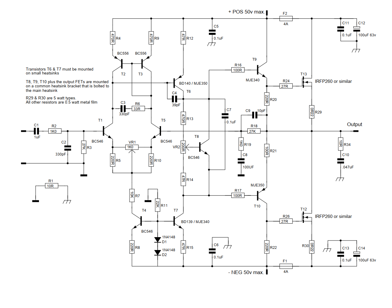

Besides ground loop, another common issue is RF interference is got demodulated at PN juction of the input transistors. That will also cause noise. Putting a RC filter at the input of the amp is highly recommended.
If i take a look to the picture i can see 2 different PE connections (or is one connection hidden under the plate ?). Its better to choose only one point for PE connecting the chassis .
You have built a starpoint with PE directly connected. In my oppinion it is better to use a loop breaker. https://sound-au.com/earthing.htm post 9. You can try a 10 ohm 5 watt resistor first.
Another try is to use little wires to connect the input hbr, signalground, with the starpoint. Perhaps you get hum with a potential difference at rca (perhaps.... the rca connection is very short, fine ). Make sure that your RG 10 ohm is set right.
You have drilled the speaker output together with the power wires. I would not do so...drilling is good, but i try to seperate...

Ground/earth from power jack is connected to chasis.
This is the only point of conecting of chasis to ground/earth.
The 0V of power supply is now not connected to this point and everything is perfect and silent.
I have tried other wirings, also not together speaker to power, dirrect signal gound to starpoint ecc.
I will leave it like this now. Seems to be Ok. The chasis is grounded, this is important for safety reasons.
