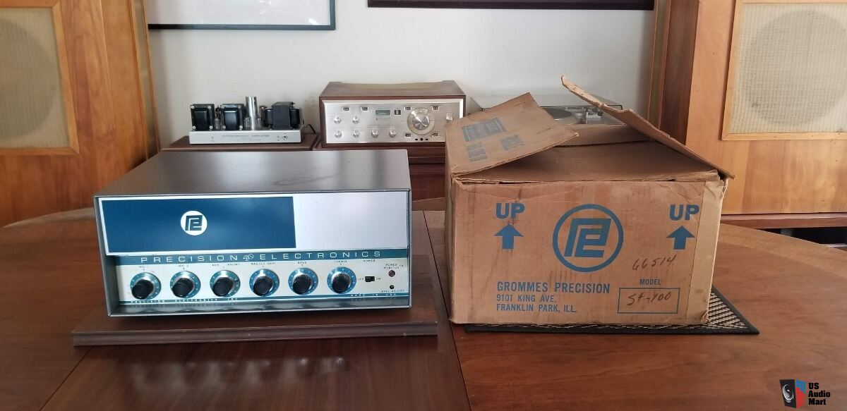

Interested in applications of 6GT5 sweep tubes for PP audio amp design...
Not a whole lot out there- far as history of usage. Pic below shows what seems to be rare example-
Grommes Precision S-100

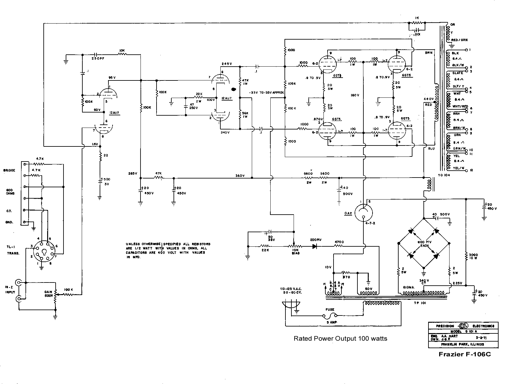

With the 0A2 150V screen V, it is running with the datasheet curve set. 60V knee Voltage and 440V B+ leaves delta 380V operating peaks (and delta 500/2 mA peaks + bias current per tube ). To get 100 Watts would lead to a 2900 or 3000 Ohm P to P OT. This would translate to a 6K P-P OT at the same B+ for a single set of tubes. The highish 440V B+ would indicate its optimized for power and efficiency, which it can well afford to do ( still low distortion) with the straight line plate curves. ( low screen current distortion allowing higher Z loading )
The 550 mA peak tube rating would readily allow (single tube set ) operation with a 3000 Ohm P-P OT at 330V B+ ( delta 360 mA peaks + bias current ) (providing tube diss. Watts are in bounds). Although the tubes will likely last longer at the lower 500/2 peak mA + bias current (per tube) used in the above schematic..

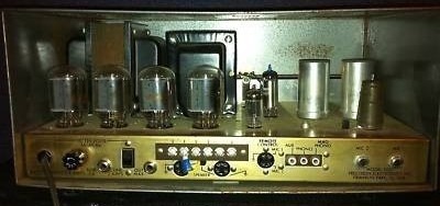

I saw this schema too, thx. Doing this project for friend w/ 2000 sq ft man cave.
At first, thought the the S-100 was 2 channel. But with 1 opt showing- it's 100w (rated) mono block.
Like to divide that circuit up into 2 x 50w- that schema provides good basis to begin.

450-500V B+ is what I was thinking for a 2ch pair... at least 300, if not 350ma supply. I have pr of Hammond 1650h's (6.6K) which should work.
Found the load graph below- you have something more or different? Novar base same as noval? Did quick inconclusive search.
Compactron suggestions are good, but I'd like to stick w/ 9 pin if possible since I have bunch of those sockets & footprint already in my PCB lib.
12GT5's are cheap like others- $6 vs $7.50 each, which is important cuz this guy likes it loud and bass heavy ;<)
AX7 / AU7 drive system is simple enough. Can single cathodyne inverter be used in place of AU7 to drive 50W pair?
