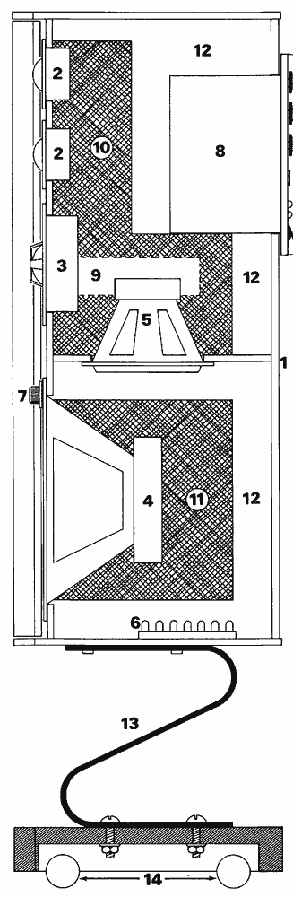

I am intrigued by the bass loading technique used on the Griffin Studio Electronic 85. I can only assume that the internal B200 is to acoustically add mass to the B139?

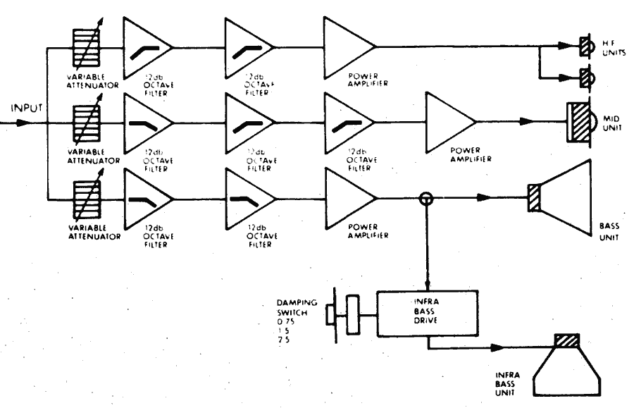

The B200 acts as a “valve” to the upper chamber. From the block diagram it has an infrasonic filter in front of its amplifier.
It could act like an isobarik driver (at LF only) or it could do something else. It cold be an active version of the second chamber loaded by an aperiodic vent (ala Dyna A35/some Naims).

Ah! Thanks! Thought darkmatter had some............Altec fiddled with these, though described it to me as an active version of a drone cone [PR], so for now going with adjustable isobaric.
