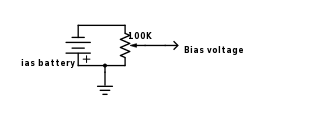

Grid Bias voltage from battery
Thoughts? for a 50V bias Ohm's law says 0.0025A. This seems like a long battery life if it's switched with power.
I know I can used fixed resistors around the pot for more fine tuning BTW
And this is only valid for a design with minimal grid current.

What you show resembles common "fixed" bias power O/P tubes. The difference is a battery, instead of a rectified AC rail.
The grid to ground resistor connects to the trim pot.'s wiper. Don't forget the DC blocking cap. to which the driving signal is applied.
What battery would you use?
That's exactly my question too. Those old "high voltage" carbon batteries are virtually impossible to find today. And 30 penlight cells in series is awful impractical. Assuming the rest is run from a power transformer that has no bias tap, buy a cheap little 12V filament transformer and run it backwards from a 6V filament line. This will give you around 60 volts on the primary (which is now the secondary). Bridge rectify that and your good to go with a lot less cost and space.

I was thinking these...
5 in series make 60V

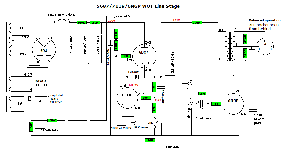

This reminds me something I allways wanted to ask! The attached schematic is from Troels Gravesen's website. I hope it's OK posting it here. Please read more about it here: TRAM w.
The idea is to place the battery in series with the grid so no current -or very little- will flow through it. In this application it is used to bias a small signal tube. For a power stage fixed bias we need something adjustable but the pot on the battery defeats the operation principal, so could it be done with a pot on the cathodes?
What do you thing of this in general?

If you put the battery on the cathode it will charge when the amp is turned on so you can't use a primary cell.

Bias current is defined in the cathode circuit. you could throw a battery in the cathode circuit. However, you would go by the rules of self bias for the voltages instead of fixed bias.
Batteries do make interesting coupling caps btw.
Self bias is interesting adventure in output tubes. An interesting SE amp could be made by a 12ax7 and a EL34 @150V B+. the cathode circuit of the el34 is the 12 ax7 heater (in 12 v operation) yielding a bias current of around 150mA.

If you use a battery in the cathode circuit it must be rechargeable though 🙂
I have an out push pull that uses ECL82 with 12AX7 heater as the bias. Free Power of sorts...
I use A23 and AA batteries for bias in variety of designs, but generally try to use them in places where the battery has a specific benefit - for example in a floating application or where there is no negative supply, and the voltage and currents (essentially a uA or less) are within the range of cheaply available batteries.
In the sort of application you propose a conventional bias supply is more practical and lower risk.
#1 There is only 300V available, and a negative grid bias makes more efficient use of it.
#2 I'm not concerned with the risks per se as I use a CCS in the cathode in case the batteries fail. And to me using 4 A23 batteries in series across a pot is far more simplistic than a bias supply (Unless somebody knows of a negative equivalent to a TL783). It's much smaller, and doesn't need much (like none, right?) filtering either.
