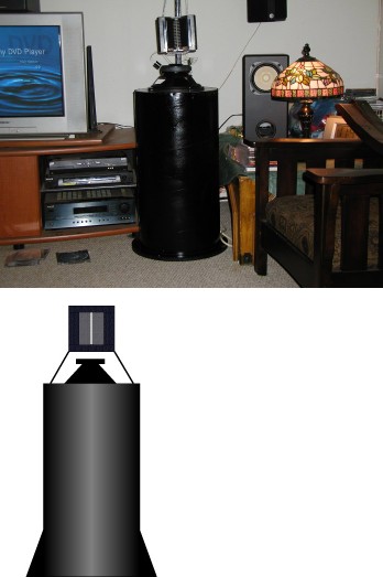

Some info about the "upside down speaker" in the photo
http://www.diyaudio.com/forums/showthread.php?s=&threadid=100390&perpage=25&highlight=&pagenumber=2
http://www.diyaudio.com/forums/showthread.php?s=&threadid=112904&highlight=
http://www.ohmspeaker.com/coherentlinesourcedriver.cfm
This construction allowed me (and others that went down the quasi "Walsh" path) to have a nice open sound that gets away from the "speaker box" sound. Same thing with Open Baffle designs - they get away from "the box". Once you get rid of the speaker enclosure you encounter a much more open and uncolored type of reproduction and I find it much more pleasant for long term listening enjoyment. BUT - it isn't everyone's cup 'o tea and your mileage may vary.

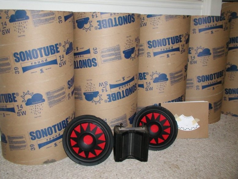

Attached is a photo of my modified Pioneer 10 inchers.
Planet 10
The pictures you included showed an original ESS cabinet with the 3 way design. c2cthomas indicated he received a pair of AMT's and the cabinet was damaged in shippment. The conclusion was the cabinet was not well engineered. Did you find the same during your project.
In addition the woofer and passive radiator were relocated to a lowered position. How did you cut out the radius to receive them in the new position?

The original cabinet was tossed -- ir was of a quality where it pretty much fell apart -- and a completely new one was built. That the new cab had to accomodate some freshly built grils determined the size & shape of the cabinet. Original woofer & PR were used, Eminence 6" mid added.
