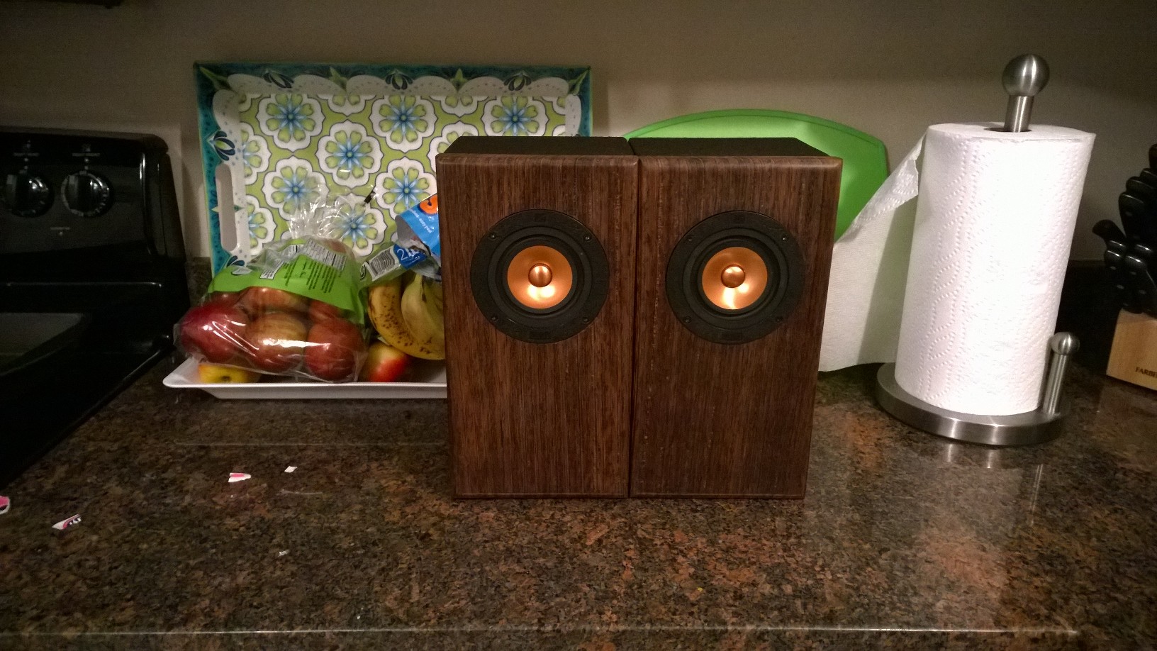

I am somewhat new to this forum but have read a lot of posts for the last year. I started dabbling in speaker building earlier this winter. A few full range drivers I have been experimenting with are the Mark Audio Alpair 6M, 6P, and CHBW.
The 6M has been my favorite of the bunch. I have tried several variations of the “Golden Ratio Bass Reflex design” posted on the Mark Audio Website. The pictures below are a pair I completed mid-December and then a pair I am finishing up currently. The Darker ones are actually completed now with the front ports.
To sum things up the current design with a little digital EQ is one of the most enjoyable near field design I have had in front of me of the different setups I have had over the years (Mackie, Blue Sky Media Desk, PMC, KRK, M-audio). I feel as though the Alpair 6M is a very overlooked driver. I am very happy with this modified design. It may have a been a fluke but it turned out well. Hope to post more later.

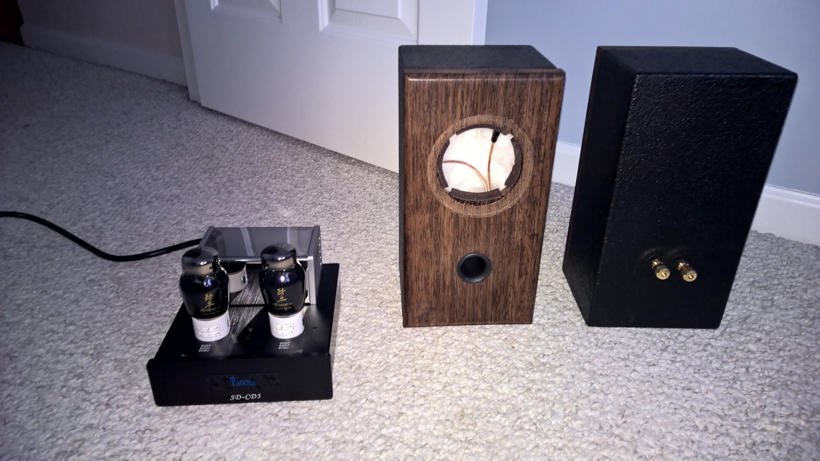

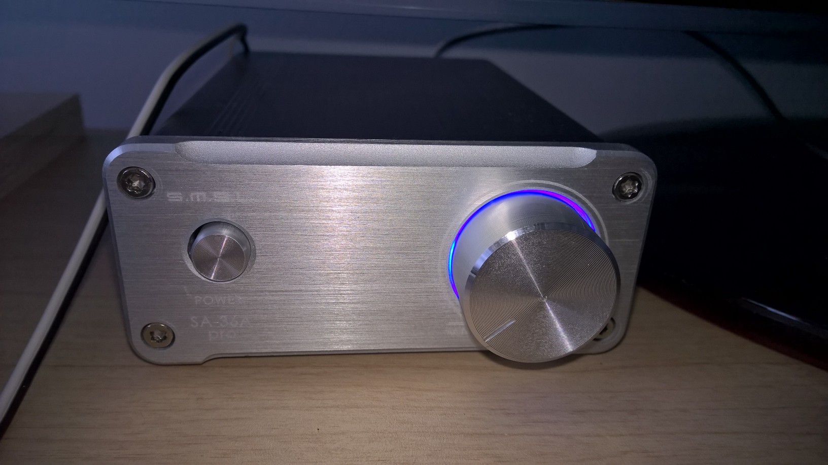

I am using the SMSL 36A pro, with Yaqin tube buffer on the front end. The tubes are the Shuguang Treasure CV181-Z black bottle tubes. The sound is awesome for near field/moderate listening levels. I listen to a lot of ambient electronic music and this is truly the most satisfying setup I have had for non fatiguing reasonable listening levels. (I have had Fritz speakers, Pmc, Merlin, Dynaudio, Harbeth, Neat Petite, with Hegel, Job, Nad, Exposure, Rogue,Flying Mole, Class D, (FYI Exposure amps are my favorite). It thumps, is warm, fast, and draws you in, nice sound-stage, and a tonality that reaches out and warms you like a fine glass of scotch. Her are some more picks.
tell us more about the amp - cute little package for sure

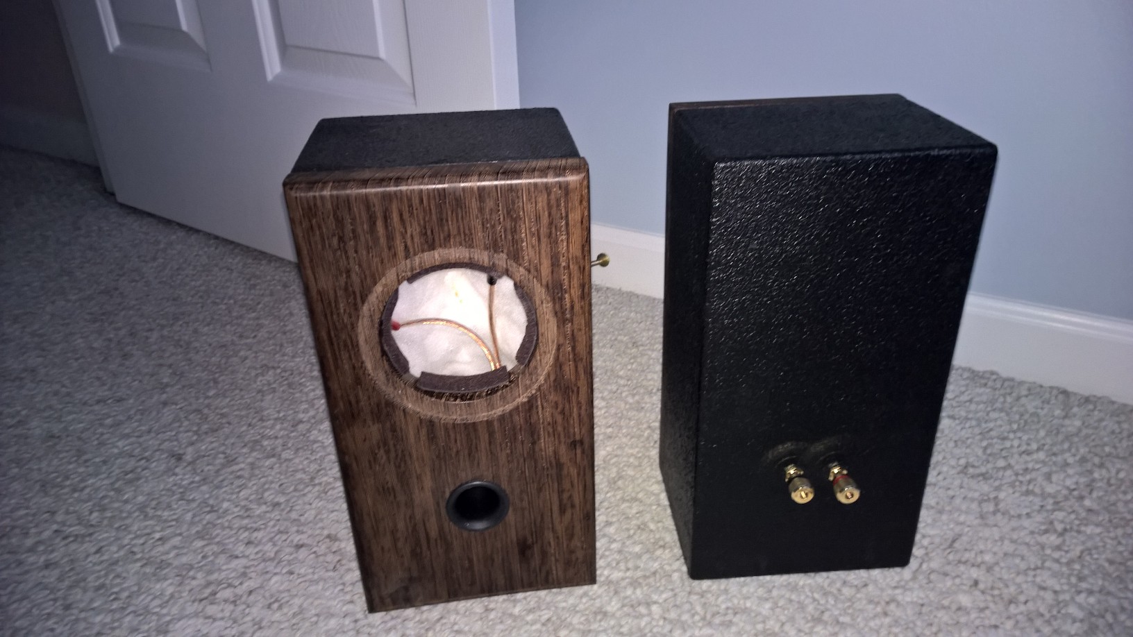

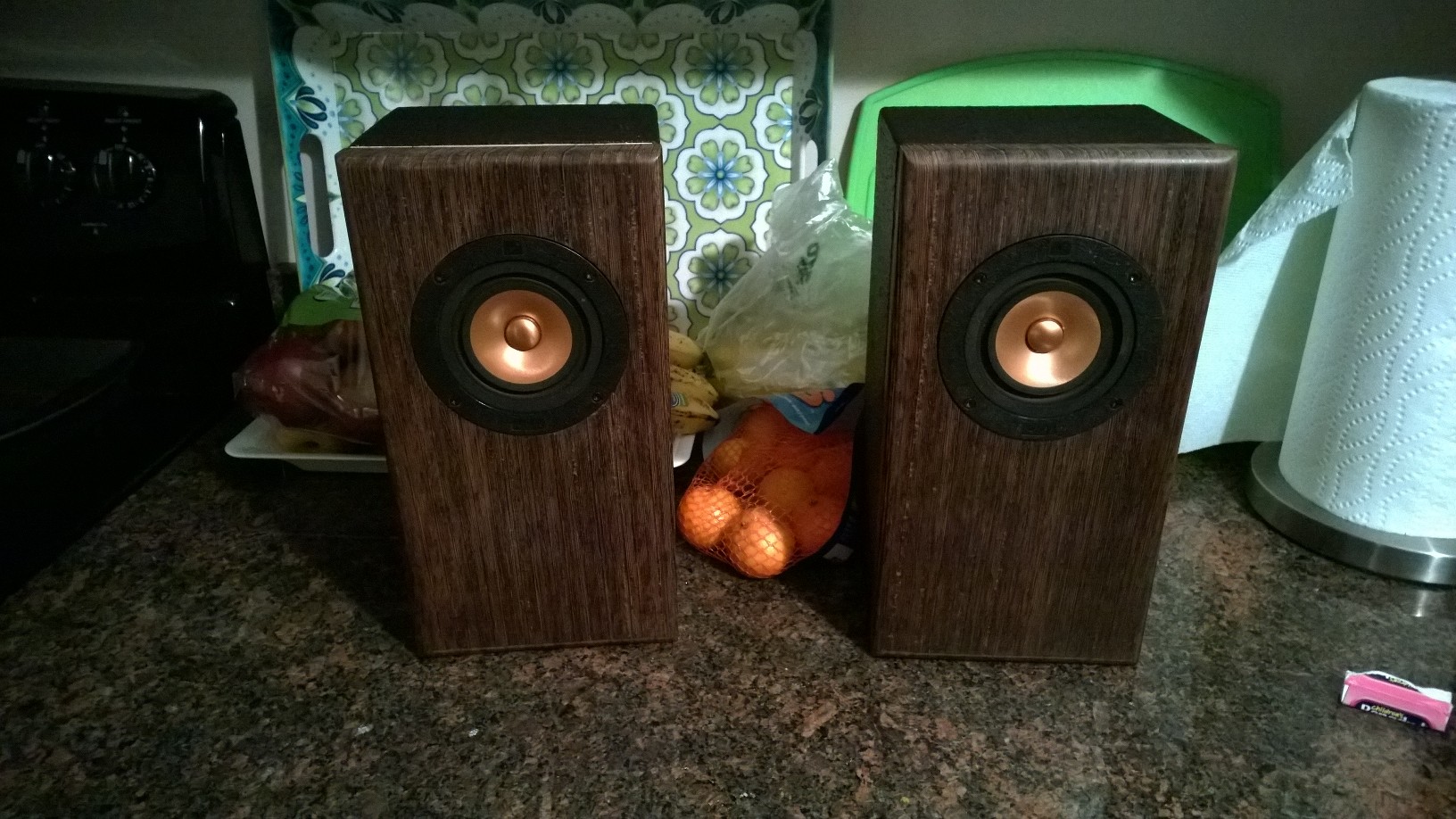

The front panels of the darker pair are “Wenge” an exotic hard wood from Africa. Once it warms up outside I will be able to sand them and then use a Tung oil finish.

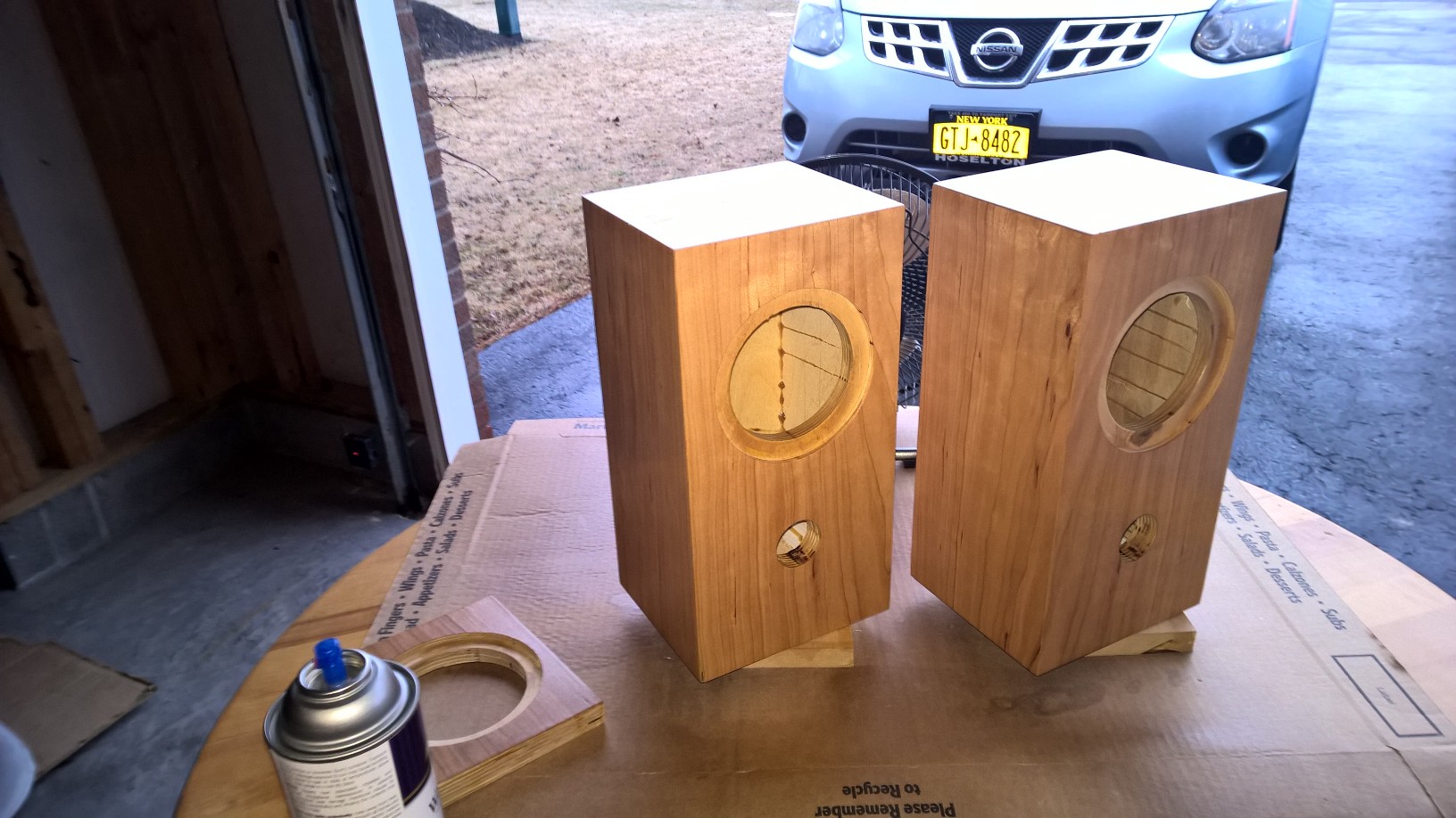

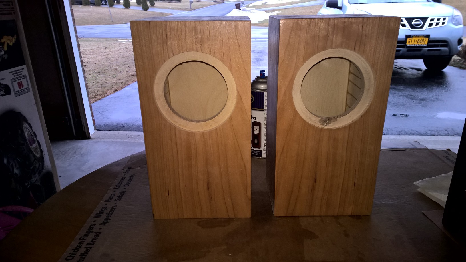

The second lighter pair is Baltic Birch with a cherry veneer. I have never veneered anything before so it was a fun learning process. These speakers are now being layered with deft lacquer spray in preparation for hopefully a nice shinny finish.
The SMSL 36A pro is a small little digital amp based on Texas Instruments TPA3118D2. It is somewhat popular on these forums and I can see why. It’s refined, transparent, and non-fatiguing. While it does have its limitations (power and low end authority) Paired with the Yaqin tube buffer and Shuguang Treasure CV181-Z black bottle tubes, a nice amount of tone, texture, and bloom is added making for a very satisfying music experience.
I had another variation of this design which used a passive woofer instead of the port on the front. It added a nice amount low end extension but ultimately had a little too much bloom in my near field setting.
I’m really happy with this design. I Hope to post more pics as I finish the second pair.

Very beautiful cabinets!

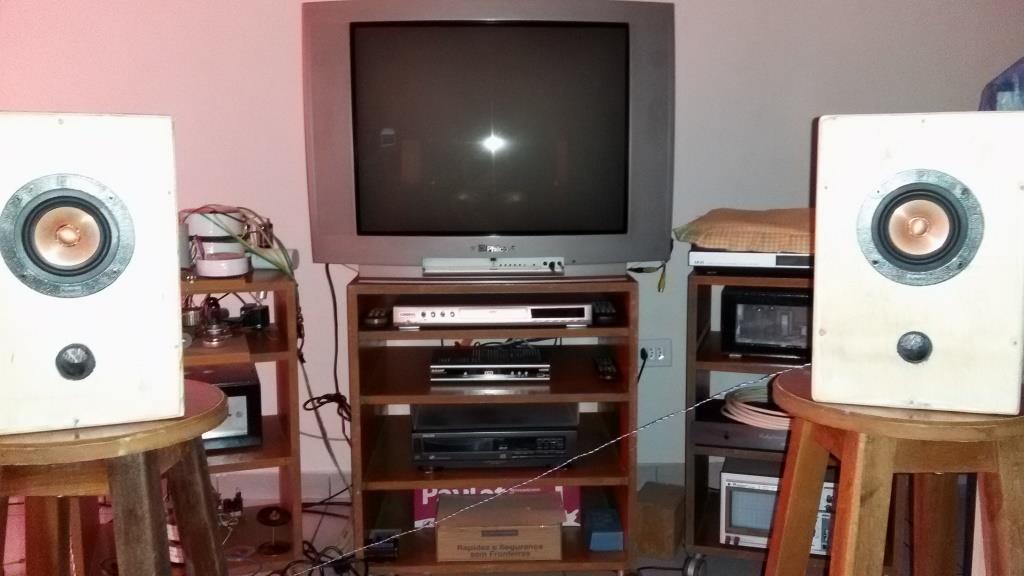

I'm also making a cabinet for 6MA usage. Is not so beautiful, but is a Work in Progress: next step is to line them with a Tolex (Fender-like), because sometimes I want a different finishing than varnish or paint...
