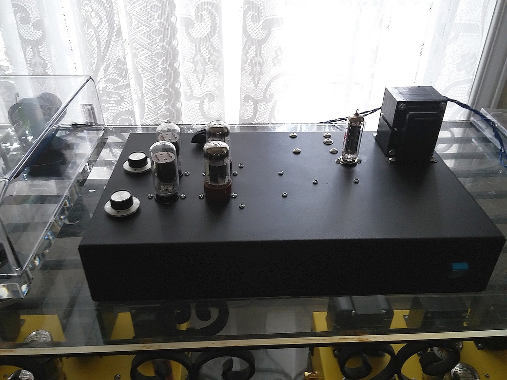

Here is my point to point version, alps blue mono and 3 channels selector.
Ez81 rectifier and a choke which was replace by internal resistors, the power supply is unregulated.
The weakest point in the amplifier is the volume pot probably. I am very satisfied overall.
You can place any type of tube for the cathode follower output, which is nice, but it benefits from tightly matched sections and high performing input tubes.
The input tube grid bias is very strange at -1.5V which yields the best results with small input signals amplified up to 5 Vrms output.
