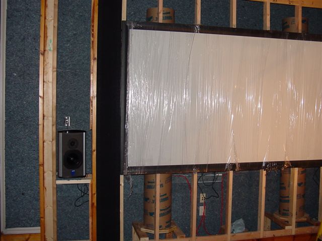

I have been experimenting with transmission line woofers at home. I purchased the last couple of 12" Shivas(I like the XBL tech!) available. Using 8 feet of 12" sonotube and a few bags of fiberfill it really sounded great,so I made a second. Even better! Tons of deep bass.
Since we are home theater/AV installers here in Minnesota, I was tempted to try the lines in a "real" (meaning paid for) installation. This theater had a 3 feet of space or so behind the fabric Screen Research screen and surrounding GOM fabric "Scrim" wall,so it would be easy to hide the unfinished and pretty ugly TLs. We placed them at 1/3rd points across the front of the room. Initial listening impressions were good, It seemed I could actually use these in a critical (read expensive🙂 installations. I then applied the automatic equalizer circuit included with the Lexicon MC12 processor. This optional board covers 250hz to 20hz using 10 outputs with 7 point per channel parametric adjustments. Things got much much better. It sounded and felt like a real train was rolling through the theater.
Admittedly best near the microphone placement locations.
Music was fantastic as well It seemed the TLs really benefited from this eq. It now seemed like a solid 25hz or lower was being effortlessly reproduced.
OK, I might consider taking this to another level. I have read the "El-Pipo" article. I could fit the tube on it's side behind a similar fabric wall feeding the 21" woofer the LFE output from the Lex. Then use the same 12"version for the left and right subwoofers.
This might get spectacular!
I was not clear on the length of El-Pipo 12' or 14'? It obviously would be easier to fit the 12. Anyone else experimenting with equalizing TLs?

Do keep in mind that there is even more performance potential in El Pipo... the pipe for the 21" woofer is a tad small to get the most out of it (as would be a 12" pipe for a Shiva)
Anyone who has heard either is, i'm sure, wondering how more could be had from them given how good they already are.
