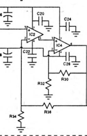

Yeah, leave it as is, a number of the amplifier stages are composite types (i.e. two op-amps in the primary feedback loop) and the AD744 has a nonstandard pin out. Fiddle around with swapping op-amps and you could end up with an oscillator.
