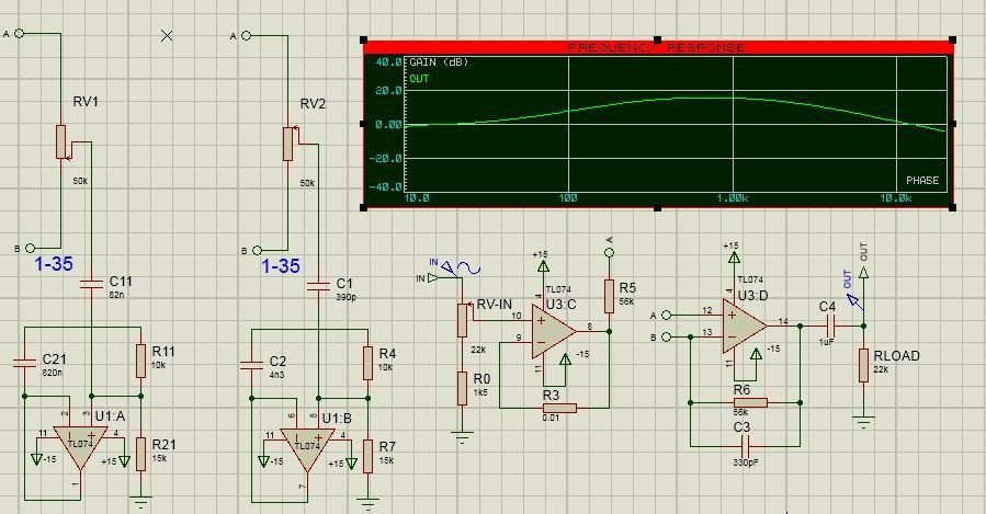

Hello, I am trying to set up a graphic EQ with linear pots, I have a matrix of 10x.
The problem is it needs 'S' curve pots.
Something like a log pot from position 0-50% and antilog 50%-100%.
I get smth. like 50% gain from 50%-90% position and another 50% gain for the last 10% or even worse.
Any solution to get it more linear?
Regards
Regards

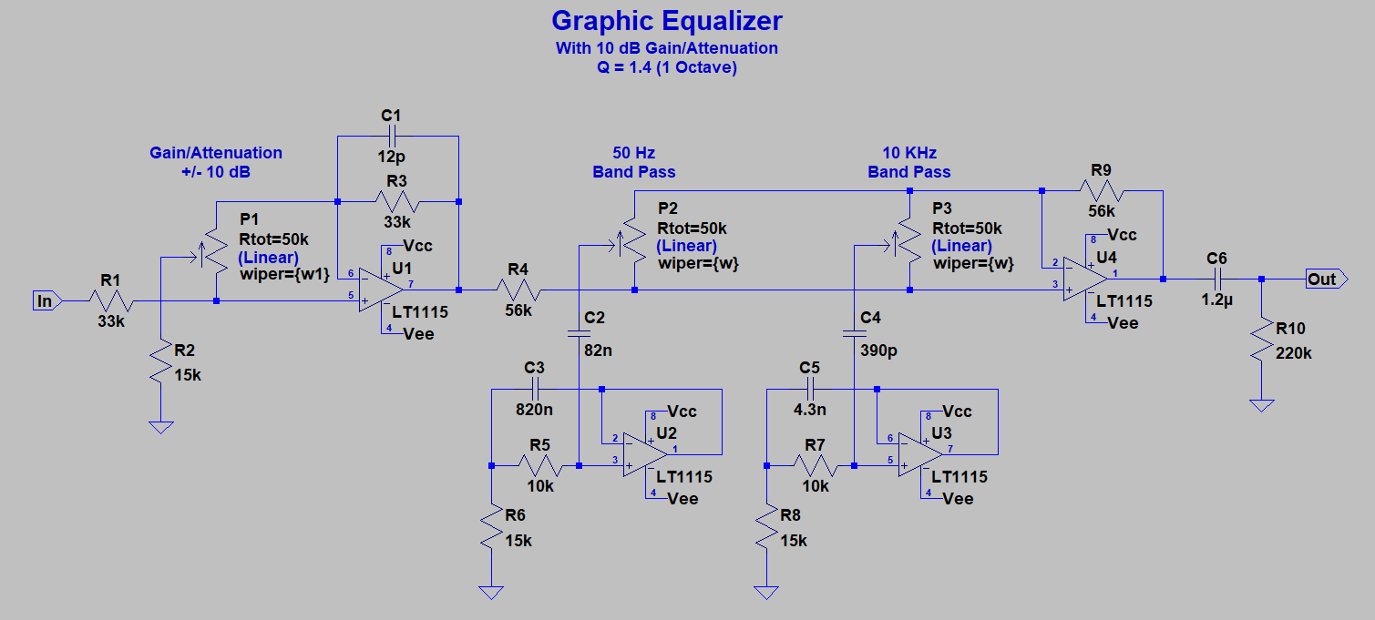

I don't know if this will help or not but here is a topology that I use for bandpass filters which uses linear potentiometers. This is a snippet from a custom circuit designed for a tape head calibration application, where the client specifically asked for controls at 50 Hz and 10 KHz. The Q will need to be changed to something appropriate for a 10-band equalizer but maybe this will give you some ideas.

So my simulation software is wrong ???
The internet circuit has some complex feedback network (first opamp) that might correct the gain for a linear pot?
p.s. what is your software.
And also I cant figure out what sets the gain.. The feedback resistor over what...

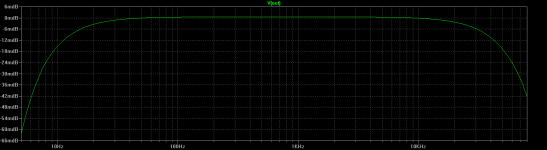

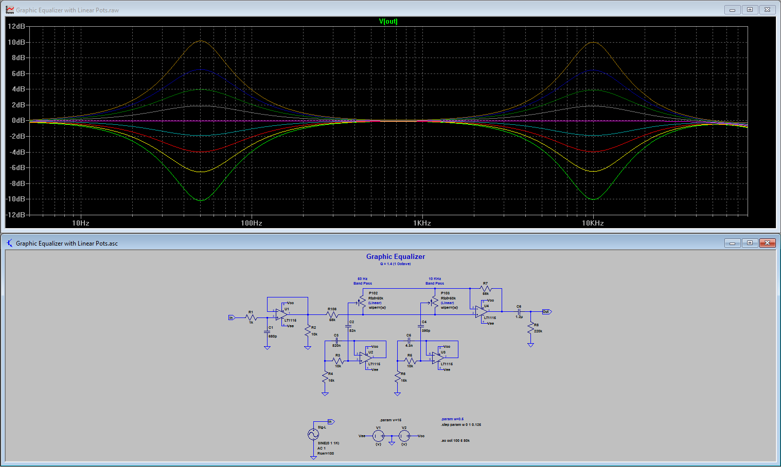

Yeah, I'm not sure what is going on with that input stage. But here is a revised LTspice schematic which adds a 10 dB gain/attenuation block which can be used in place of the original input stage. This block has non-inverting unity gain when its (linear) pot is centered, and provides 10 dB attenuation at the full counterclockwise position and 10 dB gain at the full clockwise position. Gain is established by R3 and R2 according to the formula Av=1+R3/R2. Of course, this input stage can be replaced with a simple buffer if desired.

It is 15db now (on my simulation) and I can control it, but wanted to find a way not to increase the feedback too much (cause of noise)
In case I can cheat the linear pot to be seen as an 'S' pot with some resistor network, but I need more gain..
I am still at dismay - in general your circuit and my circuit are the same, just the simulation software is different..
And the kit seller warns in the description, that 'S' pot is needed for a linear response.
I didnt know it is that bad as my simulation shows (if it is correct, I doubt everything right now..)

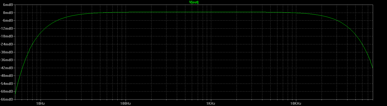

I can confirm that the circuit I provided does not require a special taper. Plain linear pots work just fine. The response is flat with the controls centered and the plot shows the range of boost and cut at the designed bandpass frequencies.
BTW, my circuit is an excerpt of a design I did for a commercial recording engineer. It does work and he is happy with it. 😉

You and my simulation ran me into another doubt..
The simulation shows different gain at max settings for arbitrary chosen channels
You said the bandpass gain is 10 db.
I used this calculator, and it seems the particular elements set different center frequency and Q factor, but nothing about the gain..

I can't speak to your simulation results but I can verify that my LTspice simulation results were verified through bench testing of an actual product. Simulation is a great tool but is no substitute for performance measurements.
What control range are you looking for? 10 dB is a fairly common value and is way more than enough in most applications.

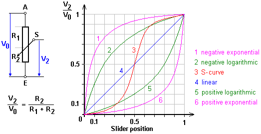

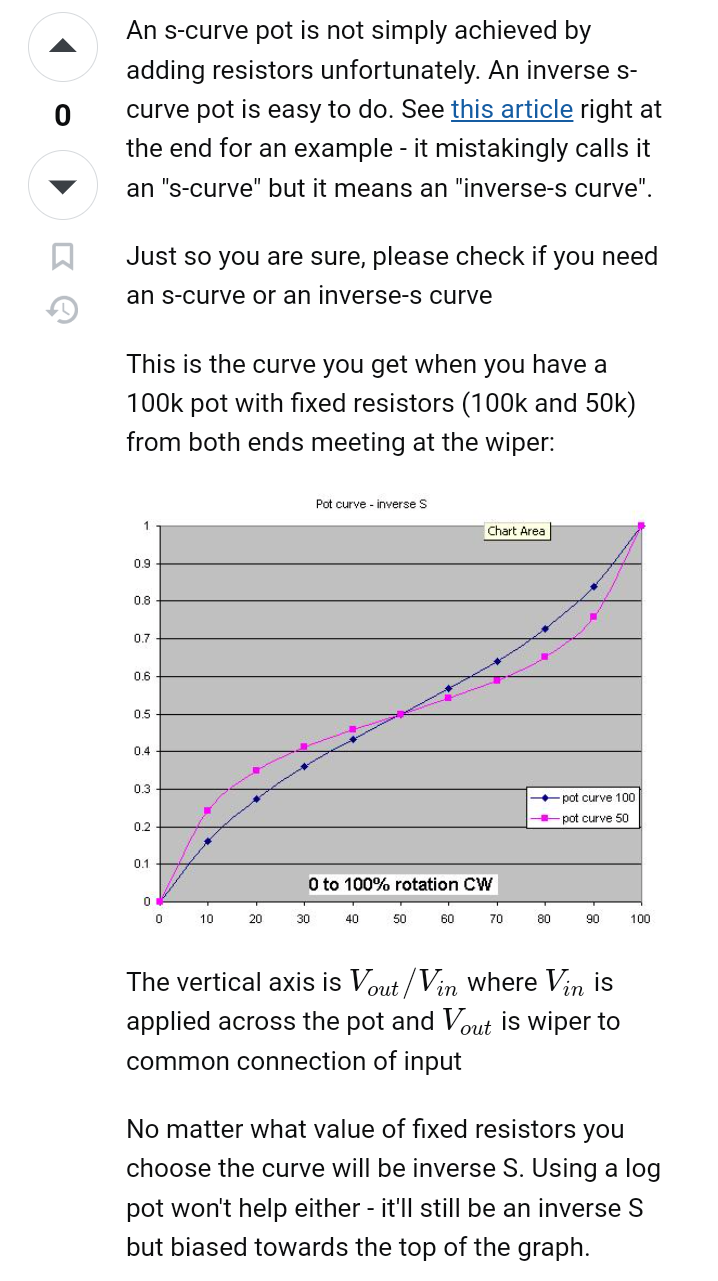

Here it is the S curve needed
Adding resistors (ends to wiper) would make an inverse S, and it would make the response even worse

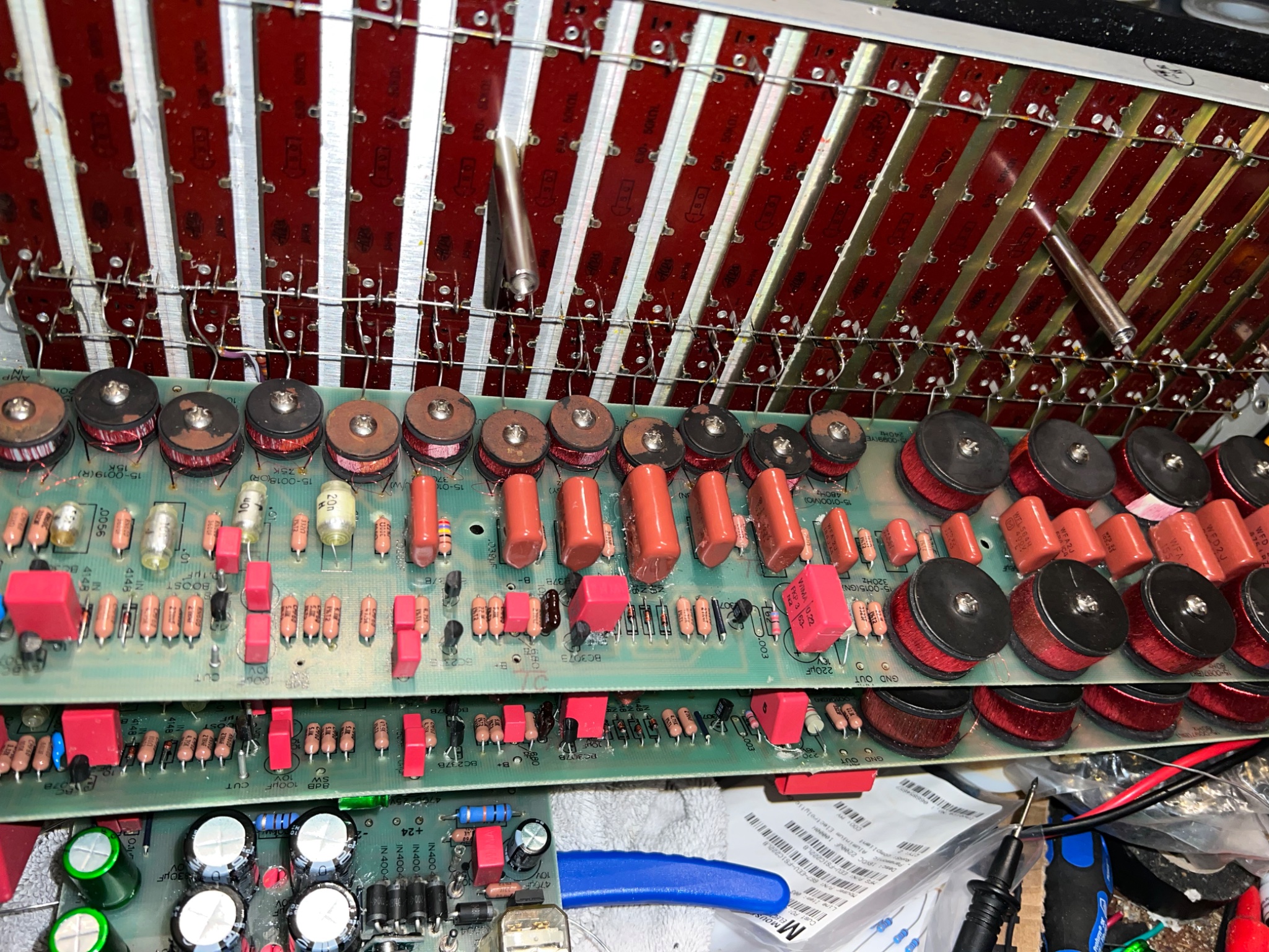

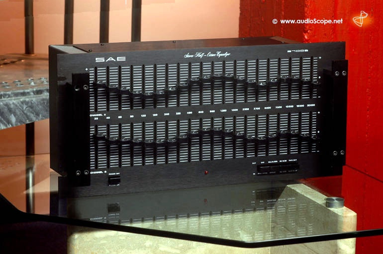

too many opamps!
SAE MK 2700 - 20 inductor / capacitors bands and 8 transistors class A per channel with resistor and capacitor update.
5U - 9 inches tall - discontinued because it was too big and too expensive to build - circa 1977

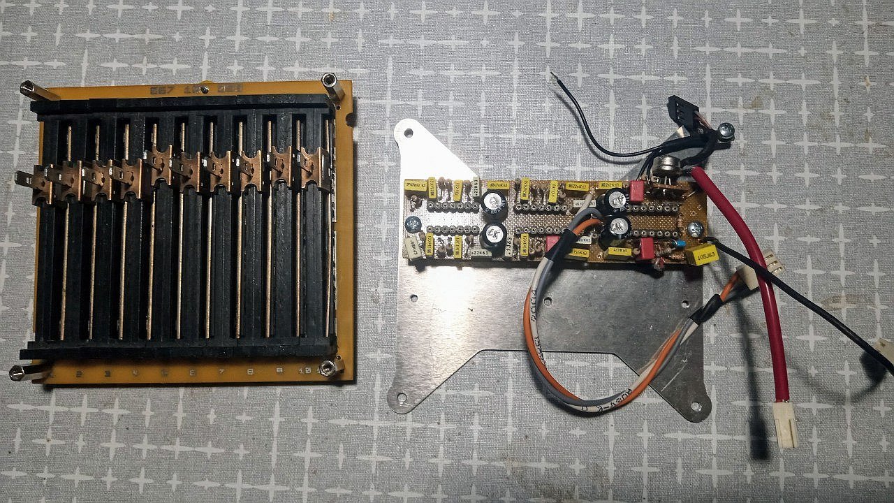

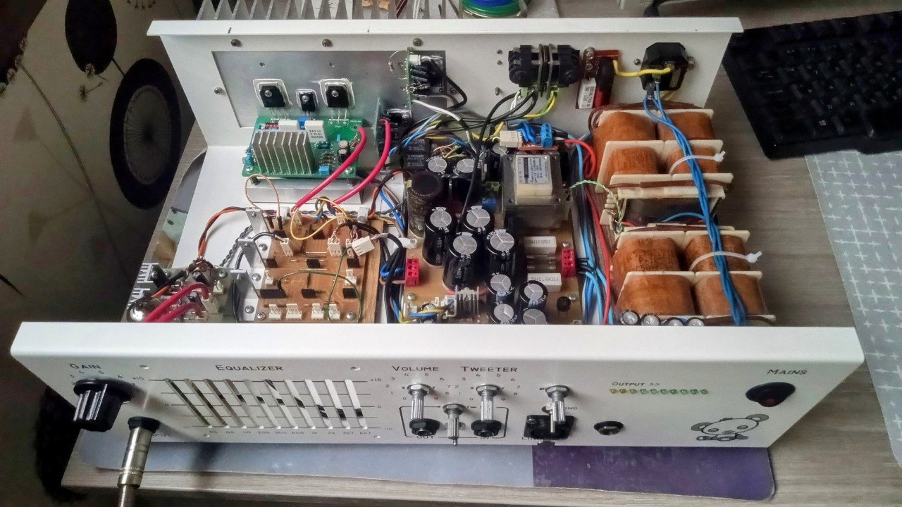

This is the unbeatable form factor, a pcb with 3x4 opamps:
Post in thread 'graphic EQ with linear pots' https://www.diyaudio.com/community/threads/graphic-eq-with-linear-pots.420802/post-7863171
That's why I chose the kit in the first place...
Rod Eliot's mfb has one discrete element per band more, but I have to design a pcb inspired by the layout of the kit above.
The point is I have to incorporate the EQ in an old project of mine
