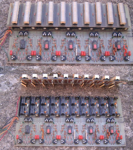

There was a project in the american magazine Popular Electronics around 1977 for a 10 band RTA. It used a single LM3915 to drive a multiplexed display, and op-amp bandpass filters for each band. I'm slowly building one. Email me and I might be able to scan the article.

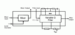

Here's a much easier way to do it (than driving yourself crazy building dozens of bp filters) -- get yourself a Zetex ZFX36L01 chip -- it can do bandpass and notch with adjustable Q -- and it can be swept !!!
use a clock to periodically sample and hold the signal -- you can generate the sweep with a couple CMOS logic chip -- or if you want to use the serial port on your computer you can write the appropriate code.
there are some advantages to using analog vs FFT
Re: ZFX36L01
Yupp, they don't even list it in their catalog of obsolete products -- you could replicate the device with an analog devices mixer and VCO -- I would use a crystal filter rather than an analog filter, however.

While thinking about the swept filter + sample and hold, I see an inherent problem. It has to do with display update rate. At the lower frequencies in the band, it will require a good length of time to get a good sample. Consider at least one period for each frequency (at 20Hz would be 50ms..and so in in whatever octave resolution you desire. By the time the full audio spectrum is swept, it may have been 400ms or so (just guessing here). That is a very low update rate for a VU meter, I believe it would not be tolerable.

I'm pretty sure that the Zetex product is obsolete --this chip isn't for that purpose. check other threads.
