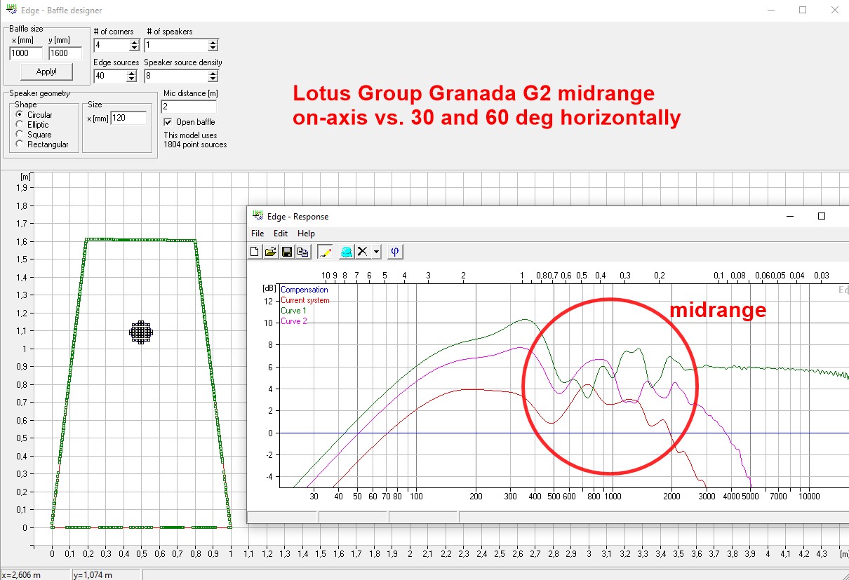

Please remember that this loudspeaker is "dipole". I suppose that the midrange (or fullrange in Granada original) are "open back" as well, and G2 has two tweeters, obviously the other one radiating on the backside.
Do you understand the radiation basics concerning dipole pattern? Baffle width determines the shortest pathlength where front- and backside wavefronts meet and interfere, Chambers don't change that, but they do have a minimal effect above this dipole range. Easy simulation with The Edge shows this. To make midrange and tweeter to have smooth dipole pattern as well, much narrower baffle is needed!
And the question was about height of the baffle (tall), and that detail is way off as well, but it's effect on sound (radiation) is minimal.
And about my "answers", please remember the price for a pair is 75.000$ which is of course much less than the Feastrex version costing 125.000! The Lotus Group's Granada G2 | Stereophile.com
The chamfers are quite shallow so I doubt the back wave will be too messy but I understand the asymmetrical nature of the design and the issues. But with this there is also some widening of the front wave compared to the rear wave is there not? I would argue that diffraction in the back wave off axis response is less detrimental than the front wave and maybe it is a compromise that was intentional. I doubt it will cause big problems with the cancellation to the sides but I don't know how to model folded back "wings" at a shallow angle, maybe there is software that can?
I don't see how the extended and sloped baffle above the tweeter could not help to support the vertical axis at the listening position? Can you tell me why you think it would make no difference at all or make it worse?
Yes, the price is insane, but that's a free market for you. If it doesn't work out his business will fail, I guess...
Other members here have given the answers: BEM software does an excellent job here. But I doubt if the design process has involved any BEM analysis...
As to that sloped baffle above the tweeter: It does a decreasing job up to more or less one wavelength of the lowest frequency of the tweeter, say half a foot max. Try The Edge for yourself, I'd say.
Edge can't handle edge chamfers or rounding, but eg. VituixCAD can. BEM modelling would be super, but one should know the backside structure too...
IMO it is safe to say that listening window response is ok, but wider off-axis and power response are a big question. 2X12" dipole woofers are ok, but make a challenge for positioning. Extra height above the tweeter is mainly for eyes.
