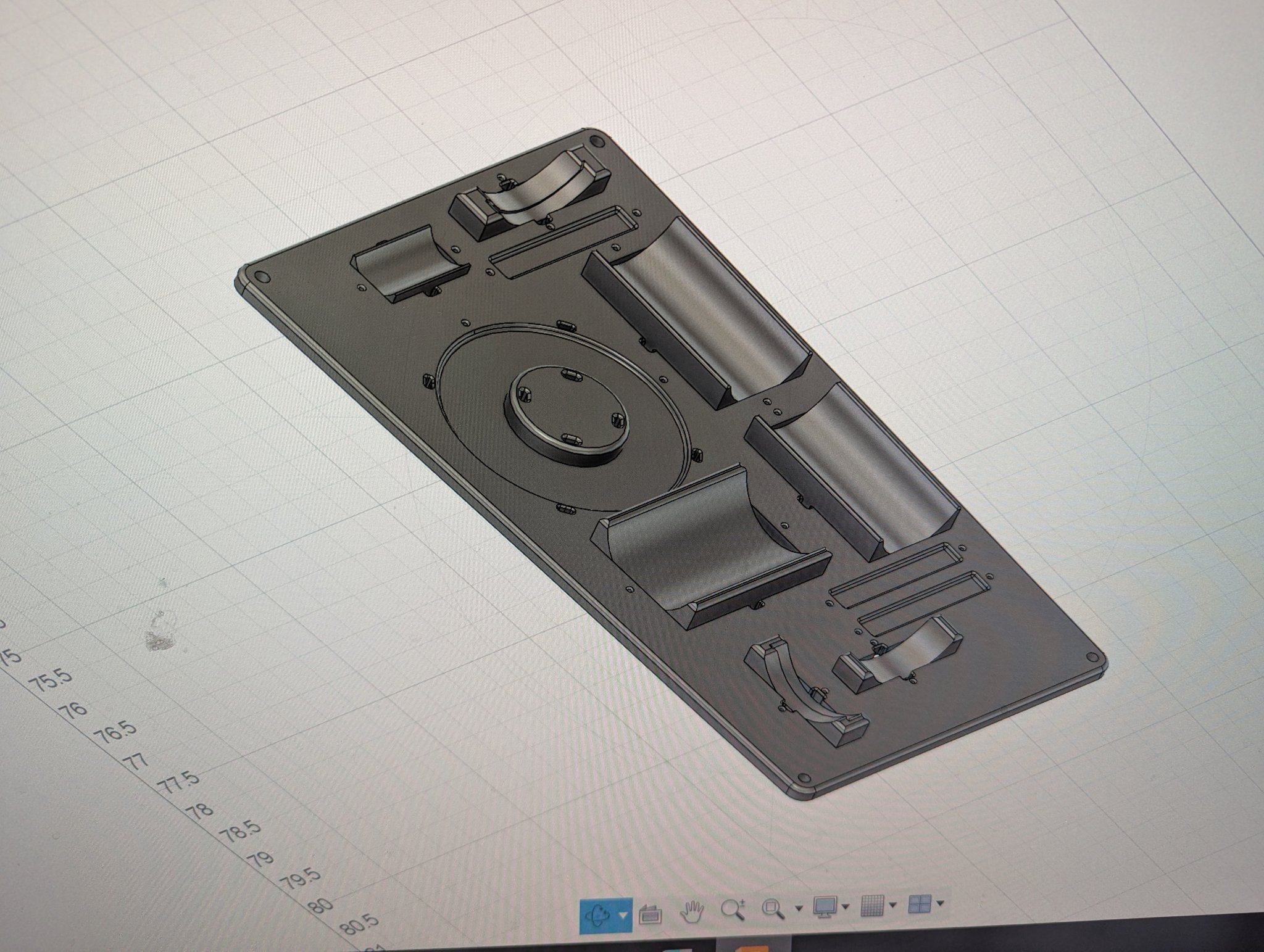

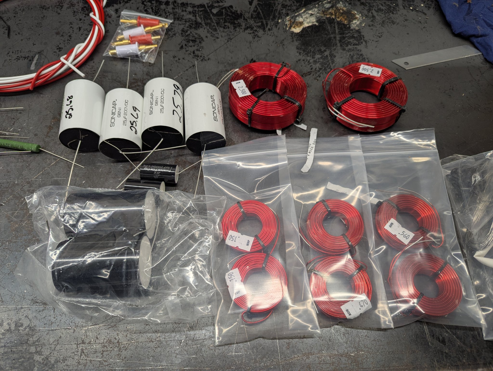

They certainly didn't cheap out on the crossover components though, they provided air core inductors and huge poly caps for everything. Included are the tube connectors Danny goes on and on about on his YouTube channel but these are really just banana plugs 🍌, I don't care how you sugar coat it. One thing that I do find kind of annoying is that they do not provide any mounting board for the crossover components and simply give you a schematic and a photo. For a lot costing as much as this a simple layout board would have been appreciated.

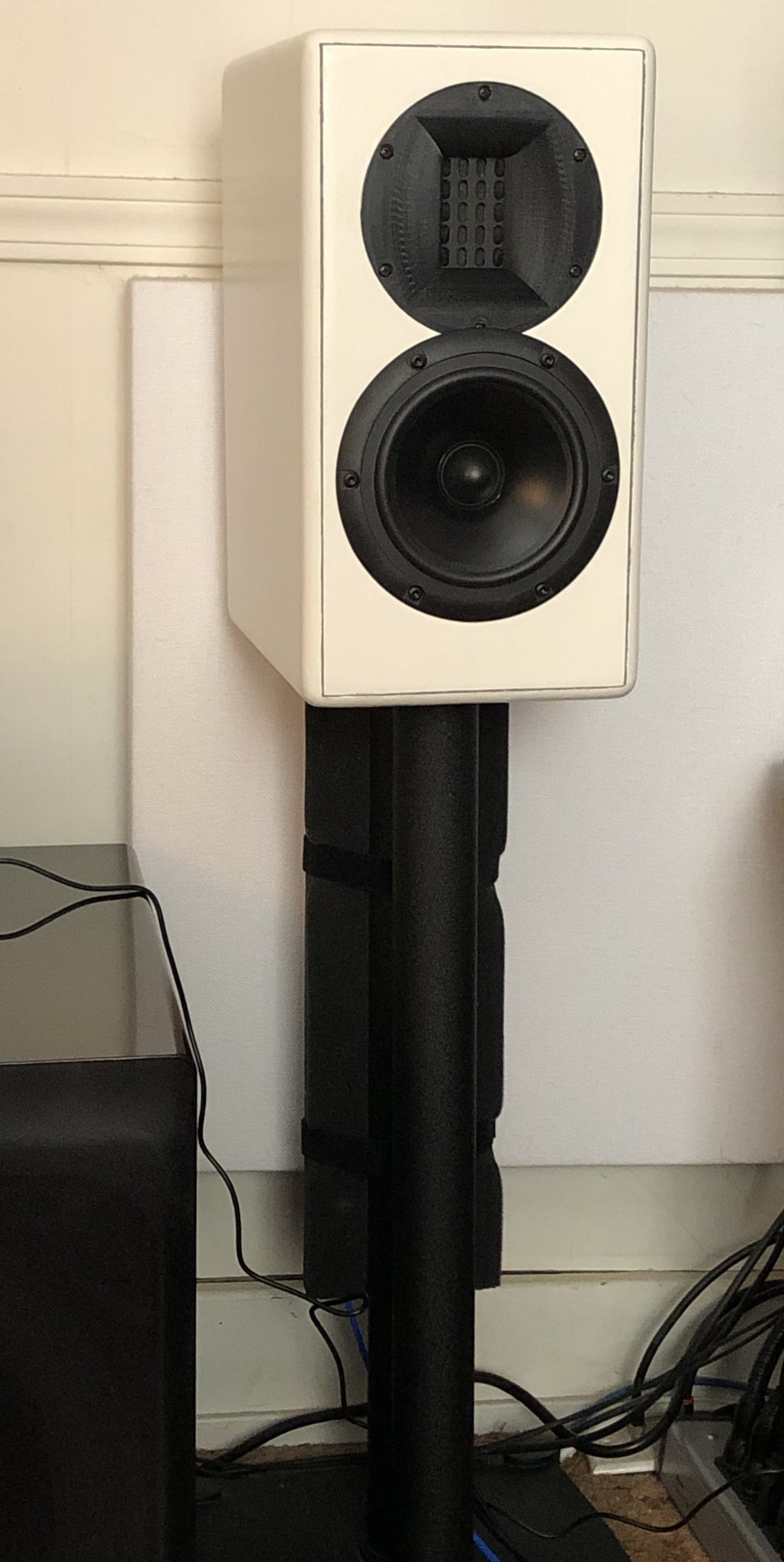

Looks ambitious. I'll be watching to see what you come up with. Finished mine recently and still in the honeymoon phase, but these seem pretty nice. Went my own way with certain aspects of the build.. more effort in the port, cabinet and driver damping, external crossover, damped back cups, melamine foam rather than insulation for absorption, reinforced baffle. I also used a precision milligram scale to make sure I had the exact same amount of fiberglass insulation in each back cup, just to help me sleep better at night. They don't seem to advertise it but the tweeters do come as a matched pair. Thought it may be worth the small extra effort. I only use them above 80Hz to avoid any limited xmax concerns, and let a servo sub handle the bottom end.

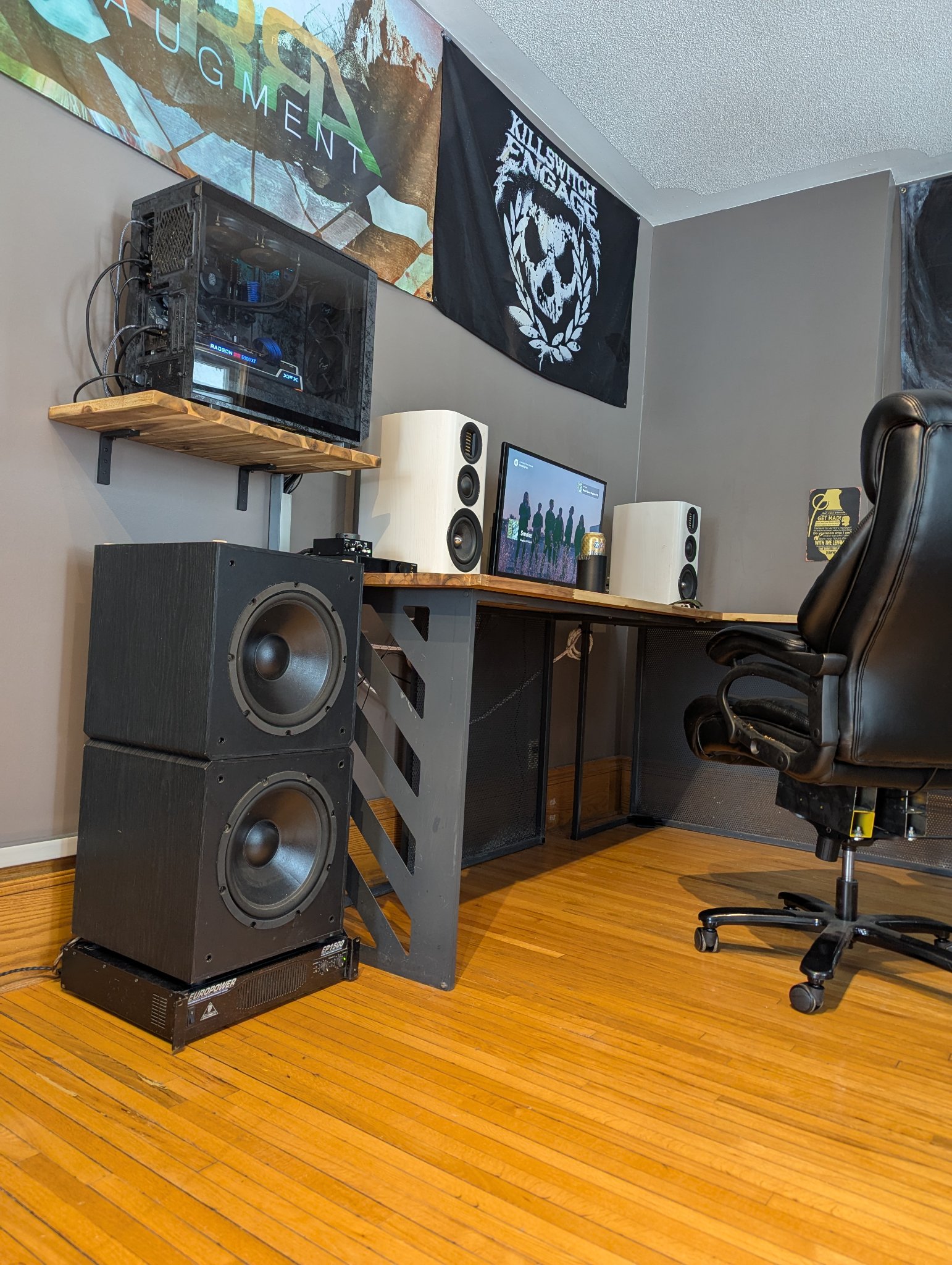

I placed an order for 5KG of PLA filament and 2KG of support materials, so construction on the enclosures will start probably mid next week.

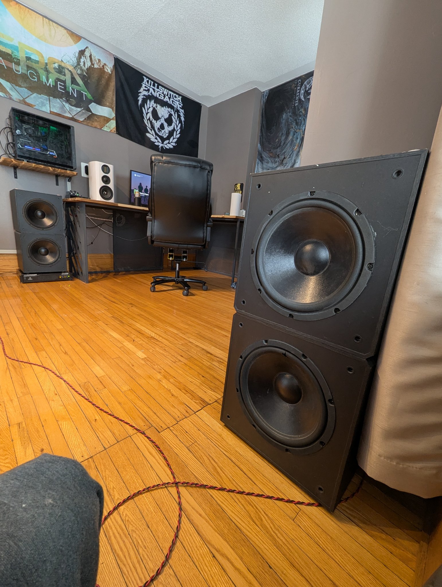

Bass duty will be handed by 4 12" denon subwoofers

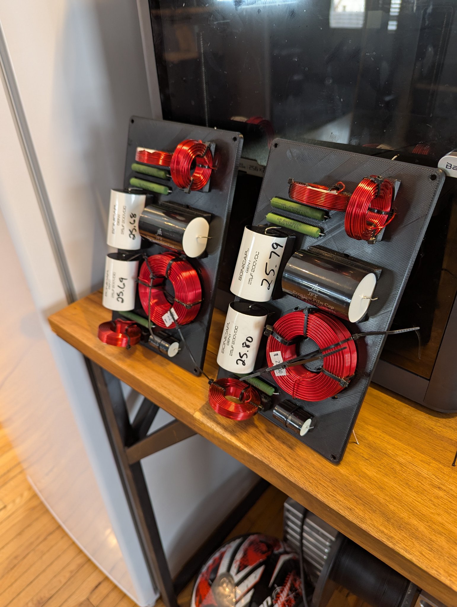

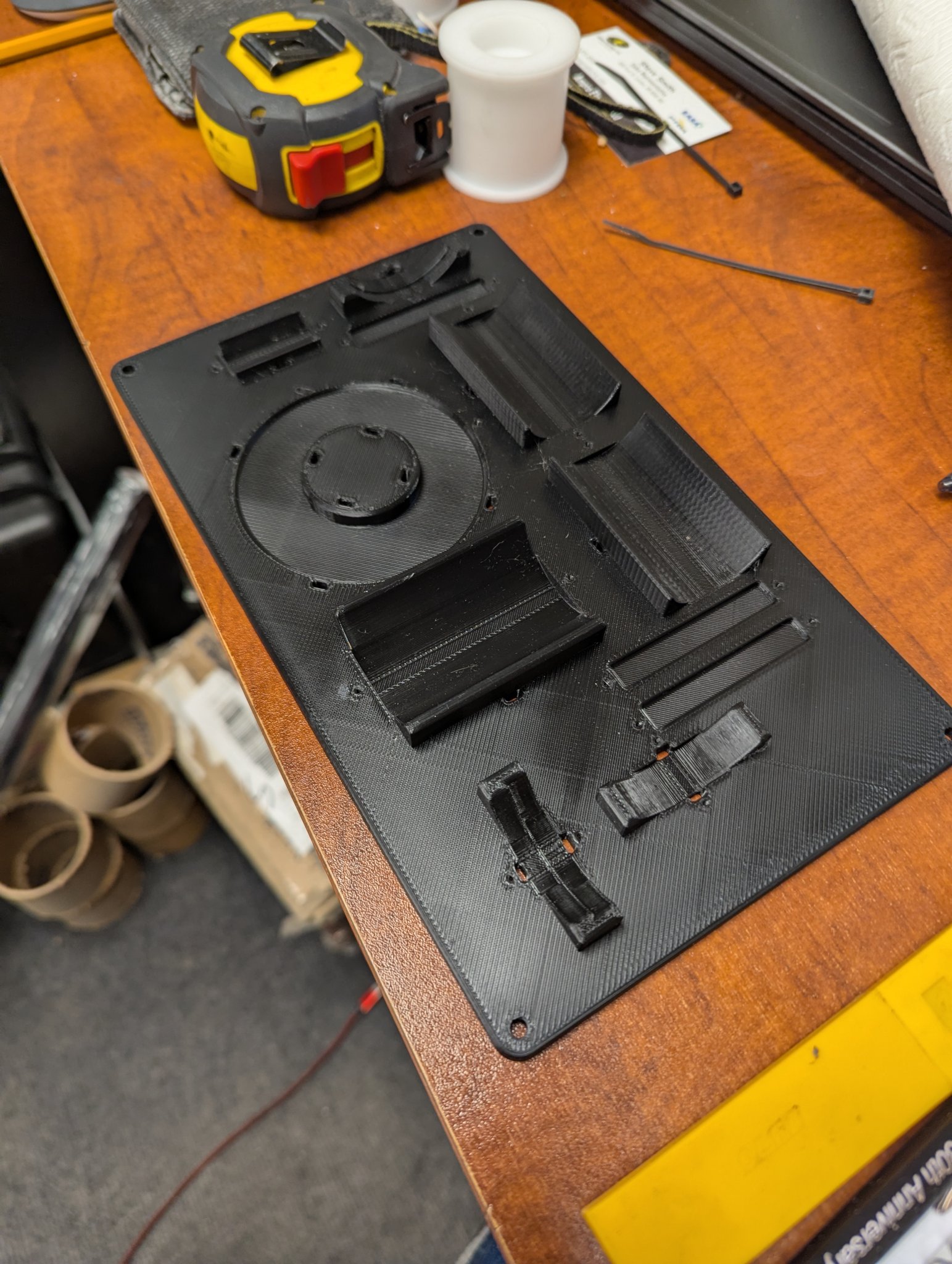

Both crossover boards built and populated, there's definitely some decent quality parts including with this kit. That's really to be expected given the price though.

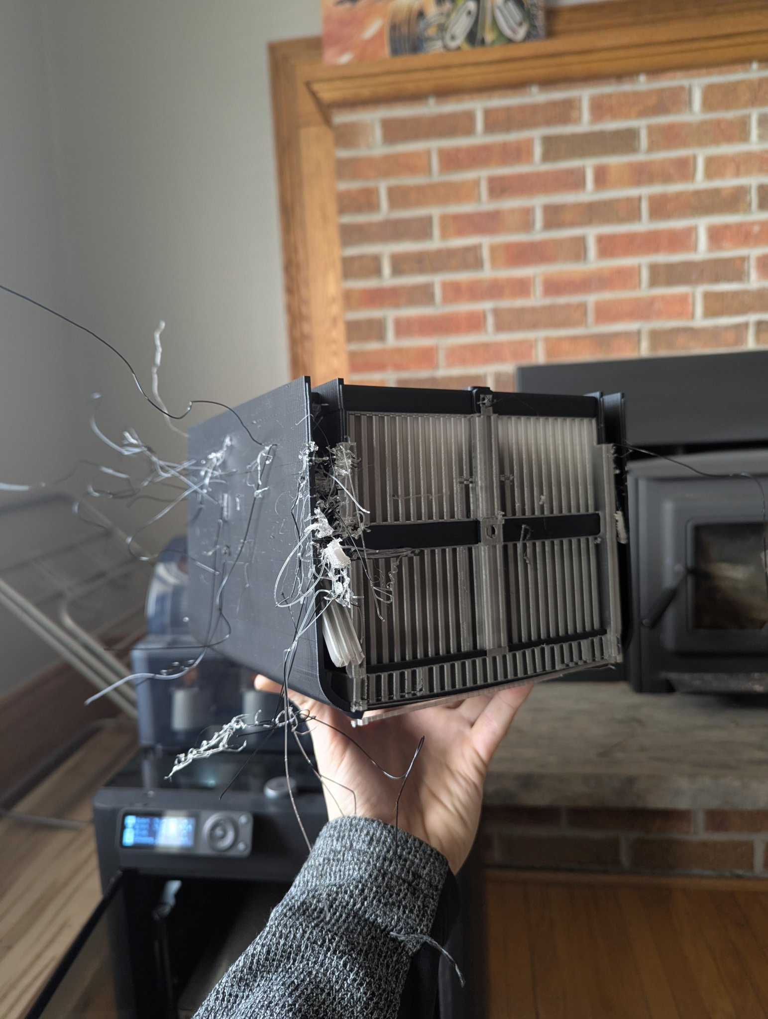

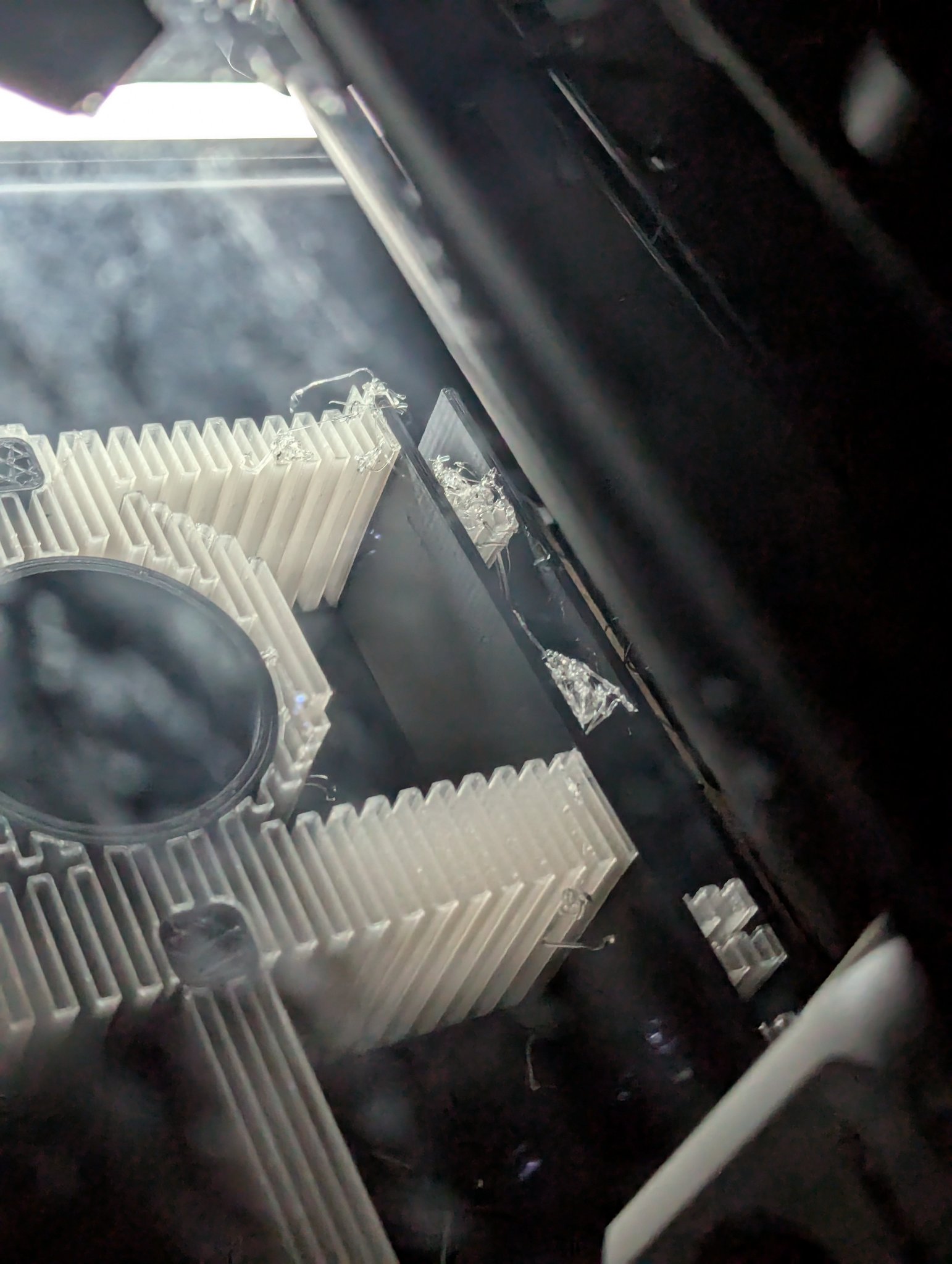

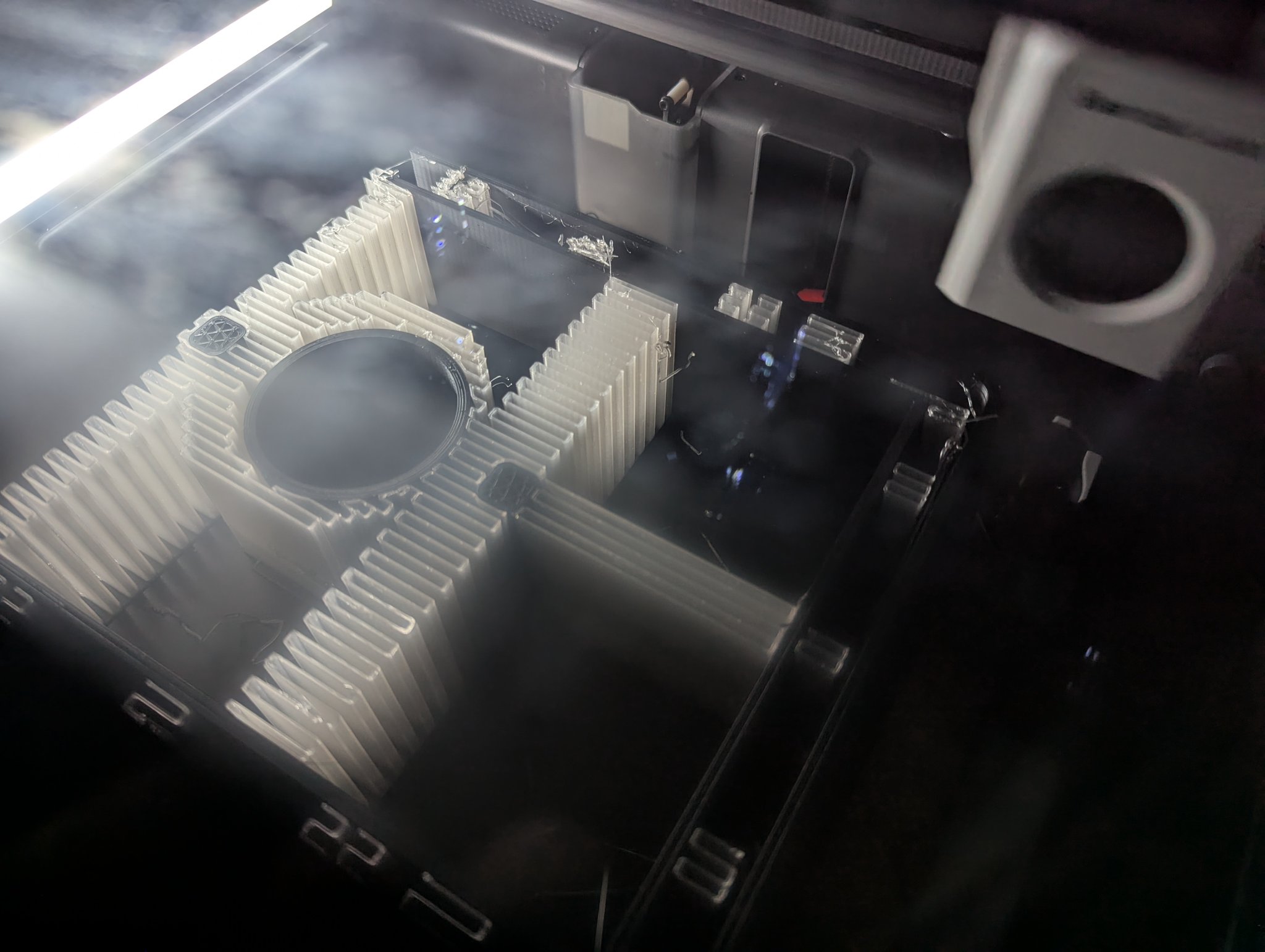

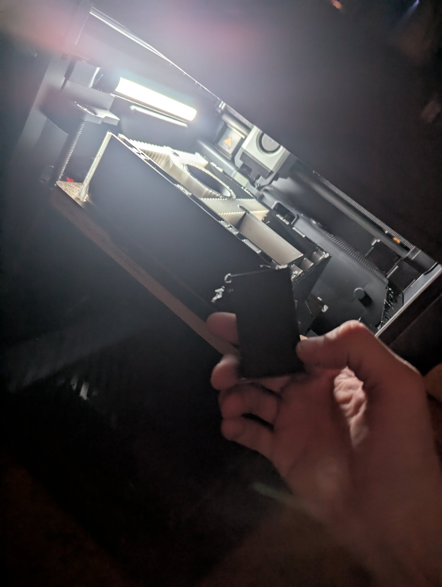

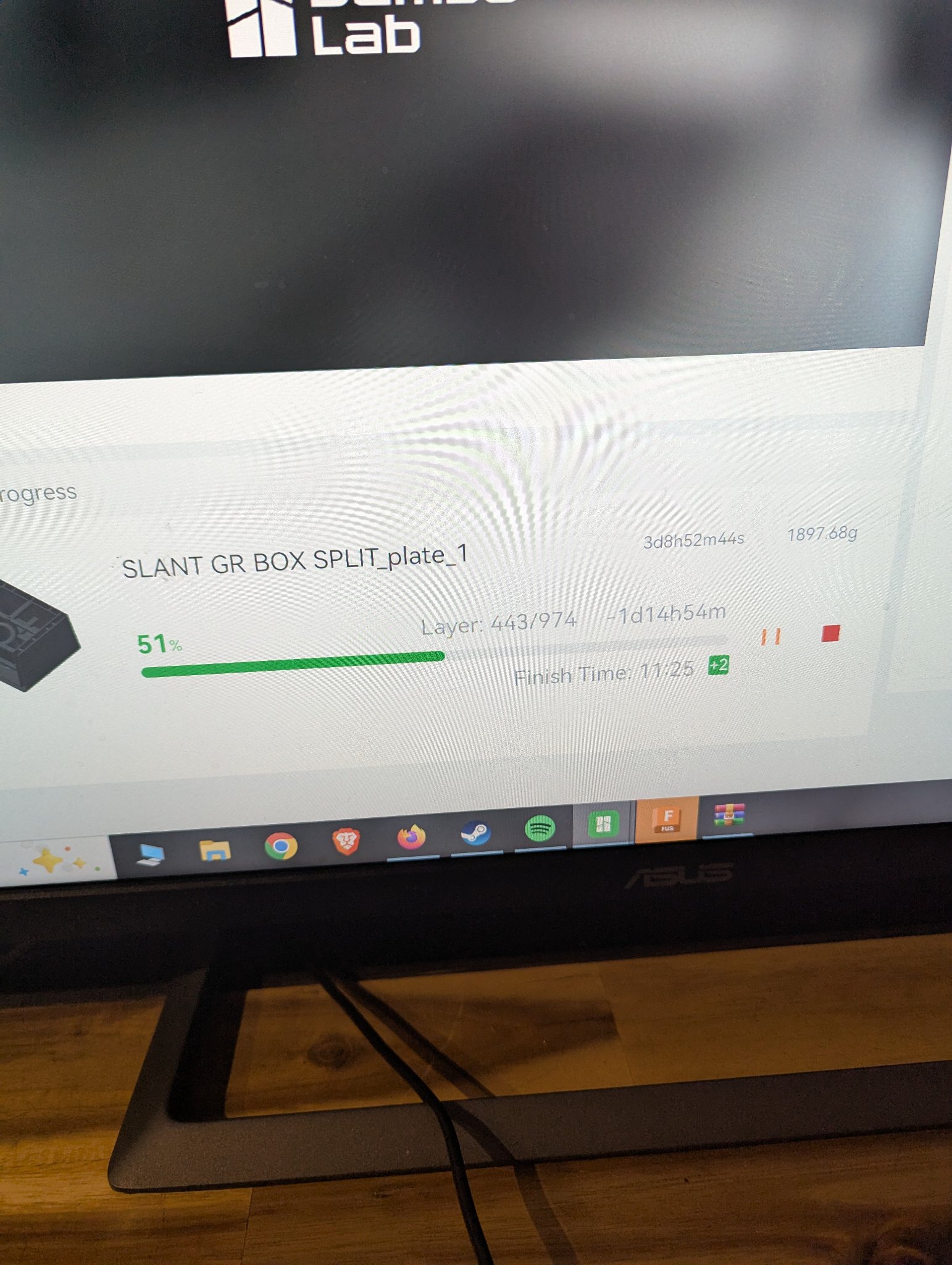

Progress has started on the 3D printed enclosure but things have not started off so well. The extruder knocked over the purged tower of filament used to clear the nozzle so it's simply dumping the excess filament into midair. The waste chute backed up inside the printer and is likely what started this whole mess.
I thought about aborting the print but since it was already almost 2 days in I just decided to let it go. When I get home tonight it will have either printed enough new material to recover or I'll be faced with a plastic spaghetti disaster. High amounts of filament changes really suck and seem to be causing more problems than I expected.

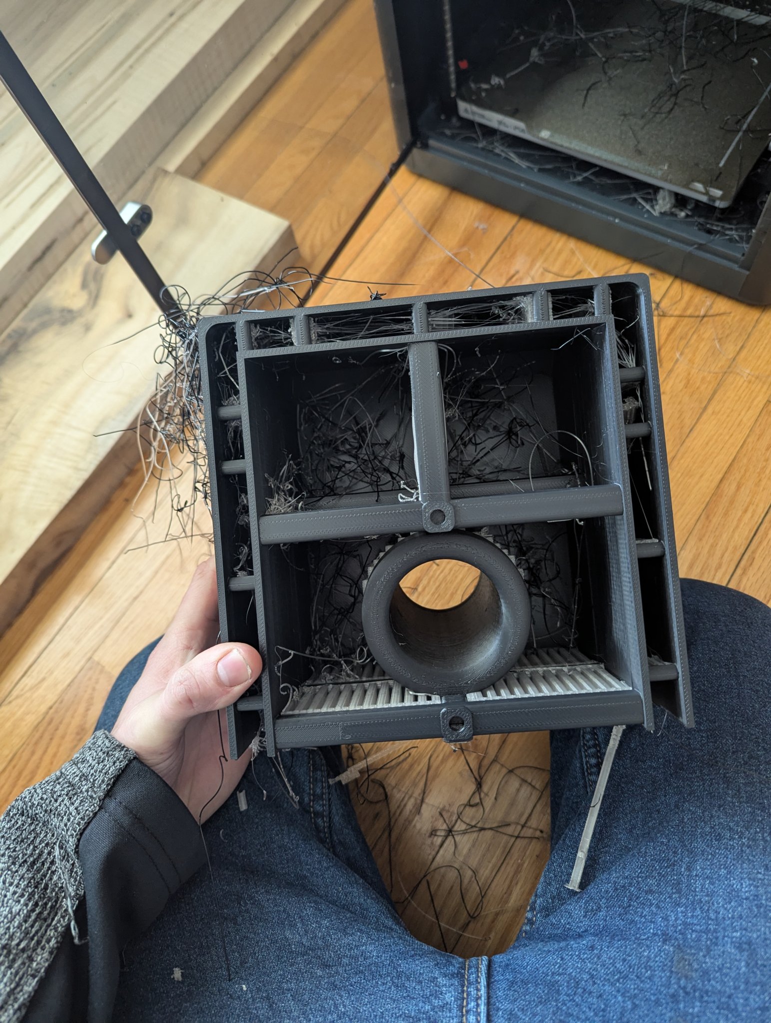

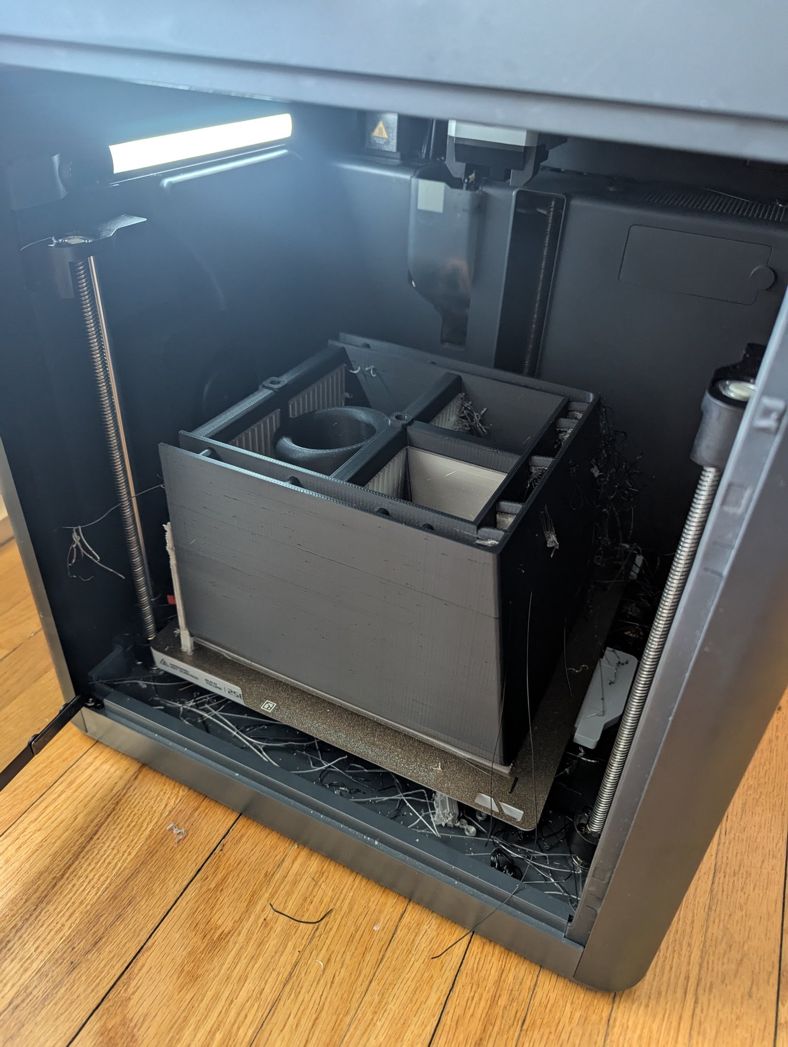

Well after a whole bunch of issues I did have a successful print, only 7 more pieces to go 😂.
Its pretty nasty at first glance but in reality it will work just fine after a little sanding. I made some changes that should hopefully help the rest print a bit better.

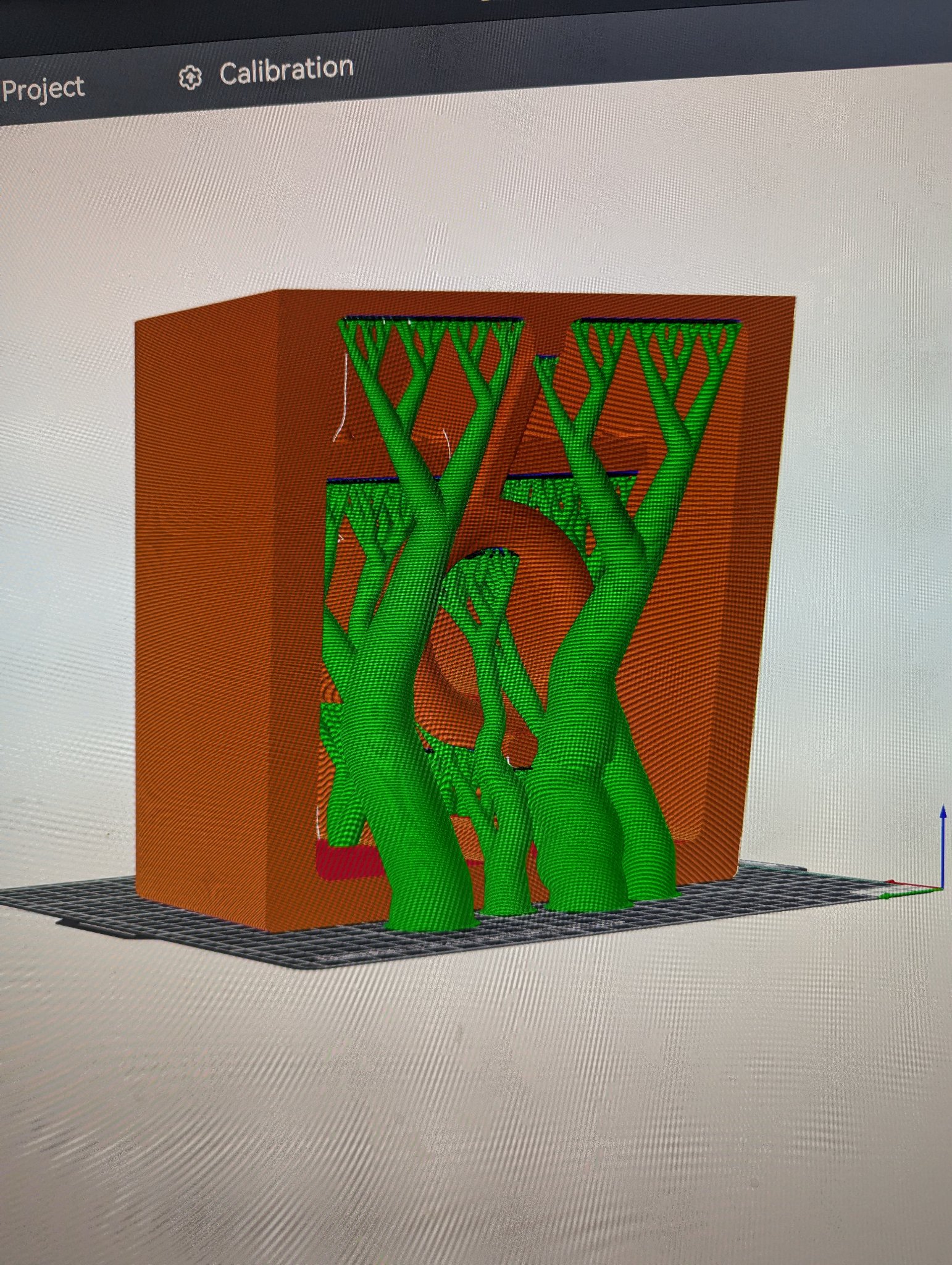

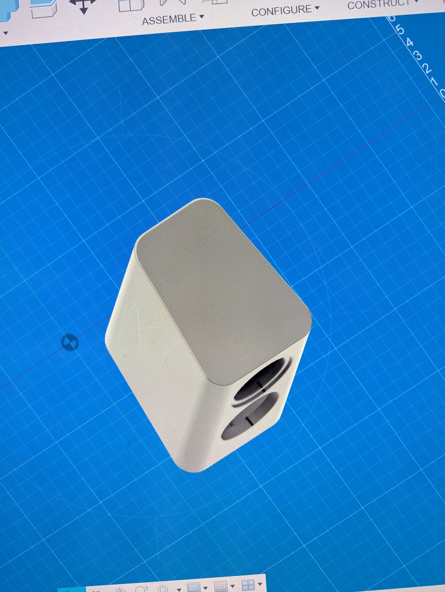

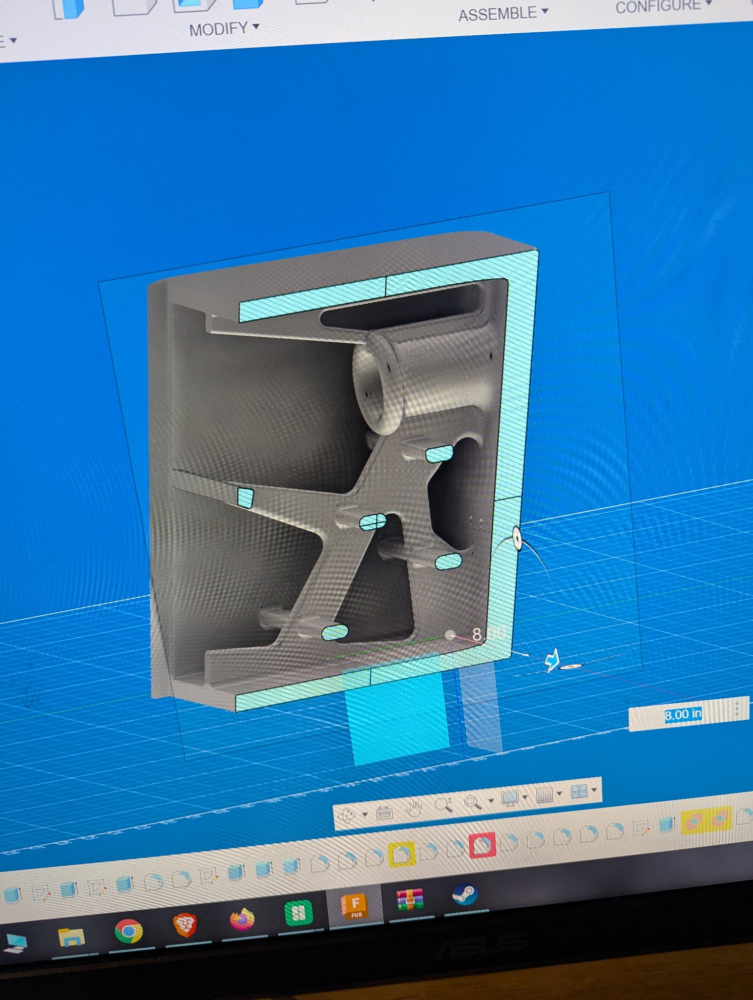

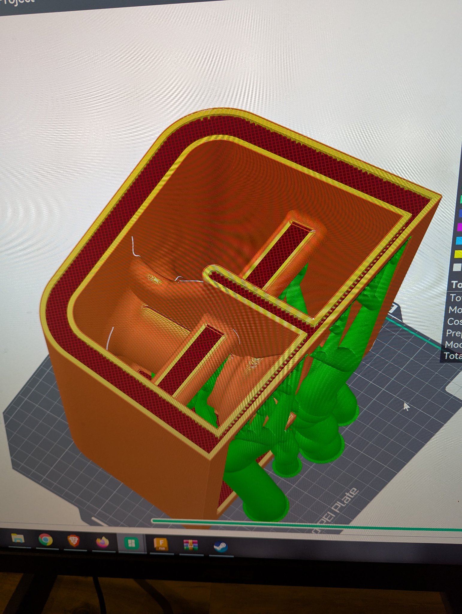

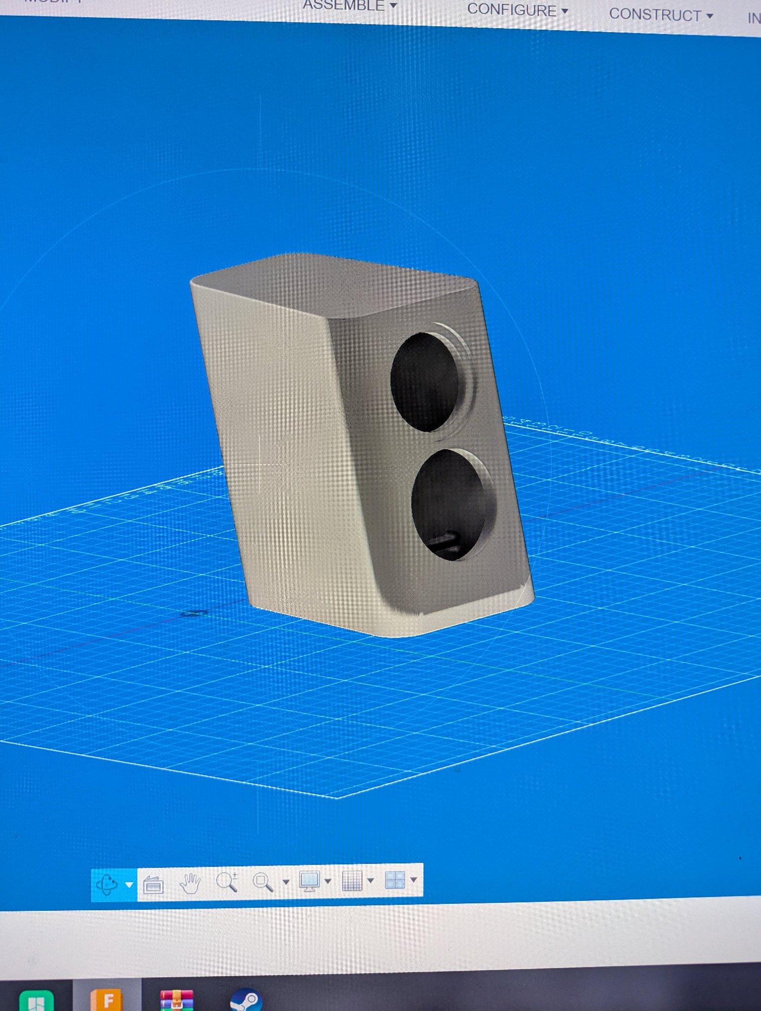

Unfortunately I have some delays because I need to re-do my model, printing the enclosure in these big blocks with massive amounts of support filament just isn't working. I've had multiple failures after the first piece barely got by. I'm going to remake the model with each wall as a separate piece and bond it together when finished.
Ok, so I sat down this afternoon and started a new design from scratch that will be easier to print. Unfortunately I could not get fusion 360 to cooperate in making the walls hollow so I'll just make them very dense instead and add some damping to the inside of the cabinet. I'm still fairly new to this 3D software and getting this drawing to where it is really tested my patience. When everything goes right in fusion it's great but if you try and do something the wrong way it can really be frustrating.
This will be split into 4 pieces and printed in PLA plastic, including the supports that will be printed in a tree design that's easier to remove. Not having to do filament changes this time around will save many hours. I'll have to start thinking about what I want to do for a crossover enclosure.
