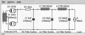

I just finished building one channel of my 300b amp. I switched it on I had my DVM monitoring the DC coming out of it. As the tube heated up, the DC increased and then after a few seconds more purple sparks then my DVM showed 0V due to the 6A fuse blowing ..
The DC on the cathode of the GZ34 reaches about 100V before this happens.
The amp has a 300b, SV83 pentode, and GZ34 rectifier.
I also have a 100K, 2W bleeder resistor.
GZ34 datasheet says max input cap is 60uF and I only have 5.6uF so it can't be that..
Any suggestions?
my PS schematic is shown below:

Well you're most certianly taking far too much current for an amp of this magnitude...
You've got the PSUD simulation all wrong.
I ran the PSUD simulation here and checked current on the transformer, you're drawing 5amps! all of the time!
Voltage across the current sink is 0.012v! this should be 375volts!
You should see 0.50 amps across those GZ34's at maximum especially in real life...
Okay heres your problem, take away L2 & C3.
Replace C2 with 100uF on the 1st choke and leave C1 as is..
Try it like that..
The problem is according to PSUD is that your final voltage comes out as 500+ volts whereas the original transformer voltage was only 375... which is expected.
Try drawing more current to get the voltage down or decrease your transformer ohmage so it supplies less current.

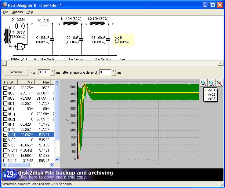

hi HeadSh0T, Layberinthius
i ran the simulation and PSUD did not complain. at the end of the simulation he's getting 450V with a hardly visible ripple (zoom on it).
i may be missing something too, and it is also my interest how the simulation went wrong.
cheers.

What the hell!
It was telling me that it was morbidly unsafe, now if I re-build the simulation it's perfectly fine!?
Okay here we go, try 50hz against 60hz...
With 60hz the simulation draws far too much current while under 50hz it runs 'fine'
That still doesn't produce the 0v supply I seen earlier tho.

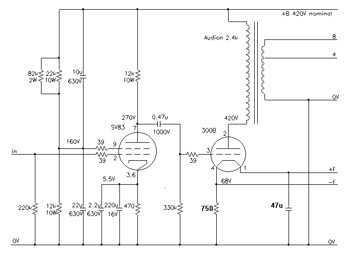

Ok i've been kind of busy but now, i've found that when I don't have the 300B plugged in, the voltage goes up pretty high (>420V) and there are no sparks in the gz34.. but when it's in, then as the voltage ramps up to about 70V only, then i get sparks and I have to shut the amp off..
:bawling:
I thought it might be too much current draw so i took out the SV83 tube and left the 300B in. Same thing happened...
I have a 750R resistor going to ground from the cathode..
BTW, I'm using thorsten's legacy 300b schematic. (amp part only)
I haven't measured the current draw yet. I'll do that when I get home. But I've tried another 300B and also another GZ34. Same problem occurs.
Another silly question, you haven't grounded the filament supply to the 300B?
The 300B heater supply is DC regulated by an LT1085. Does that mean I need to ground the centre tap of the transformer?
The last time I had a firework display like yours it was because the output valve had a grid to cathode short.
I measured no resistance between the grid and cathode pins. So i guess there isn't any short.??
This is my first amp, by the way. It's kind of discouraging... 🙁

I found the problem.. I had the LT1085 bolted to the case through and it was not properly insulated.. Somehow, the screw was touching the chassis which is also ground.
The voltage was able to climb as high as 250V until the sparks came again.. Then i tried another GZ34 and it worked fine!
Thanks all for your help!
