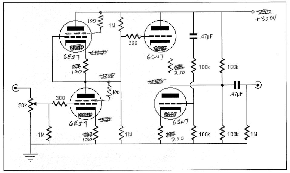

My most recent idea is the following, a 6EJ7/6SN7 Aikido, the idea being that it'll be relatively easy to implement since I think I can cram 2 of the small pentodes into the 1st tube position on one of the Group Buy octal PCB's, plus I already have these tubes. Gain is a little low, only about 30 by my calc, but will it have the oomph to drive these tubes?

You may want to put this in the Aikido thread where it will be seen and enjoyed. Nice idea well worth trying. I would love to try it but I don't have any 6EJ7's.
