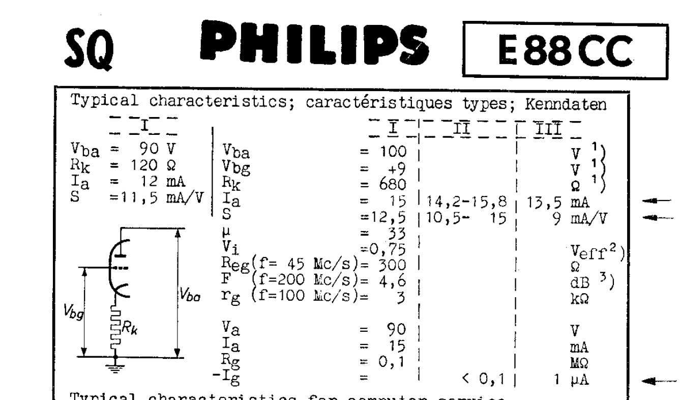

Unless your tracer has been calibrated exactly with that brand of tube and is running according to specs there is not much to deduct from those results.
Different brands will give different results for the same model number. When checking manufacturers' recommended operating points you might find total different values - e.g. the Mazad ECC83 has a total different optimal operating point from e.g. a Mullard or Philips.
So I would not worry too much, best place to check these in in circuit and if they work there then just enjoy.
Edit: I just checked and Philips states 12mA for 90V, not 15mA (that is for 100 V), the genuine (old) Telefunken datasheet says > 9mA at 90V. Always check the original datasheets, different manufacturers are not the same.... (which is why tube rolling is noticeable at times). According to my intepretation these fully meet Telefunken's spec's and are not below spec.
Unfortunately you are misreading the datasheets. Both Philips and Telefunken state the same. What you probably are missing is that while Uab is 100V, Ugb is 9V which means that grid is 9 volts positive. So measured at 0V at grid, plate is 90V. And both datasheets state that at that operating point less than 13,5mA Ia is end-of-life.
I'm not saying that these tubes are unusable. However these are long-life tubes (10000 hours expected) which would indicate that these have seen quite long time in operation to have reached end-of-life condition.

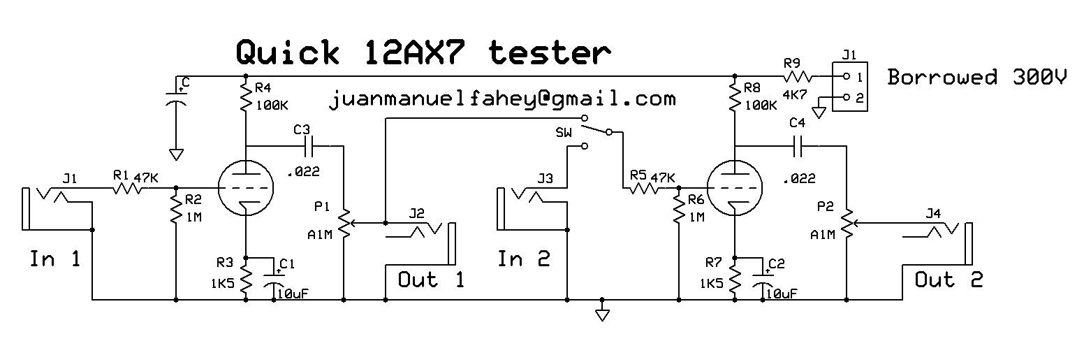

I suggest my own 12AX7 tester, with cathode and plate resistor values matching what ECC88 needs, typically suggested in the datasheet or worst case "borrowed" from a commercial amp schematic which uses them.
Just a small box with a Noval socket, a couple components as needed, in my case I used Guitar jacks because I make Guitar amps but you use what you prefer.
You can quickly and easily test, UNDER REAL CONDITIONS:
* that plate voltages under autobias conditions are roughly what expected or not.
* gain
* hum/noise
* even (uncalibrated but useful, specially if comparing many) microphonism, by plugging output into an amp+speaker and lightly tapping them with a metal rod or something.
* as shown circuit allows cascading both stages, simulating a high gain guitar preamp.
* you do not need to build a dedicated supply for it, 4 crocodile clips allow you to "borrow" Ground, Filaments and +B from any other amplifier you have on or near your bench.
* lots of these have been built by fellow Guitar Amp Techs, who love its simplicity and straightforwardness.
* gain
* hum/noise
Best wishes for 2021, Juan Manuel! The idea of using crocodile clips for 300V DC is a habit better not made popular 🙂
OP has uTracer. You are not seriously suggesting that your tester would be more appropriate?
