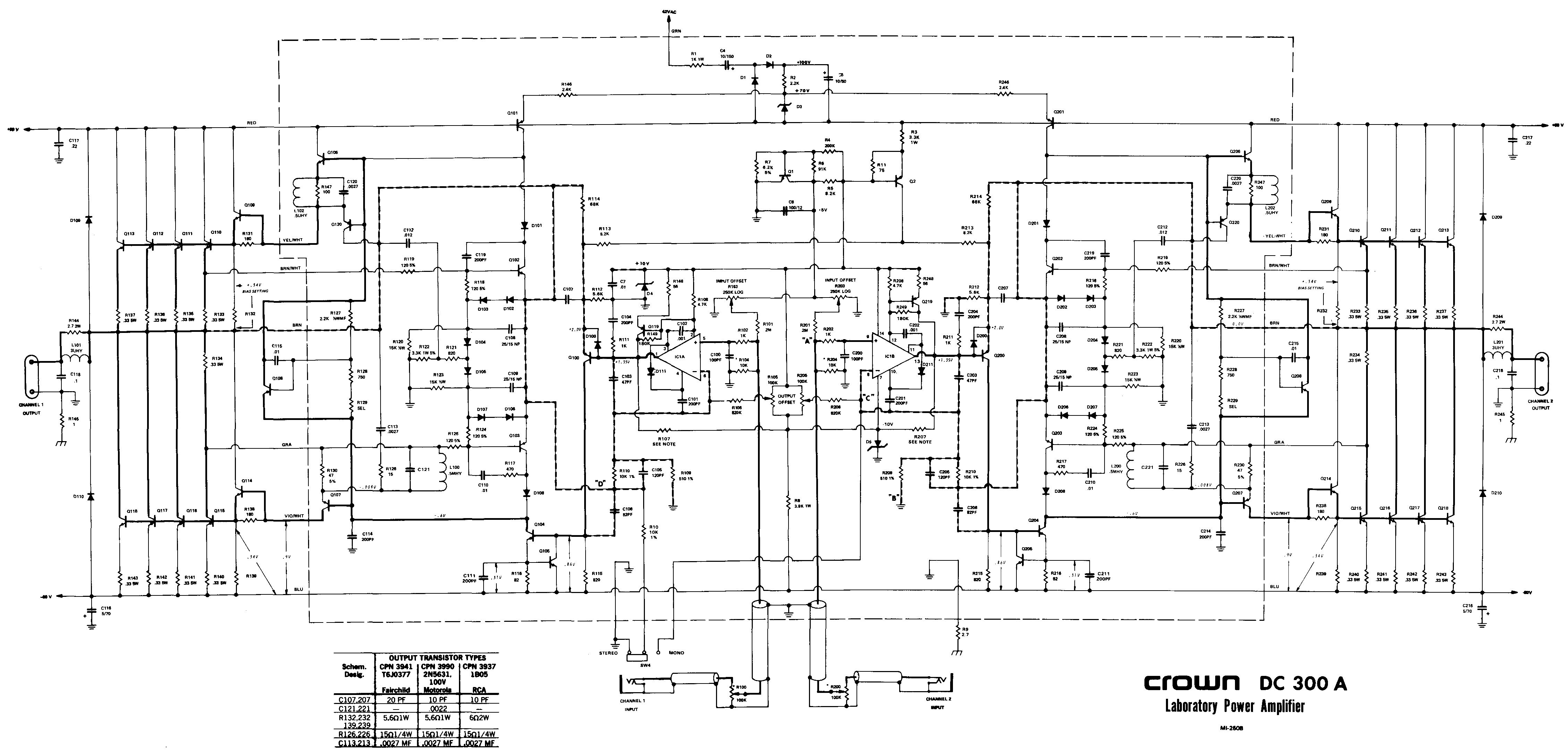

Google has failed me - Crown DC-300A schematic?
I've got the grainy scan of a third generation photocopy of the original service manual that Harman/Crown put online. It has part locations superimposed over a grainy picture of the board artwork but not a proper schematic.
I've got the much better scan of the Series II service manual with its decent schematics, but my DC-300A is not a Series II.
Since google doesn't really do real verbatim searches anymore, it just keeps leading me to the same PDFs in different places.
I've read through the threads here about this amp, and i think I've seen references to the existence of a good clean schematic file somewhere?
Anyone?

Here's another source for a schematic.
http://www.radiomuseum.org/r/intern_rec_dc_300a.html

The one from eserviceinfo is a bit cleaner and contains most of the schematic (a bit is lost between pages there).
Based on the thumbnails at radiomuseum they have the same version as eserviceinfo.
I guess i can extract the images and see if any whole components or information are missing when i fit them together in an image editing tool

Alright, here's what i was able to splice together in the gimp.
I'll probably spend some time cleaning it up. Maybe.
I'm mostly curious what the differences are between the 300A, the early 300A II, and the late 300A II.

Go right to Crown under their discontinued amps, all of their service lit is there for download. All of the DC300s are there. The IIs got rid of that dreaded Ua739/749 opamp for starters.
Craig
The file that Crown (now Harman (now Samsung)) supplies lacks the schematic. See comments above.
The II adds the clipping/DC detection, but through serial number 81323 it still has the UA739.
S/N 81324-up switched to the LF357.
Since the LF357 is internally compensated, maybe the late version is easier to upgrade to a modern part.
I'm not an EE, but my reading of the original schematic suggests that the "lag" or compensation networks on the UA739 are only connected to power and ground aside from the chip itself, so it's possible that i could make an adapter that would let me use a modern dual opamp, and just not connect those pins, but I imagine that other changes to the preamp & drive circuit may need to be altered to retain stability.
A few websites sell little modules to replace some DIP-14 opamps (including the UA739) with an ne5532, but I'm not paying $35 for a $1 chip on a board.
