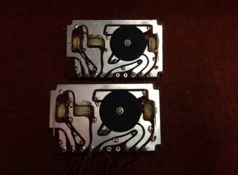

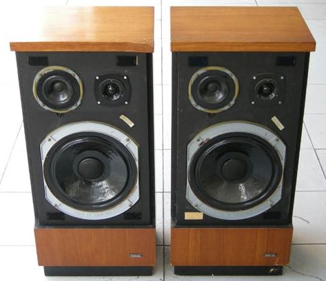

I have a pair of vintage goodmans goodwood speakers that i have restored. i has the crossovers recapped with new caps of equal values, middle range quality. these are the speakers

i am disappointed that both the midrange units and tweeter units (more the midrange) sound rough and hard on the ears. I am a bit of a newbie, but have bought and sold and fiddled with quite a few speakers over the last couple of years and im very disappointed with how these sound. I dont know whether its the crossover or the units themselves. Can you advise me at all, as i am considering 4" audax mids , and audax tweeters as replacement units. Would the voice coils be 'gone' in the goodmans units, or could it be the coils on the crossovers themselves. I am at a bit of a loss ):

How is the suspension on the middriver. If it is really stiff the surround may have dried and become so hard that the cone is not working properly.

Hi many thanks for quick reply. All the surrounds on these are the pvc variety and seem to all be moving ok I think . There's no perishing of any kind

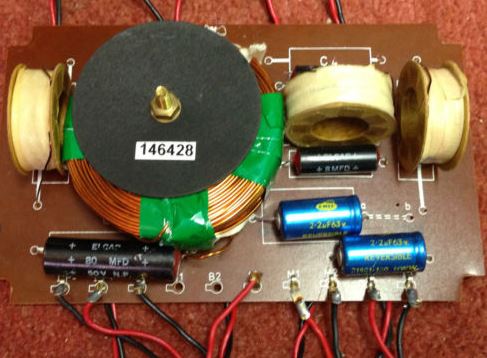

also the replacement caps were mostly 'cross-caps' , the polypropylene type. the originals were electrolytic.

Looks like a good crossover. 2nd order bass coil and 80uF cap, 4 element mid around 500Hz with 30uF and 8uF, and maybe third order tweeter cap/coil/cap.

Changing the capacitors will have brightened the sound, maybe too much. Your main option is to add some resistance to take things down a bit as Cal says.

I didn't spend too much time on simulating it, but I don't think the capacitor change from NP types to MKP could have done a lot to possibly wreck things. We're looking at 0.5 to 1 ohm ESR change. Not much.
Big old heavy 12" woofers often sag and rub voicecoils with time. That sounds rough. Traditionally you rotate them 90 degrees for a quick fix, but maybe 180 degrees is doable here.
You might reflow some solder contacts in case there is a break somewhere. It's very easy to just put your hand over a tweeter or mid and listen to the other drivers on their own too. Usually tweeters fry first at parties and actually are easy enough to replace with something similar. Perhaps the voicecoils have turned into a bird's nest.
