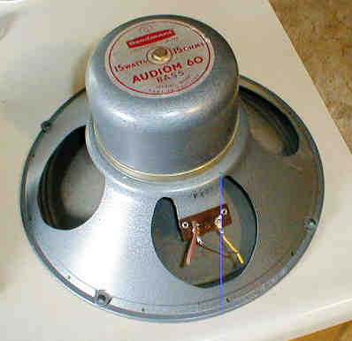

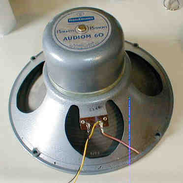

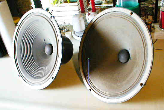

I have a pair of 15 ohm Audiom 60's that I saved from a organ console that had been left at the local landfill site. When I pulled the back off that organ and saw two of these I almost jumped up and down with glee. Open air tests (no baffle) in my living room reveal these to be extremely smooth, extended sounding drivers good out to 5K or more. with very high efficiency. One has a blue label identifying it as a Audiom 60, the other has a red label, also I.D'ing it as an Audiom 60 but with the added word BASS. The drivers look otherwise absolutely identical except one has a ribbed cone, the other plain. I cannot hear any sound difference in the full range out of bafle test. Both go up equally high and smooth. There are no cone rubs or buzzes, these are mint except for minor water stains (but no damage) on one cone. I suspect these would be awesome in a flea power SET amp configuration with my high efficiency >100dB, 5" Fountek ribbon tweeters.
I would like to build an enclosure for these that would really allow them to sing with high efficiency. I was thinking of trying them in my large 50 Hz front horn cabinets as a starter. Would something like a Jensen Imperial horn or what was that ultimate cabinet for the Tannoys, the Westminister(?) be the hot ticket?
Ouroboros, do you have any detailed info on my drivers that you could scan and email to me please?
I wanted to add to my first post above but ran out of editing time.
Open air tests (no baffle) in my living room reveal these Audiom 60's, to be extremely smooth, very extended sounding drivers good out to 5K or more, with very high efficiency. Of special note there was no beaming issue, nor hint of low frequency doppler modulation of the highs. I repeated this test for Morgan Jones wanting to get his highly experienced opinion when he was paying me a visit last year and he agreed with my own conclusions.
