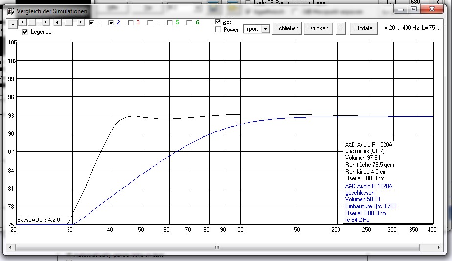

See, again. That is simply wrong. The room gain applies to one speaker the same as for two. You don't know about logarithm, do you? +6dB is the same gain, no matter how many speakers you use. And no, a low or high Qts is neither good nor bad, that ONLY comes into play in conjunction with the enclosure! And a low Qts driver is preferred in BR, BP, horn while it's mostly useless in a sealed enclosure or TML etc. Take your preferred simulation program and try the latter enclosure types with a low Qts driver and you'll see they don't work. The QTS alone does not say anything about the response in the bass unless you put it in an enclosure of any type. It is only one (of several) specs which qualifies it best for enclosure type x or y. And even with high Qts drivers you can achieve good bassreflex results.

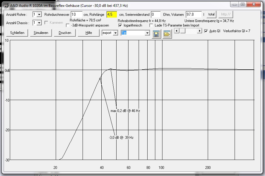

This is a 10" driver:
fs: 68.4 Hz
Qms: 3.93
Qts: 0.62
Vas: 25.7 Liter
So that's a high Qts. And it works fairly well in BR:

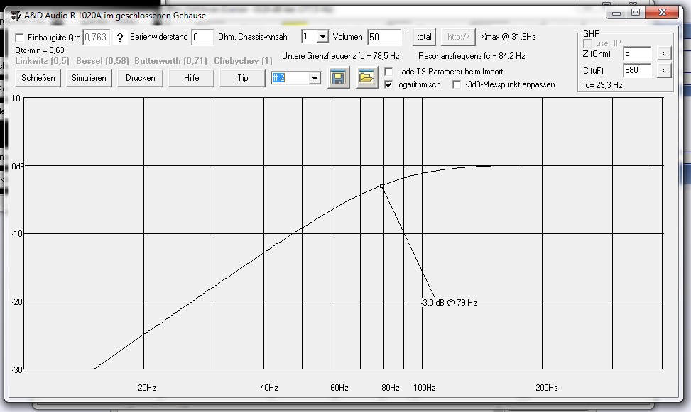

You don't believe me? So you don't like it that deep, you want to put the speakers near the wall or even corner? Or want a cleaner, leaner bass? NP, use a sealed enclosure:
Do you see now that the Qts does not say much unless you put it in an enclosure? And that the enclosure type changes the outcome vastly? Here the comparison:
