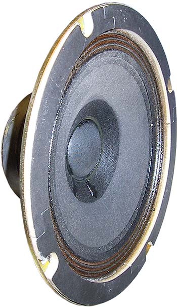

So it seems they may be good candidates for open baffles. If this cleans up the midrange, IMO, it will be worth it. Planet10 knows this subject well. I can understand if your focus is on the bass and this will need addressing of it's own, naturally.
