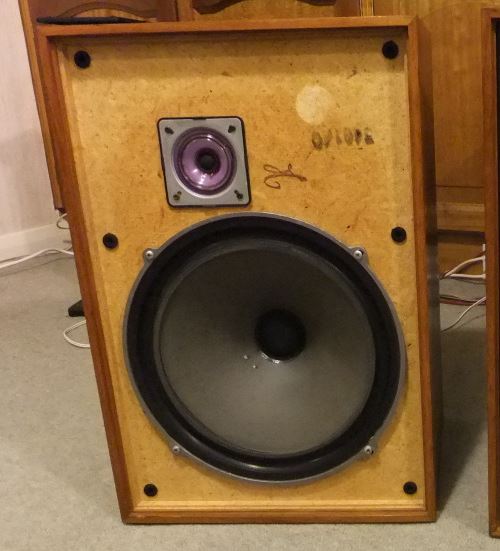

Thanks for the info angi and system7 thanks for your input the speaker on the left is the speakers i have now could i replace the tweeters and crossover to make a change for the better ???? on these .
There's not so much to be gained, swapping parts. Unless the tweeter capacitor has failed, I would prefer to save funds for a 'younger' speaker with newer drivers.

Yup, I think you may be able to improve your speaker. 🙂Thanks for the info angi and system7 thanks for your input the speaker on the left is the speakers i have now could i replace the tweeters and crossover to make a change for the better ???? on these .

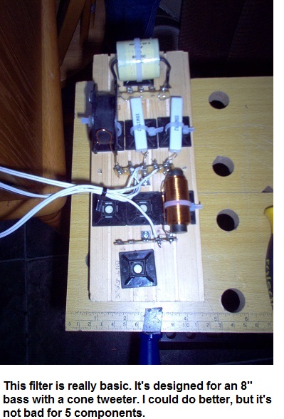

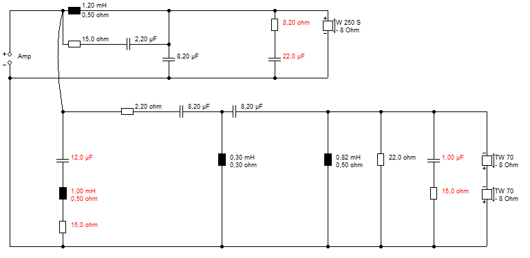

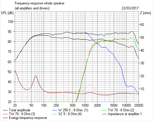

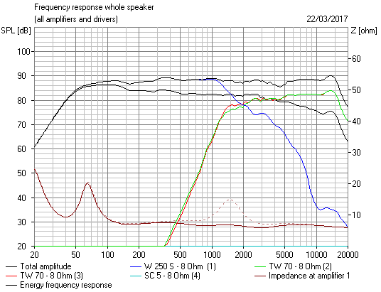

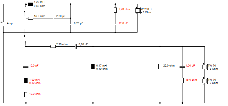

I said earlier that the weak component in the 10" bass idea is the 2" tweeter crossed low at about 2.5kHz. It struggles to keep up. So one idea is to double up the tweeters. Gives them an easier ride.
I'd align them vertically, which works better IMO. So, overall, keep the bass if it is OK. But work on the tweeters and crossover. And I have done a certain amount of Impedance Equalisation here. BTW, 10" bass benefits from a 2.5kHz notch, which I have done below. 2nd order and fourth order both work. Your choice.

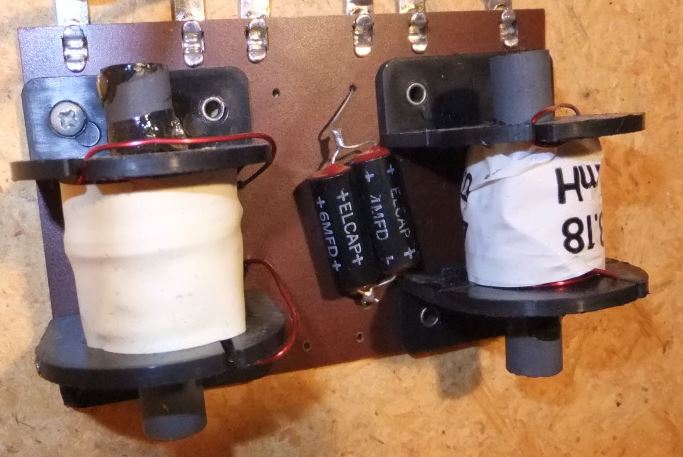

My friend, the results you obtain depend entirely on your level of commitment and enthusiasm. Have you even examined the crossover? Unscrew the bass and look.

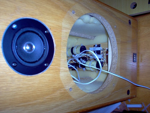

Probably there's a 3.9 uF capacitor in line with the 4 Ω tweeter.Have you even examined the crossover? Unscrew the bass and look.
Thanks guys i took the woofer out and here is what was there not a whole lot a small resistor and capacitor with what appears to be a fuse . Thanks system7 great read on the speakers .
